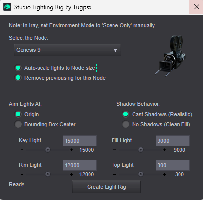

  • TugpsxTugpsx Posts: 852
    edited March 22
    Actually I do have another project that creates a light rig for a selected character. I made it for a car render animation i was working on. It is not completed and the HDRI section is not showing in this version.
    That part was a bit more involved, whereas to find the brightest spot in any given HDRI and add a ghostlight as your source.
    Changing the environment light meant that the system had to analyze the new light for the correct relocation of the source light.
    This one is geared to showrooms so it was easier to move forward. It also creats a director camera where the lights are linked.
    Key Light, Rim Light, Fill Light Top wash light are all created in a single click.
