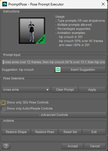

    Interesting, I have had a few projects on the back burner including a Pose Executor that uses phrases to pose characters in a scene even for animation.

  • sidcarton1587sidcarton1587 Posts: 117
    So did this incorporate an LLM or straight up NLP or something else? Honestly I've left posing as a special case that requires very specific attention. One of the hardest things to get right.
  • cain-xcain-x Posts: 215
    Very interested in this PromptPose tool - does it work with non-Genesis characters or can it at least work with any character with the properly named bones your tool expects?

  • TugpsxTugpsx Posts: 918
    This currently works with any character in your library. The beta focus is Daz G1-G9 characters since most users have a ton of them along with their poses.
    You can even ask for a supported character by name and Gx (the selected figure) will morph into a supported character. This can happen on frame 0 or over time if you want transformation. By specifying for example "Bishop over 30 frames" for a transformation from G9 to Bishop the G9 character will morph into Bishop. You can concat the request to then have Bishop transform to Desmond over 30 more frames with a gap of holding bishop for x amount of frames. G9 -> Bishop, wait x time -> Desmond.
    There is a playback option to review your transformation so you can adjust it at any given time. Stop a transform in the middle and ask for different character target and it will do so.
