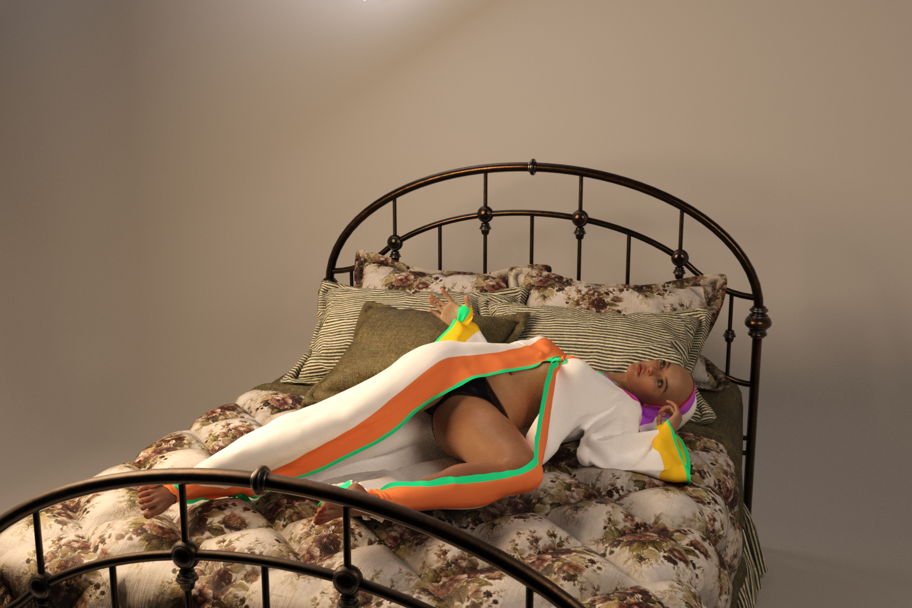

  • felisfelis Posts: 6,274
    edited February 3
    I have the robe.
    Tried it on a G8F character. It didn't misbehave like on yours, but I would say it is a simulation that has some artifacts.
    1800 x 1200 - 3M
    Post edited by felis on
    The above image was with 60 frames total and the pose at frame 40. Subframes and iterations were default.
    Have you tried with another character just to check it isn't that specific character?
