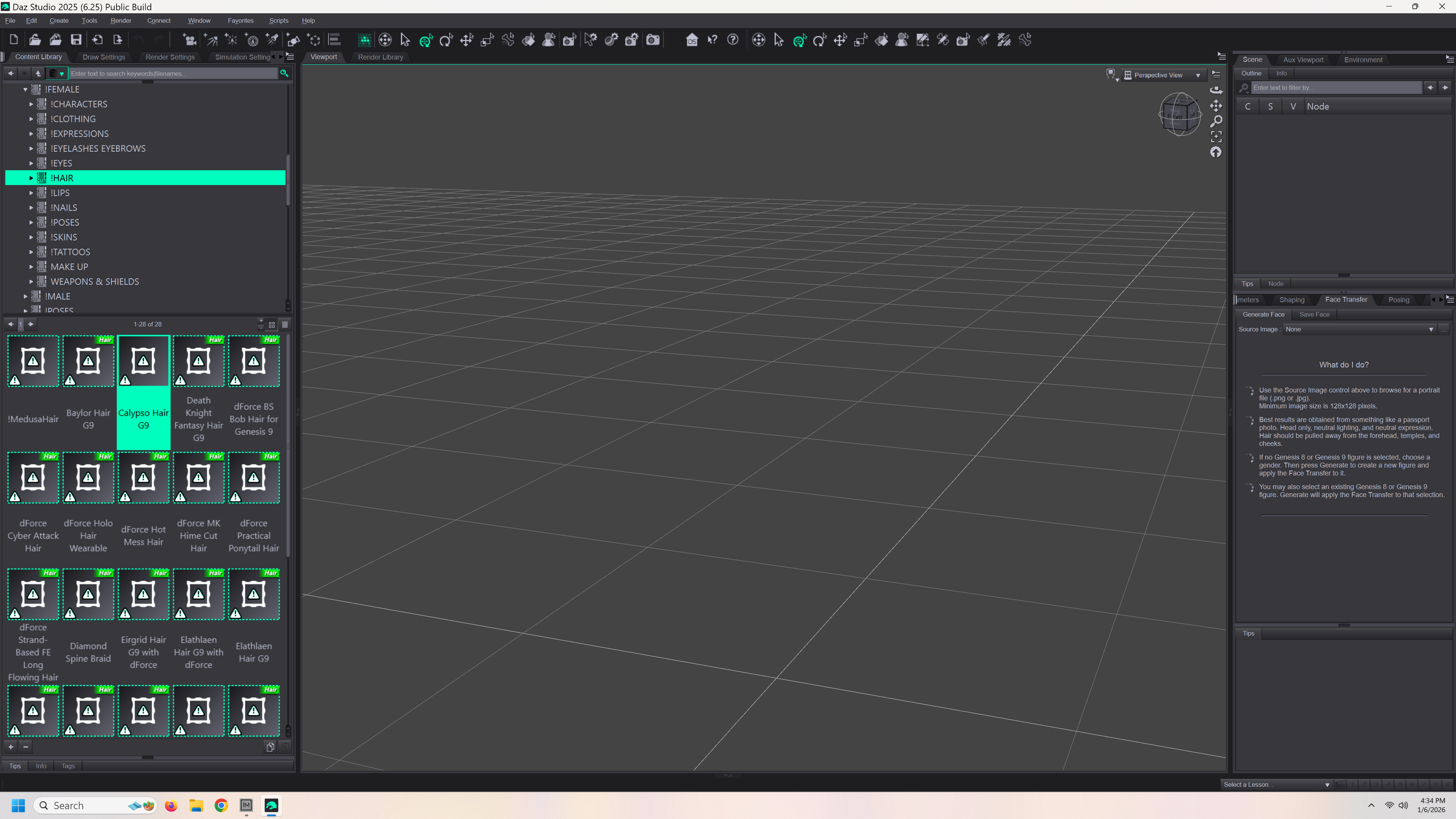

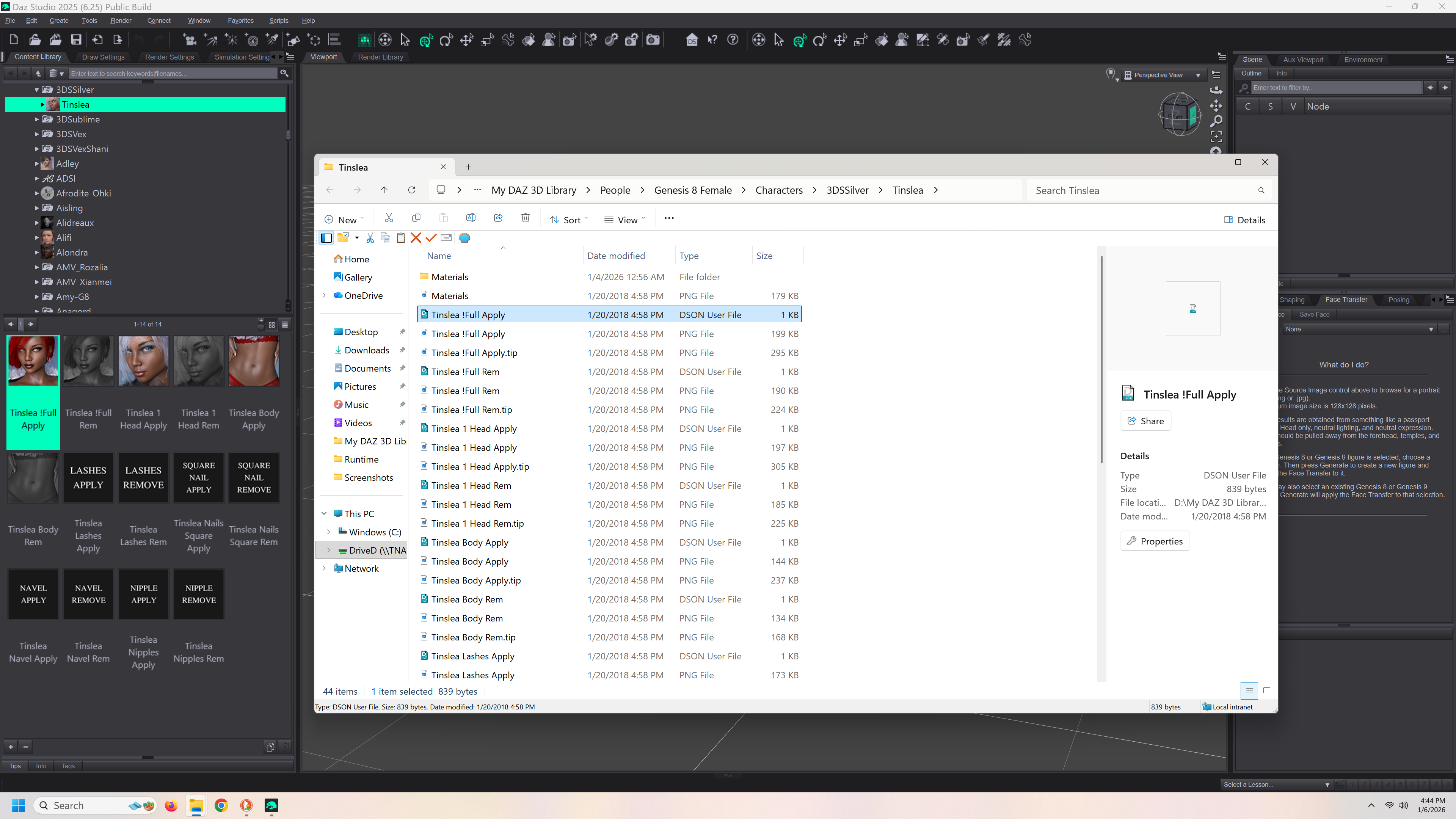

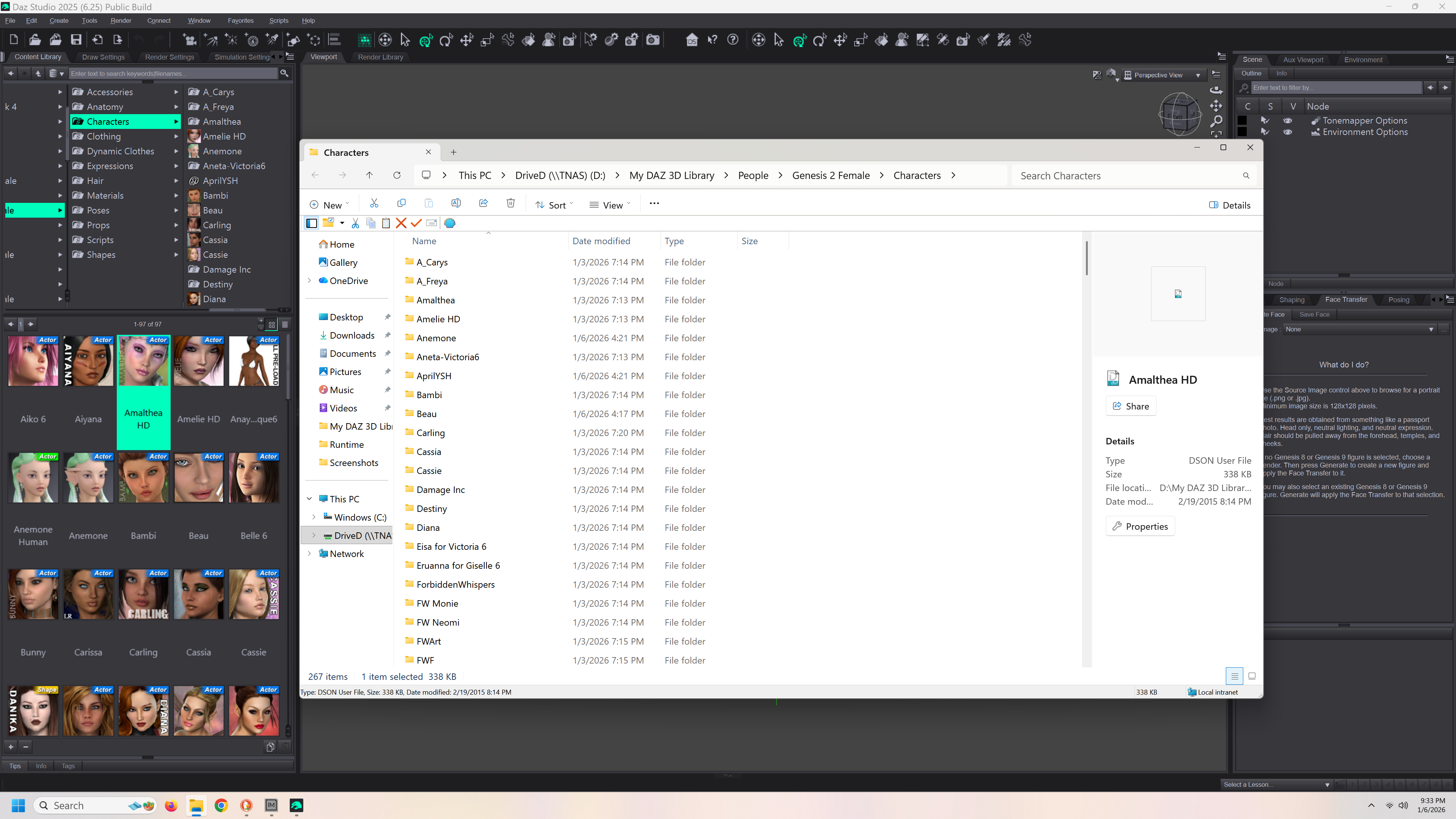

Okay, I got everything loaded, remapped the DIM directories and remapped inside of studio (content database management) EXACTLY the same on as on the old system.  It actally shows all of my assets in studio and shows my custom categories but when i click on something it says it can't find the files.  even though, if I click on go to file directory, it goes to the right place.

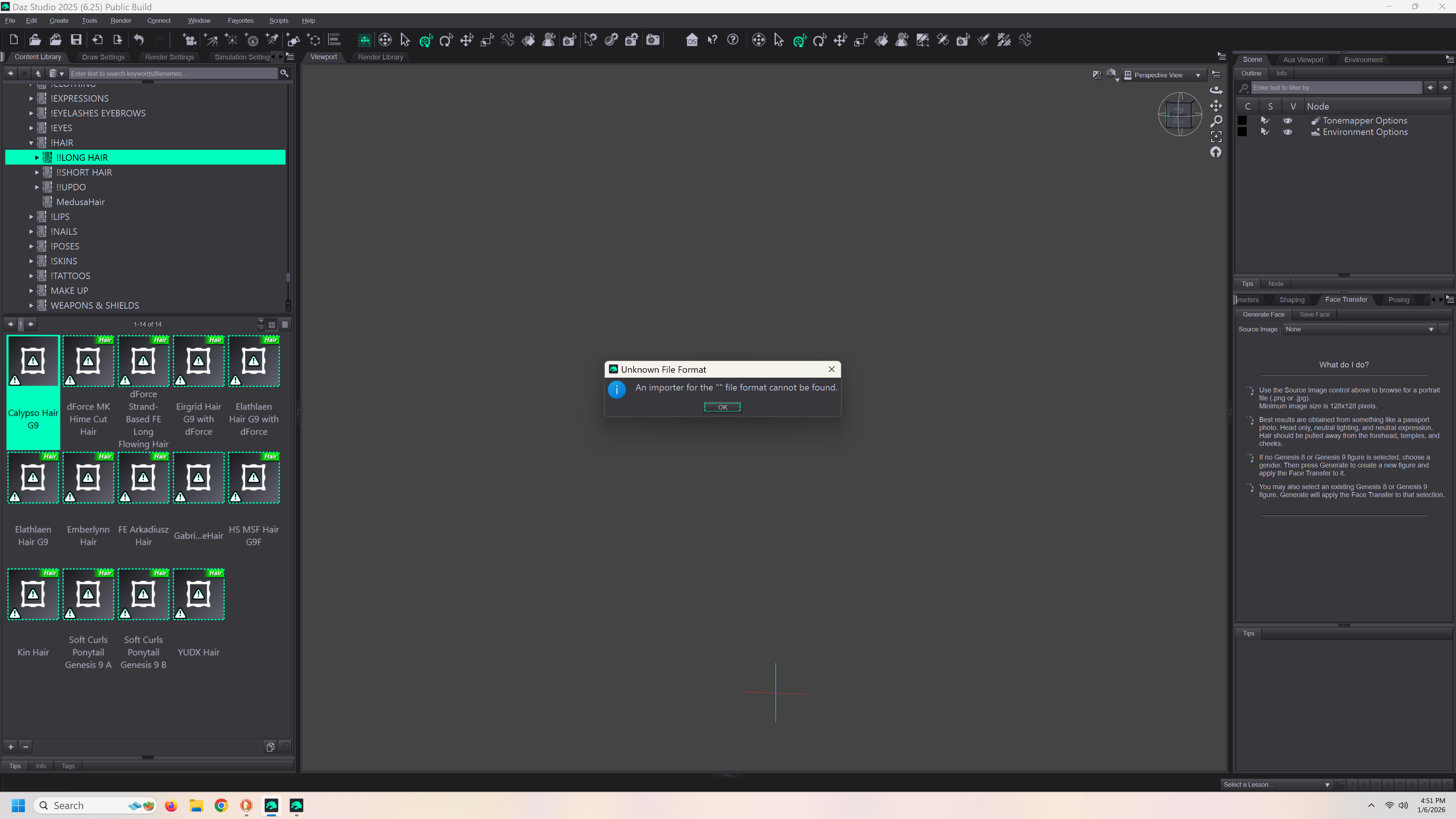

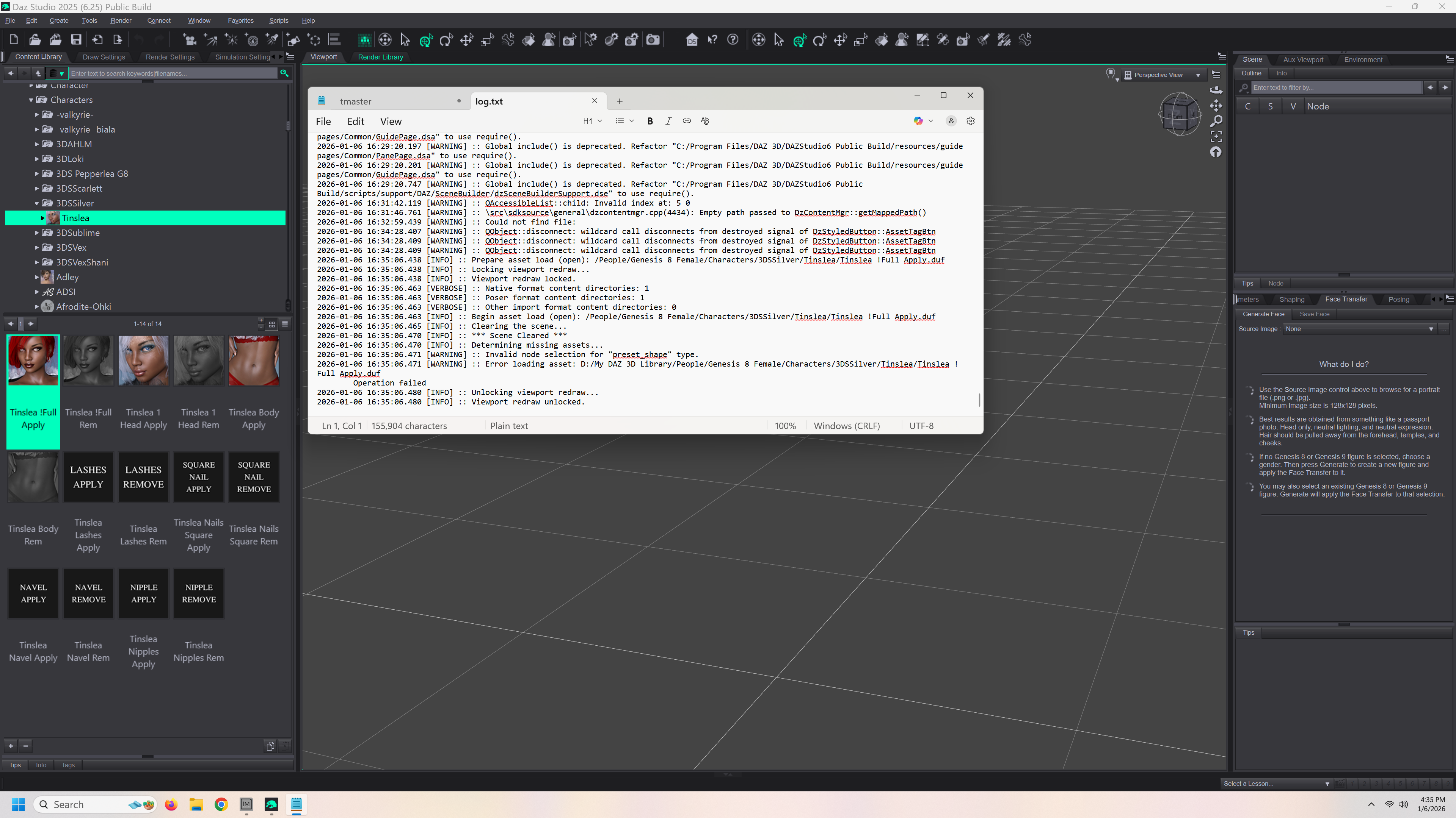

    The log shows you are trying to load a preset without a figure for it to apply to in the scene and selected. The content pane shows a lot of user categories (ostensibly) without references - if you are having trouble the first plae to lok for content is in the Content Library under Daz Studio Formats, rather than in a view that is built from the CMS database.

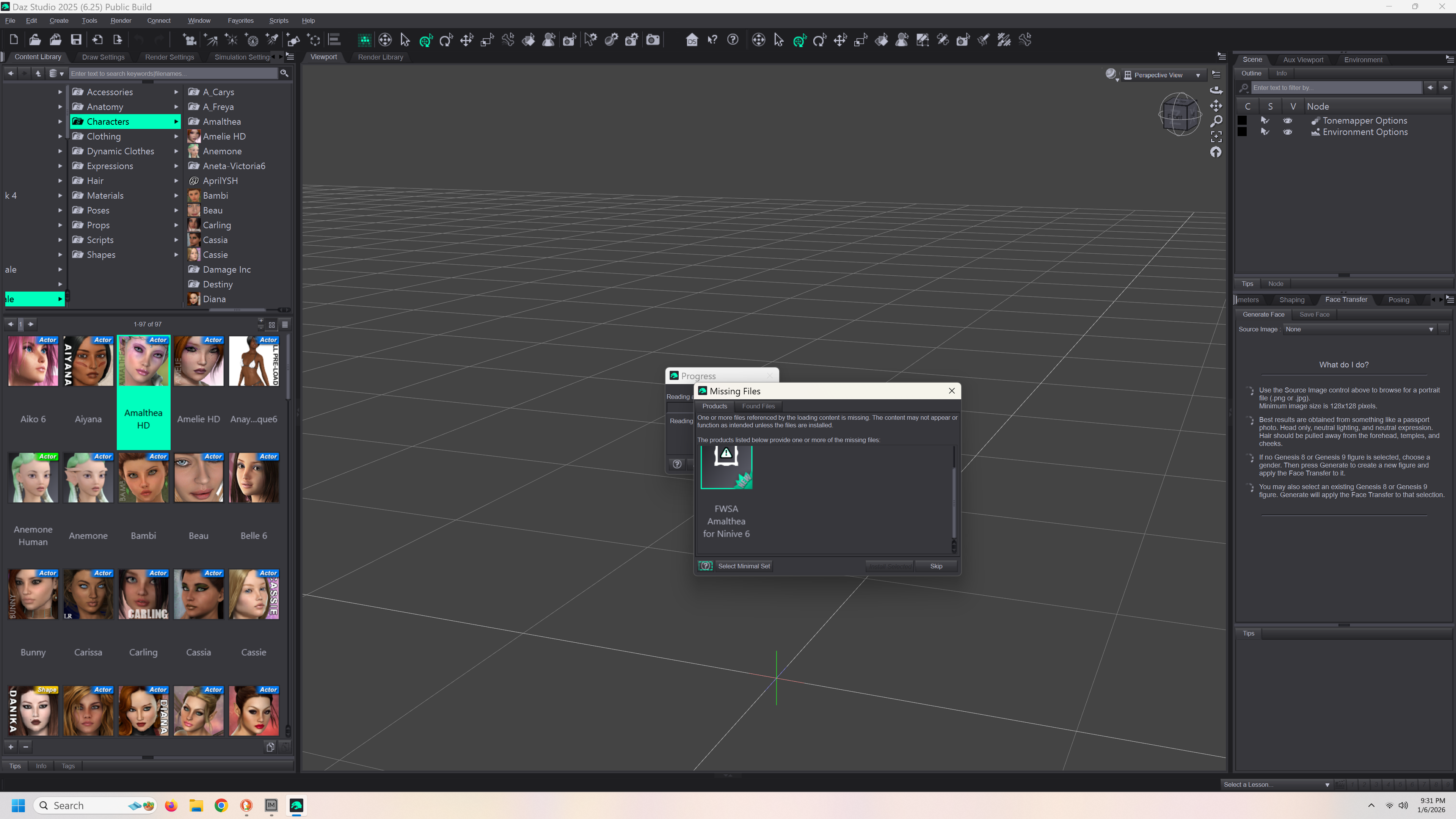

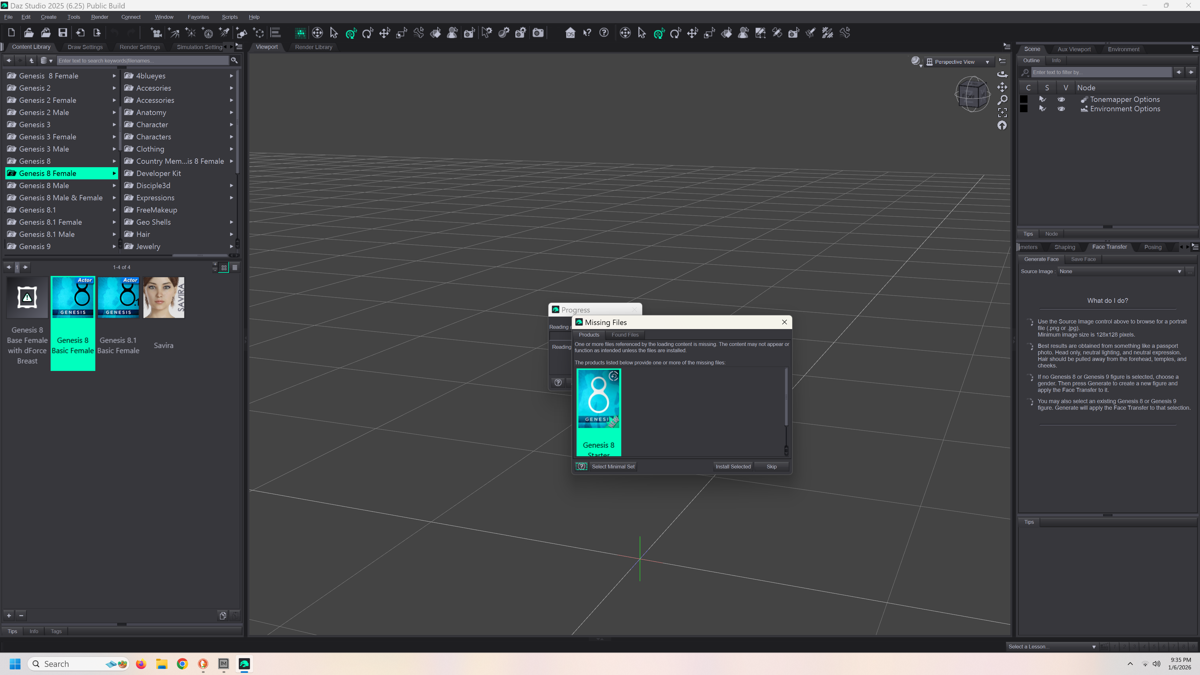

    so when I go to load a regular figure, it says its missing the files and invites me to download the correct files.  However, when I right click on the figure and go to navigate to file location, it goes to the file location.  DIM and the content database manager are set up exactly the same as it was on my old system, which still works perfectly.  I don't understand what I am doing wrong.  My content 100% will not fit on my c drive, I have to figure out what I am doing wrong.  I'm really not trying to be a pain. Ive been working on this for 4 days now (it takes a long time to move all that content from one drive to another) and I don't know if I want to run screaming or just have a really good cry.   And I am prone to neither lol.

    Okay, when I hook up my old external drive to the new system it works perfecty.  Everything is exactly where its supposed to be.  I've copied those files exactly to the new network drive.  It will NOT find the files.  I am at a total loss.  If it won't hook up right then I have a very expensive back up drive that I can't actually use with Daz Studio and will have to continue to use the external drive.

  • Richard HaseltineRichard Haseltine Posts: 111,852

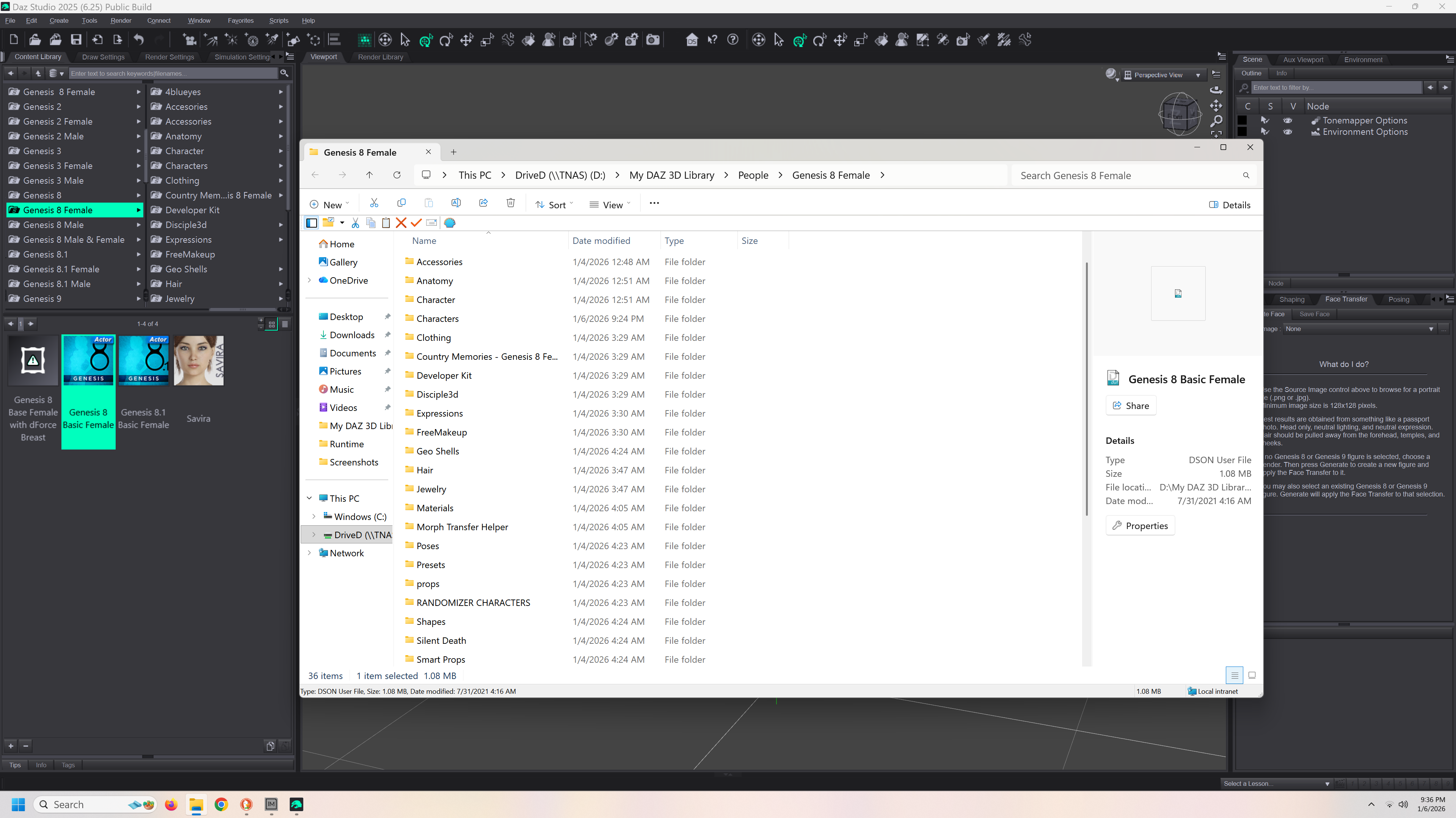

    Is the drive a local drive or a netweork drive - the path given in the explorer window is confusing.
    If you right-click on the product thumbnail (e.g. Genesis 8 Starter Essentials) in DS does it have an Uninstall otpion? Thay would indicate that the databse shows a connect install, which wil take priority, but you are showing the files from a DIM/maunal install.

    Its a network drive. The name is just so I knew exactly where i put it.  I will have to check the thumbnail when my render finishes and I have time to reroute everything again as currently I have it hooked up to the external drive I was using with my laptop.

    Is it mapped to a local drive (the D: in the name)? If not you will need to do that as DS doesn't handle network paths.

    The one that works is a local drive.  The D drive is the network drive.  What parts need to be pointed to the local drive?  I can put the manifest files and the appdata files onto the c drive if I need to. Daz studio and DIM are on the C drive.  I just don't have room on the C drive for all of the content.
    So the network drive is already mapped.  But, I went ahead and mapped it again, still doesn't work.  It literally shows everything in the library but won't link to the actual files.  I'm going to try creating a symbolic link, which seems to be the next step.
