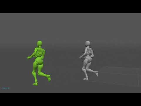

  • ImagoImago Posts: 5,697
    Wolf, I used Cascadeur for the running man clip. surprise
    I imported the model, rigged it with the inner system, imported a run sequence I made from DAZ Studio (I work faster in there) and lastly corrected the keyframes in Cascadeur. That "pull this, move that without consent" is quite painful IMHO.
    Then I activated the Physics, the secondary motion and also activated the "Lock to physics" thing on the top. I used the "Bezier Viscous" tweener (Why that trap is defaulted to Constant?). Physics corrector and Compensation motion were On too. The software took a few seconds to calculate all the stuff. Not sure if the "Spring Secondary Motion" did anything, I didn't see any change in the dots. Same for the "AM Smoothness" or what is called.
    The green ghost followed my model merrily and its line wobbled happily when it calculated each change. As I can see, it indicates how this "secondary motion" changes the values of the bone's rotations.
    The animation preview in Cascadeur looked fine so I simply exported to FBX the finished motion, loaded it to my model in DAZ Studio and rendered the videoclip that I posted.
    Then you said it wasn't good, I should use Cascadeur... I really don't understand.

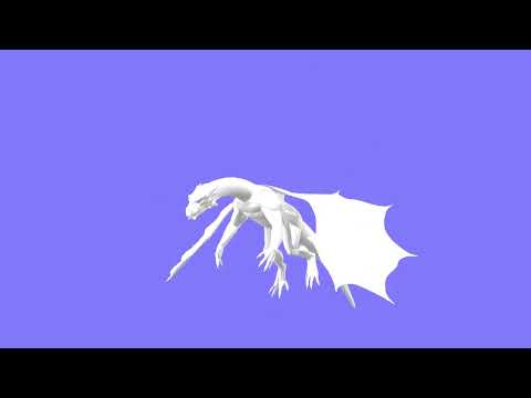

    I saw the dragon in one of your clips on your website, I think I recognized a BVH I saw in ShareCG or Rosity Freebie section some time ago, here is a short one made by me some time ago:
    That kind of motions aren't hard to make, even without advanced tools, for this I didn't even used the Spring script or the Delayed motion one. Just a touch here and there and it's ready, you don't need to fully rely on ready stuff.

  • wolf359wolf359 Posts: 3,951
    edited August 2025
    A jogging motion only needs very slight secondary physics From the above description it seem you “used” cascadeur but with utterly  incorrect settings which is why your animation had ZERO secondary physics.
    This is the proper process explained well in the video below.. please watch and learn
    Post edited by wolf359 on
    edited August 2025
    What could I made utterly wrong if I followed the tutorials from the Cascadeur channel on youtube?
    They say: Import your model, rig it, disable the "autopose" if you don't want them, pose your char, set the tweener, activate the Autophisics, Secondary motion and set the values. Isn't the right procedure? Did I missed something?
    I can even see the "center of mass" green arrow go up and down indicating that the secondary motion is active but limbs and head stayis where they are with no influence. I'm pretty sure I set the values on the bones.
    Any animation I import or make in Cascadeur seems to not be affected.
    Post edited by Imago on
    edited August 2025
    @Dartanbeck

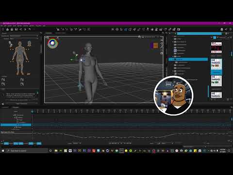

    Nice video on importing from cascadeur back to DSyes
    Yet thousands of people using the software  are somehow getting the secondary physics to work.
    here is a very quick and dirty example where I applied secondary physics only to the arms & hands. you can see the  hands are more  “floppy” on the physics preview character.
    It’s a deep program with alot of power& complexity so dig in and learn those settings
    it will be worth it trust me.
