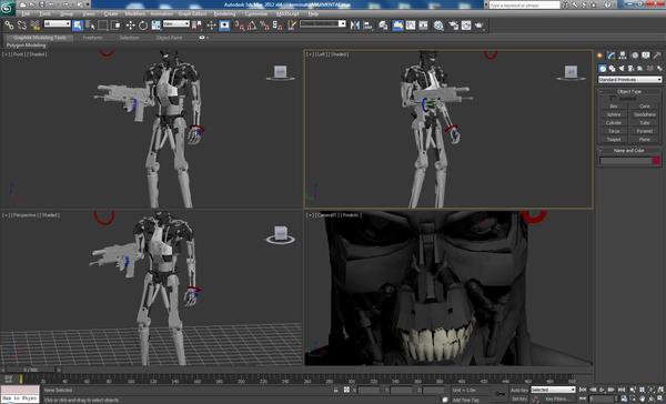

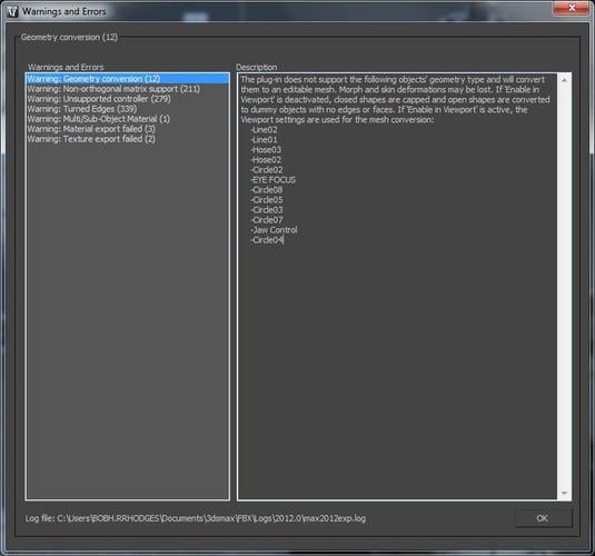

    Ok, here are a few images of my FBX import process into Carrara. it is not going well, and I really need some help. See for yourself:
    1680 x 1020 - 327K
    Post edited by bobh on

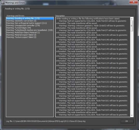

    Tried COLLADA - No Go.
    772 x 721 - 208K

    Then tried FBX. Not so many errors. But...
    772 x 721 - 91K

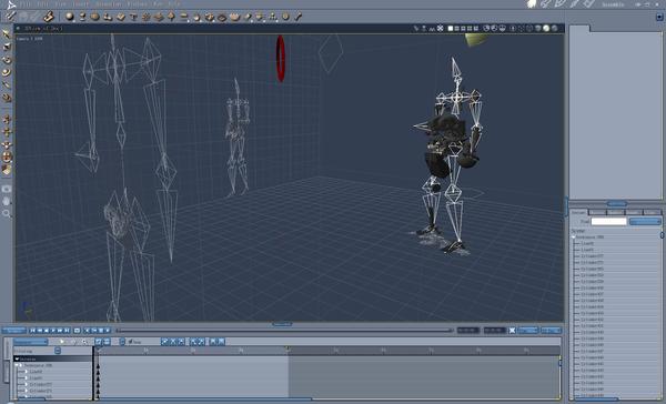

    And here's what Carrara does with it (FBX). Note the rig comes in just fine - it's the MODEL that's getting blown to hell:
    1680 x 1020 - 408K

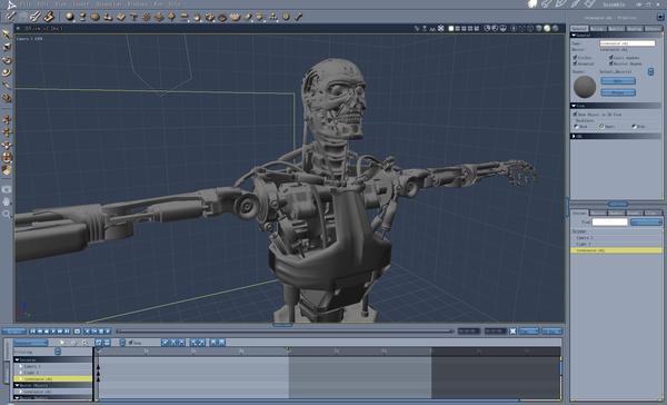

    I circled in red what is supposed to be the eyes and the sides of the head. It's that screwed up.
    1680 x 1020 - 409K
  • bobhbobh Posts: 0
    edited September 2012
    This is what it looks like if I bring it in as a worthless complete OBJ file.
    1680 x 1020 - 337K

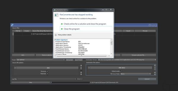

    So I tried the AutoDesk FBX converter. I cannot ge it to work without crashing. I get it all set and when I click to actually run the convert, it crashes. This is the only app I have ever had crash n my system, like ever (I'm a computer scientist by trade, so I take a lot of pride in the health of my systems).
    HEEEEEEEEEEEEEEEEEEEEELP!!!
    This is a DISASTER! I need the model and rig, and I'm running into nothng but garbage at every turn!
    Anybody got any bones to throw me here?

  • WendyLuvsCatzWendyLuvsCatz Posts: 37,880
    they WILL do free conversions for paid models so worth a try
    odd that fbx converter crashes, it does for me on corrupt files btw!
    occasionally my Carrara rigging explodes in particular if I use a bvh skeleton with animation upon export to iClone 3Dxchange,
    (OK in Carrara, it will also do so as a dae in Blender as do ALL animated Daz figures)
    those files crash fbx converter, likewise some animated dae of Daz figures, from studio too!
