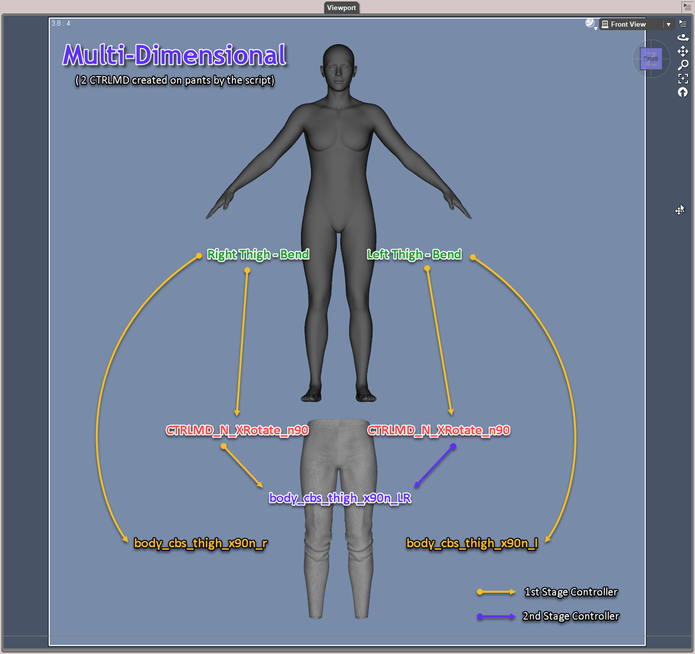

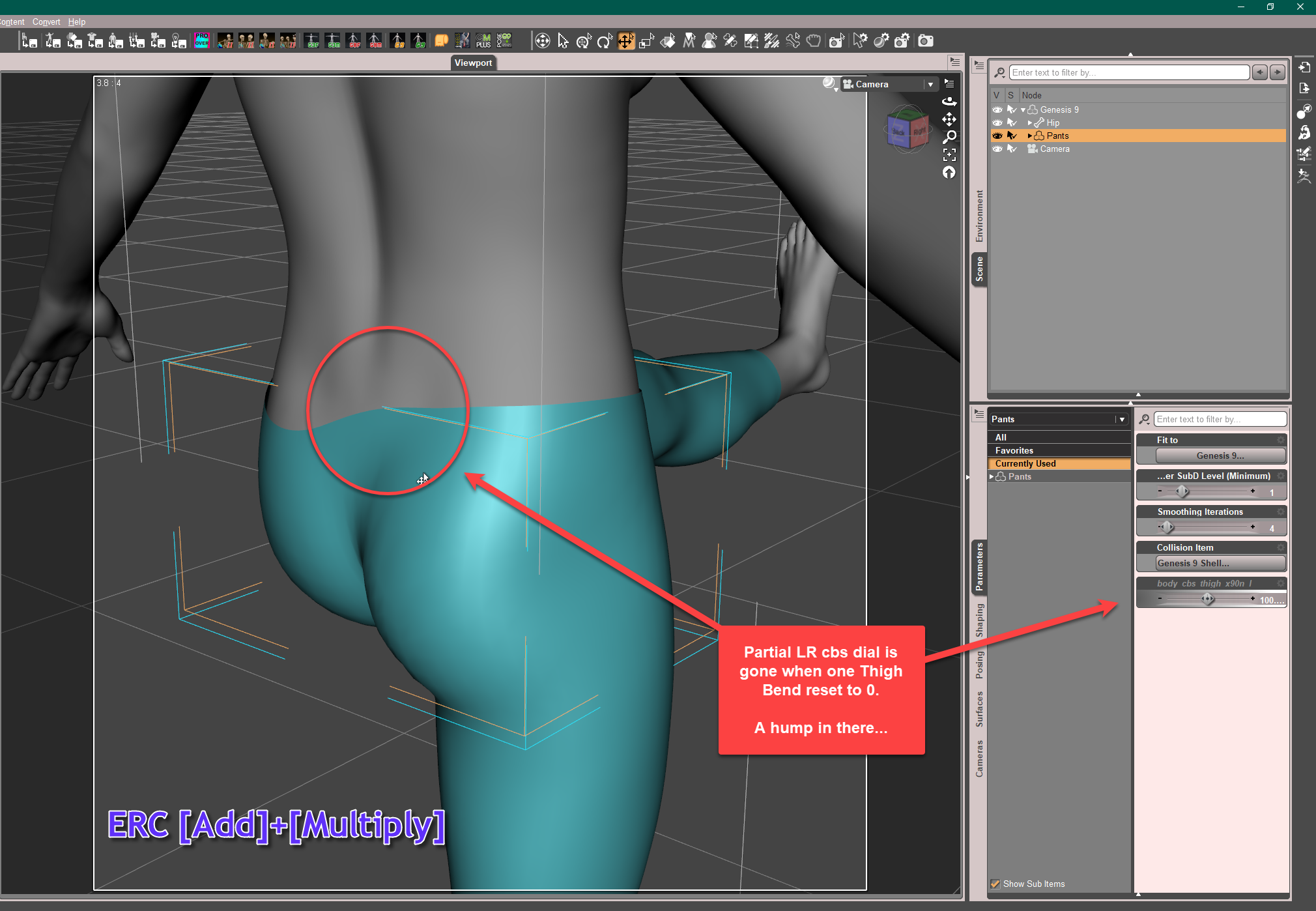

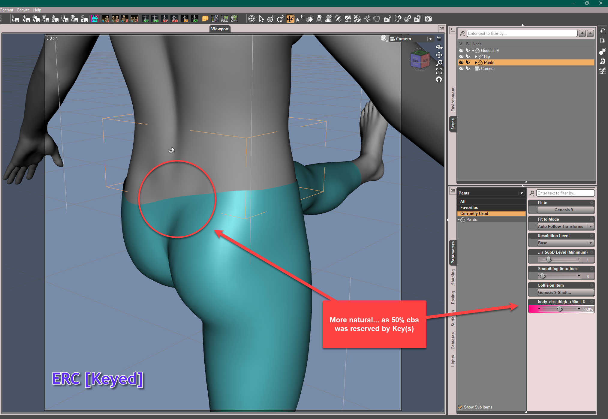

    Okay, I'm finished with testing the multi-dimensional script as what OP wanted and did. Here's the wrap-up: (as per the case of G9's both thighs bend forward 90 degrees, aka - XRotates of L / R thighs, plus 'the 3rd cbs' )
    MultiDimensional Way:
    1. It works with no problem though the workflow is different from Catherine's and mine. I attached 2 diagrams for your reference. In general, the script creates two CTRL morphs on the pants (same name but on each thigh), their controllers are figure's L / R thigh Bend, their sub-components are 'the 3rd cbs'. CTRL on right thigh goes to 1st stage, the one on left thigh goes to 2nd stage. So it's a 'two layers' control. Such a mechanism could be also found on G9 itselft, for a combo rotations - thighs Bend and Side-Side (X / Z Rotates).
    2. Fit to Mode of the pants has to be switched to 'Auto Follow Transforms', then you'll see the hidden 'Bend' dial on the pants, only in this way, you're able to use the script to automatically create CTRL dials. (I haven't used such a way before)
    3. As for ERC Freezing, only after you manually enter a value to cbs morph, there'll be a Raw value, then you can see 'cbs' in ERC Freeze dialogue.
    4. ERC Types : ERC [Add]+[Multiply]

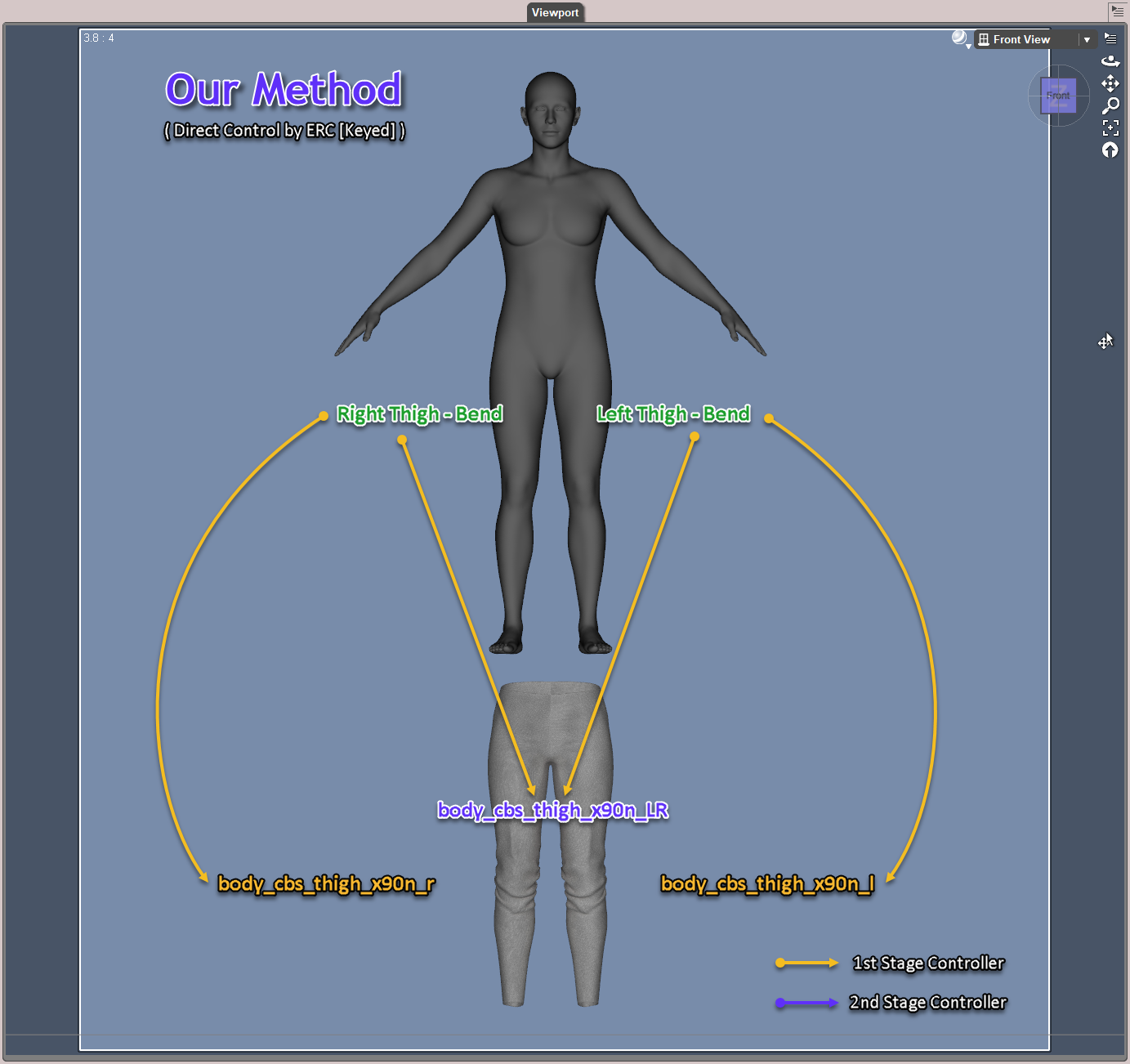

    Our Simple Way:
    1. One layer control: no CTRL dials, the Controllers are figure's L / R Thigh Bend or two 'cbs'

    2. For two stages controlling, technically there's no problem at all. But with ERC[Keyed] on 1st Stage only, we can make various subtle changes on the corrective result(s), though that may not be really necessary. Anyway, will go for more experiments.
    3. As Catherine mentioned, there're various methods anyway... All roads lead to Rome. However, I really want to know the reason and if there's any difference in terms of results by using these different methods.
    PS: I specifically tested the difference of partial corrective result from ERC [Add]+[Multiply] and ERC [Keyed], as attached. Pls be noted that I found there was no problem around the crotch of my pants when both thighs bend, so I made a symmetrical corrective morph on the back. Well it still depends on the garment design, its geometry and the fixed area..SS are just for your ref.
    2. No need to manually ERC Freeze, all ERC links are set within Property Hierarchy
    3. ERC Type : ERC [Keyed]
    Conclusion for the time being -:
    1. IMHO, I'm not 100% sure if creating CTRL dials on the pants and manual ERC Freeze are really needed, but as per the testing results, seemingly they're not. I live in Asia and have quite a few PA friends in here. I've checked with some of them, they don't use these methods either.
