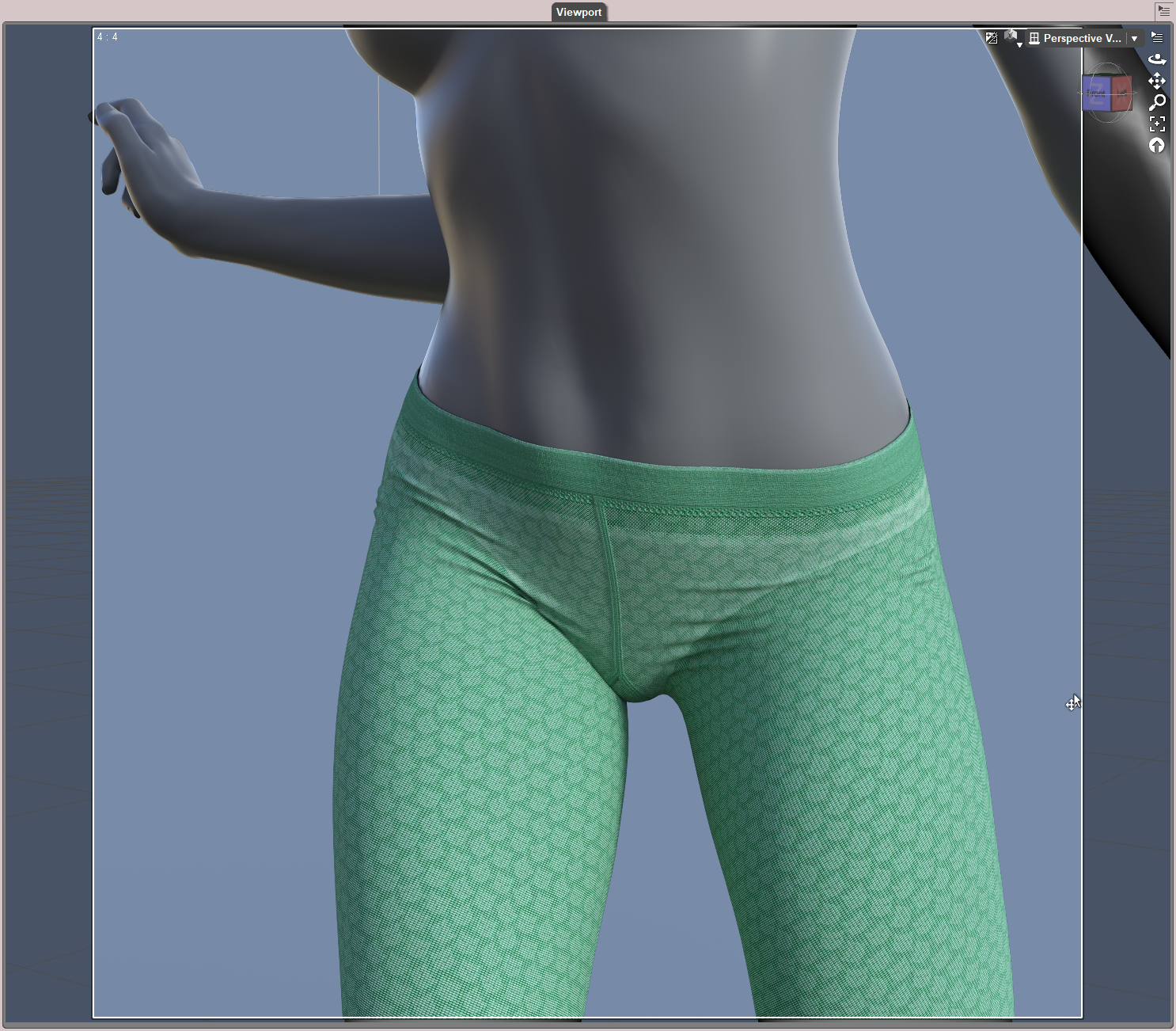

  • crosswindcrosswind Posts: 10,249
    edited September 2023
    I'm with Catherine if that's the go. If OP wanna have morphs and wrinkles, shell pants can give you great results with no doubt, 'cause it's just a 'second skin'. You can make morphs on it's parent and paint various wrinkles on its texture maps.
    And you never need to fix pbm / fbm / bs ... pjcm / cbs blah blah blah on it. No distortion, no poke-thru...
     That was fast! And beautifully puts into existence what I was trying to figure out how to say with words.

  • spearcarrierspearcarrier Posts: 711
    Those look pretty nice!!
    Geoshells are definitely very useful, especially if you have the ability to paint seamlessly to get the right effect. (I cannot do that yet. Attempts to learn in Blender have failed.)  Those "pants" look a little tight, though. Great for leggings. I'd have to ask you to change your clothes if you came into the office like that. ;-)
    However, there's a particular mermaid tail that uses geoshells. I got it and found it very very hard to work with.
    Yes, I like the geoshells best for cartoon outlining. (The manga shaders were a real break through for me.) I've seen them for makeup as well, and that's a neat idea except I like using resources and saving the skin that's created for later use.
    Now those wrinkles, would they show up as an actual wrinkle using pwtoon without the use of bump/distortion if you turn the model to the side? Or posed it differently?
    I once tried to drape a goeshell for giggles. That ended very badly. LOL!
    Post edited by spearcarrier on
