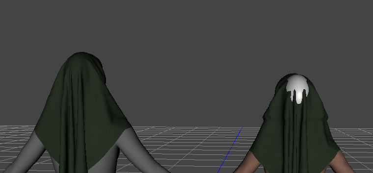

Confuse! My morph acts unexpectedly
JamesJames Posts: 1,178
edited July 2023 in Daz Studio Discussion
This is how my figure looks like on my hijab initially on non Gen 9 base figure.
I exported to Blender to fix stuffs.
But I didn't touch/sculpt the head area.
But somehow after morph loading
And set the morph to 100%, there are bumps on her head.
Why? How to fix this?
(images were removed by mod due to nudity. Please look at this thread for appropriate ways to post. https://www.daz3d.com/forums/discussion/3279/acceptable-ways-of-handling-nudity#latest )
Post edited by James on

    Going by the mesh image -- check for and fix all those 5 sided faces. When D/S exports out 5 sided faces, it "fixes" the mesh and invariably the end result is not likely pleasing.
  • crosswindcrosswind Posts: 9,712
    It's the typical 'quadrangulated' mesh from MD... I'm confused. OP: any smoothing modifier on hijab with high iteration value there?
  • charlescharles Posts: 866
    did you try converting to subd in daz?
    edited July 2023
     Well it looks like it has some goofies which need fixing esp. if they are what's causing the problem.
    Can see n-gons, D/S does not like n-gons and 'fixes' them ... also just fyi, some of the stretching mesh action there, IF that had been made in Hexagon one would also need to look for some line welding to be done.
    170 x 61 - 17K
    Post edited by Catherine3678ab on

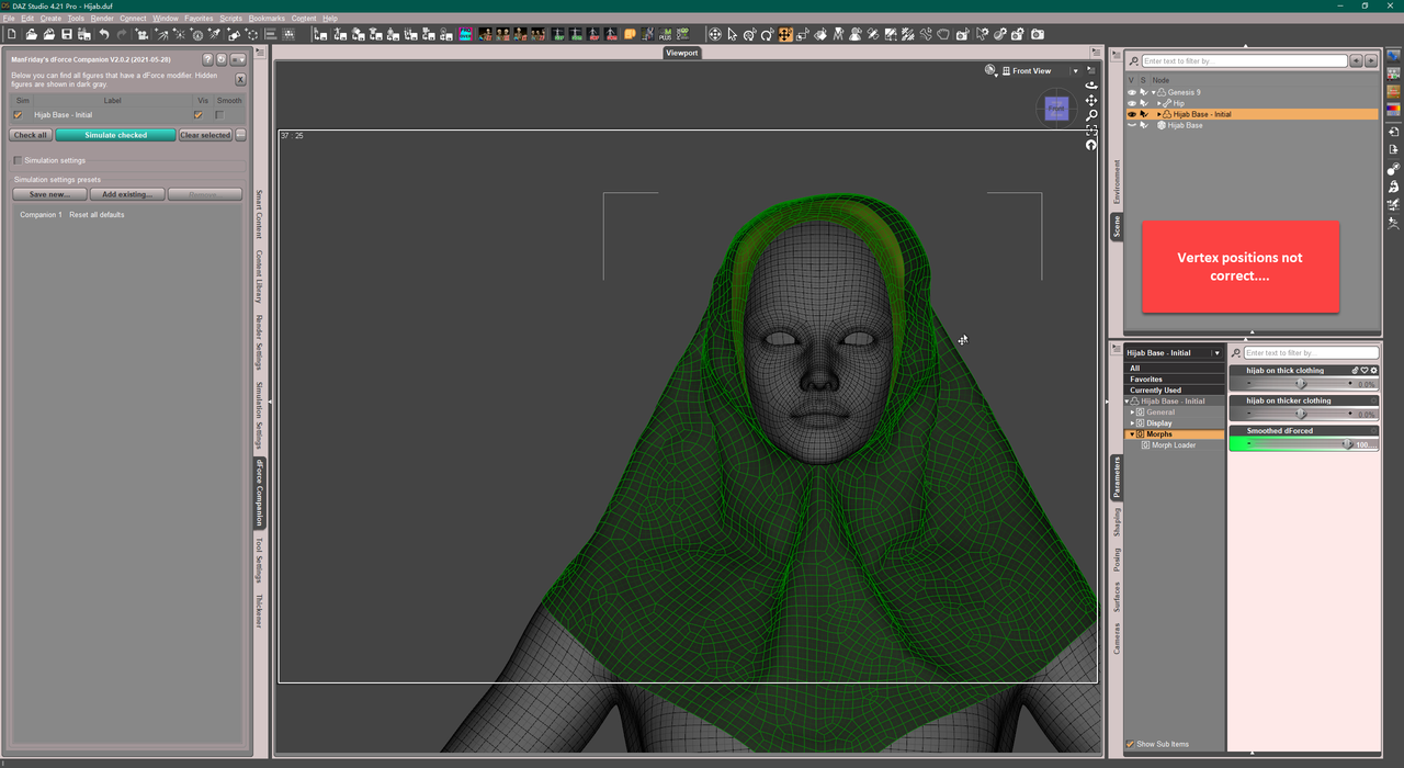

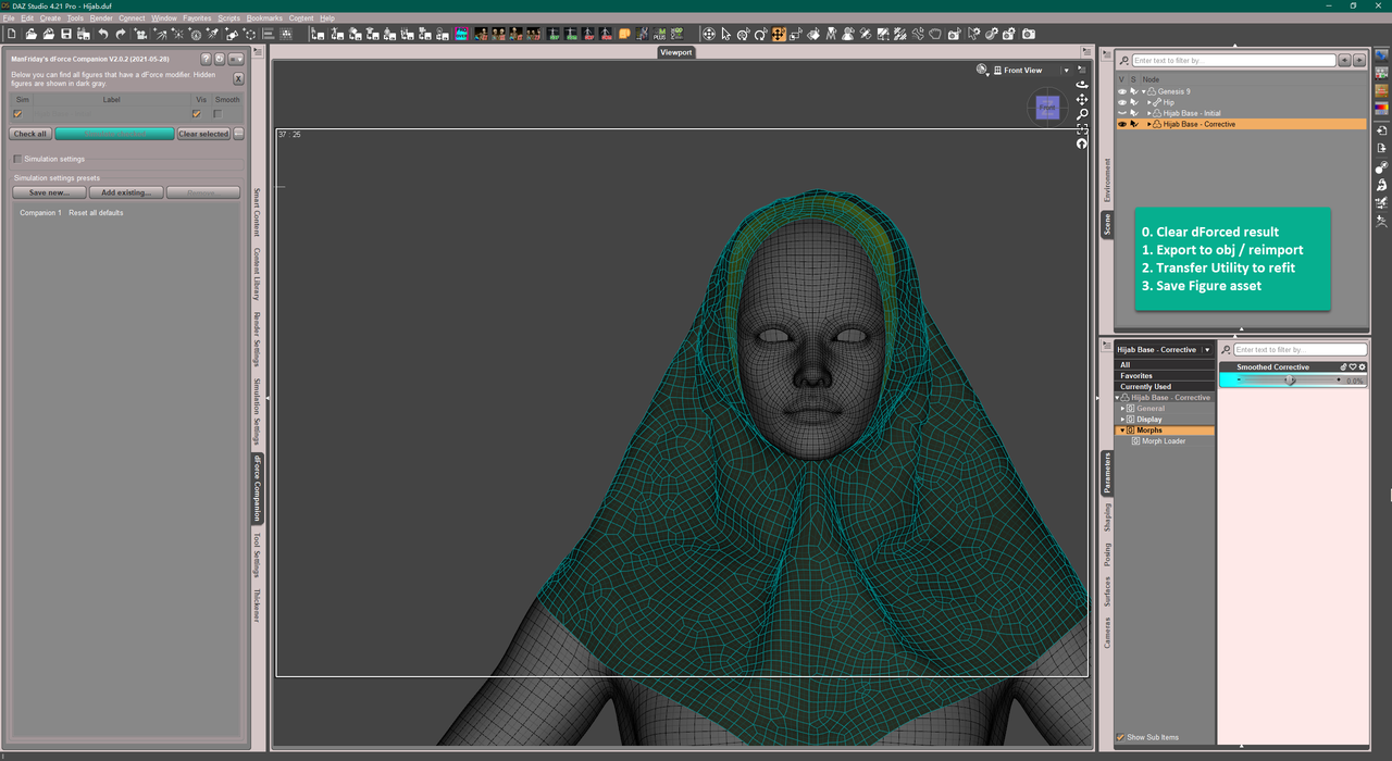

    Got it ~ I checked the hijab, you saved it as the Figure asset / Wearable with dForced result... as screenshot 1 - 2, so it was the culprit...that was why I first asked you about the dForce modifier and clearance...
    If you'd like to use the 'dForced result' as the base geometry of the hijab, you simulate it first and then export it as obj and import it back to DS. Then use Transfer Utility to make it 'refitted' to the figure, and save as Figure asset, as shown in screenshot 3 - 4.
    2560 x 1400 - 1M
    2566 x 1406 - 1M
    2560 x 1400 - 1M
    2560 x 1400 - 1M

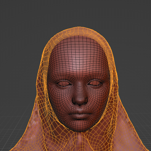

    After you put it on a figure
    Clear the dforce as you think it should.
    Try export the hijab, fix it on blender make  the head area smooth, no bump.
    Make it something like this:
    Reimport it again as a morph (morph loader pro)...
    See if the morph result will be exactly as you sculpted on blender or not.
    In my case it's not.

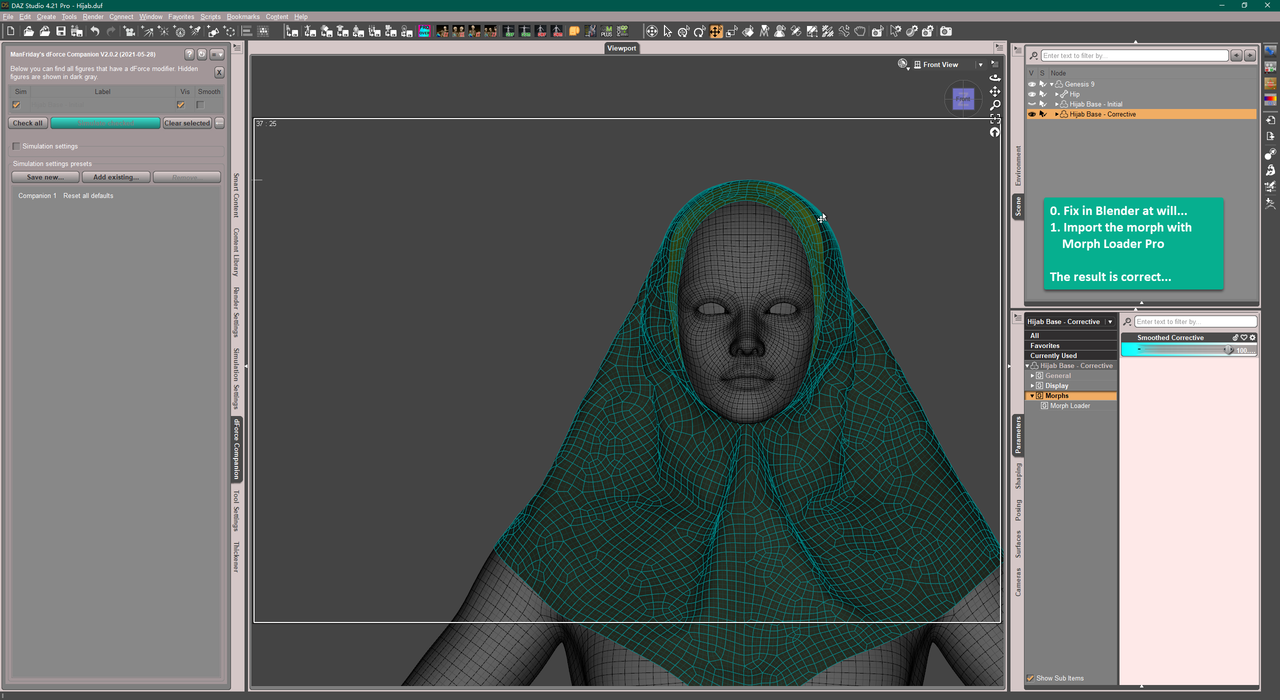

    edited July 2023

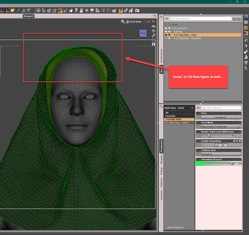

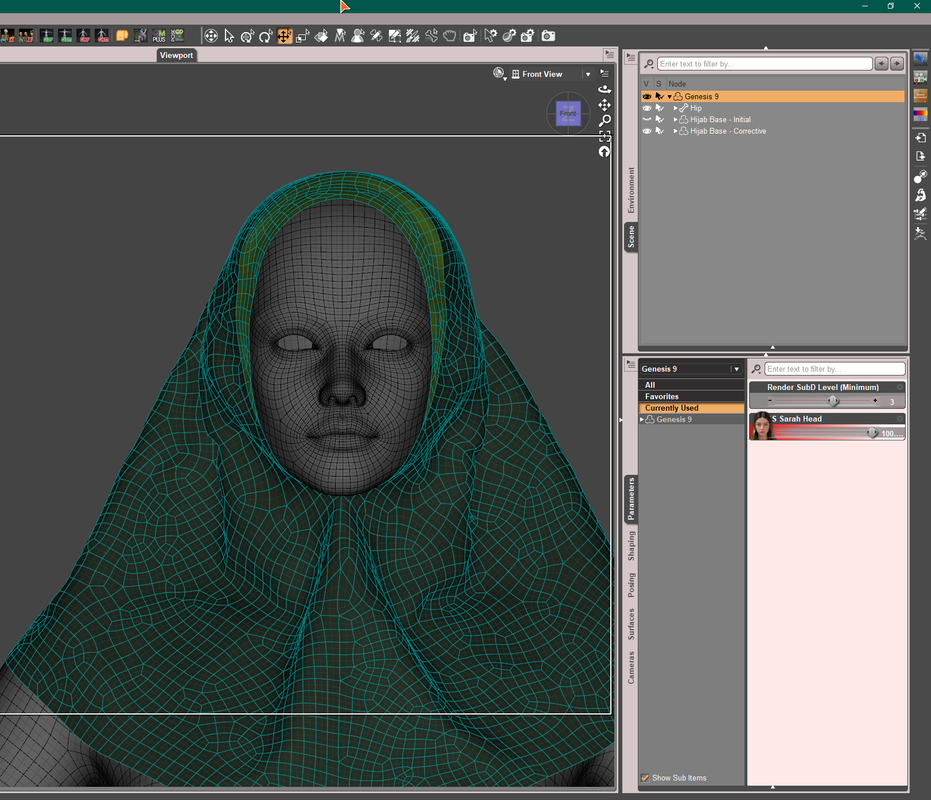

    I reproduced the issue you met (SS 1-2), and still it came from that you saved the hijab figure with the dForced result. When Morph Loader Pro 'reversed deformations', the geometry (vertex positions) turned wrong.
    So never save figure asset with 'dforce simulation result'. Correct way is shown in SS 3 - 4. (almost the same approach as I mentioned above...)
    1-2
    3-4
    Post edited by crosswind on

  • JamesJames Posts: 1,178
    edited July 2023
    Hai @Catherine3678ab
    Thank you for your time testing it.
    The lump/bump always happens only when I tried to make a FBM morph.
    With or without dforce clearance.
    I read a couple of times of crosswind and your writtings.
    The steps that both of you didn't do is making an FBM morph.
    (I hope I get the technical term correct.)
    Basically what both of you did is making a new conforming cloth to a body.
    That's why both of you use transfer utility.
    Which won't show the problem. As myself didn't find any problem when doing it myself.
    If there were 5 bodies and I did steps like both of you did. I'm sure there'll be zero problem.
    The problem only appears when I'm trying to make a FBM morph  (or is it FHM morph?)
    So... my steps:
    1. I put the hijab in a certain G9 figure. Usually there will be a bit of deformation.
    2. Sent it to 3D editor as obj, blender or whatever. Fix it.
    3. Import it back through morph loader pro to make the FBM morph.
    Both of you didn't use the morph loader pro.
    Aren't steps 1-3 how PA makes FBM morph?
    Could you... try it with the hijab?
    Maybe you could find something wrong, either me or the G9.
    If you have the time of course.
    So... my steps:
    Sure, I'll give it a go next round.
    Something to watch for with any FBM or for a particular character, is which morph(s) are in play. For eg. There can be a FHM and a FBM - dialing in either one will only affect the Head or the Body - or there is dialing in the "controller" morph which does 2 things, it dials in both the FHM and FBM AND it dials in any additional morphs required for a particular character [i.e. height].
    For figures with separate head and body morphs, be careful to only morph one area at a time in the hijab [here is where reverse deformations helps when making the 2nd morph].
    There were 'no' extra big bumps on the top when I made a couple of FHMs.
    https://www.deviantart.com/catherine3678ab/art/No-Big-Bumps-On-Head-970584247
    edited July 2023
    Hmmm... how did you do it exactly?
    I only know these steps:
    Before bringing it back in to make the morph through morph loader pro {or the Hexagon bridge for those using Hexagon} in D/S select only the Hijab {remember mine was just made, with no attached dforce simulation things}.
    On the Parameters Tab find the hidden used morph which is for the head. {or if is only 1 shape that's fine, then select that one} It is a "generated morph." Zero it. {don't mind what it looks like now}
    Right-click on the dial and click on "Edit" to toggle on edit mode. Then click on the tog wheel and click on Parameters. Find 'the name' and copy that info {might want to paste it into notepad}. RENAME that generated morph. {I also rename the label so it's easy to identify later on}{Give it something sensible like "don't save" or "delete"}
    Now bring in the new shape to make the morph.
    Paste in the name or type it in "exactly" the same as the generated morph had been named.
    It should 'pop' to 100%, if it doesn't dial it in. If it's a keeper, wonderful.
    Polish it {I call mine morph/shape, i.e. not generated, use limits, set min. to zero, put it in tree maybe under Hidden and check hide if you really want it hidden, color the dials as please}
    Then with the hijab still selected go to File > Save as > morph ... find and select ONLY THE ONE new morph that was just made by you.
    Then, delete the hijab from the scene. Select the figure. Load in a fresh hijab. Your morph should be looking as desired on the figure. Dial the shape out/in on the figure, then select the Hijab and the new morph should be there {toggle show hidden on of course}.
