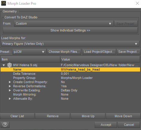

    7. Now bring in the new shape to make the morph.
    Ok, I use morphloader pro.
    8. Paste in the name or type it in "exactly" the same as the generated morph had been named.
    Ok. Here's the pic:
    9. It should 'pop' to 100%, if it doesn't dial it in.
    If it's a keeper, wonderful.
    Ok, It's 'pop' to 100%

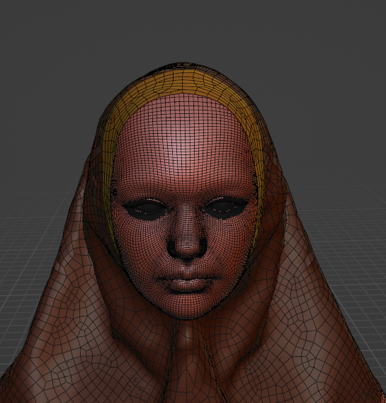

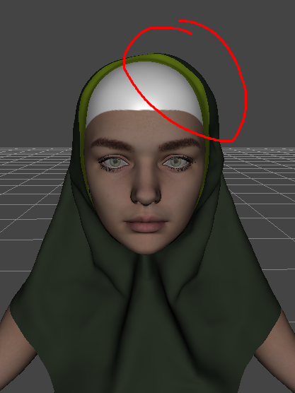

    But still it has the same lump :(
    I'm pretty sure it has no lump on Blender
    The back side that got fixed looks the same. Why only the top of the head that's so naughty.

    And are you starting with an Hijab that was modelled to the default shape of G9 first. Saved that first. Then doing all of the above?
    I don't have https://www.daz3d.com/mw-helena-for-genesis-9 atm, so can't dial that in to see what's going on. Maybe there's some other control morph in play that's affecting the end result.
    In which case, after polishing and saving what you have, simply make one more morph to dial in manually when putting the Hijab on this character. Many hairs and hats have additional fit adjustment morphs made to accomodate general adjustments.

    (I'll give you a video to reproduce the issue and show how to fix it...)
    Pls check this and give it a try: https://mega.nz/file/XfoiDSYC#ILRBDD0LnIn30ts1BFvoZXAr8pbm9dZka-J5wa1jE60
    And how to reverse Feminine Head Morph and Updating Base Geometry with Draping Result : https://mega.nz/file/qGAzwBQb#f1IeaSk2U81g2mRUeKI1HHz9L0Y_6e52ZeKvin9ivA0
    Post edited by crosswind on
