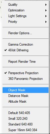

You will need to do it in two renders. One you render normally, the 2nd render you select the object that you want to show and then use the render options to make a mask render
Then you can use the mask to remove the background in a paint program that supports using layers.
