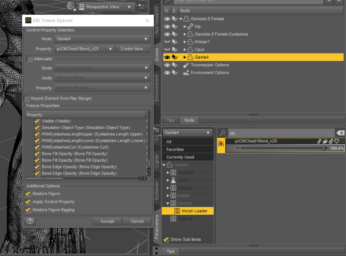

  • JamesJames Posts: 1,191
    edited August 2022
    I want to ERC freeze my JCM morph.
    But why my JCM name doesn't appear on the ERC Freeze Options dialog boxes' property?
    1125 x 833 - 349K
    Post edited by James on
  • Merging these as theya re related - some degree of separation is a good diea, but please don't split every sub-question into its own thread.
    ERC in general is explained here http://www.rbtwhiz.com/rbtwhiz_ERC.html
    ERC links can be seen in the Property Hierarthy pane - when the Parameters pane is in Edit mode (from the right-click menu) you can jump to a Property's entry there from the right-click menu, and can add controllers or sub-components (the two ends of a link) by drag-and-drop for more complex cases that ERC Freeze cannot handle.
    In general, when using ERC Freeze you need all the properties that are to be involved to be in their linked state, so that would be the chest bend and the JCM in this case, then you right-click on the proeprty that is to drive the link (the bend here) and the dialogue should show it as the controller (you right-clicked on the JCM above) and the properties it is to control (which is where you want the JCM - it is meant to be driven by the joint, not set directly) in sub-components.
    In this case, however, I think you are matching one of the JCMs in the base figure and for that you don't need link anything - if you give your JCM the correct name it will follow the JCM on the figure automatically without needing to be driven explicitly.

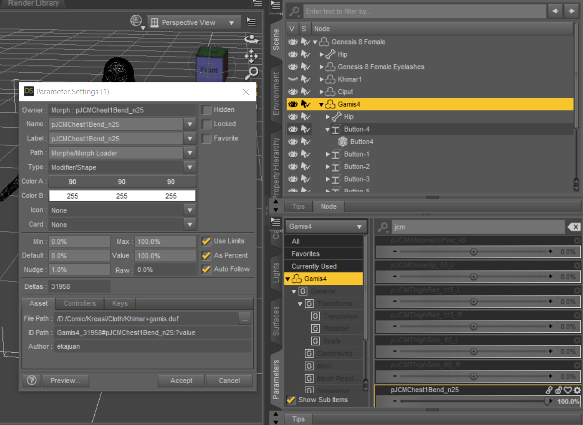

  • Is it linking the buttons' offsets to the bend? You can see by checking what is listed in Sub-componets when you click the gear on the slider and select Parameter Settings.
    edited August 2022
    I'm not quite sure what you meant by sub-components.
    But here is my parameter settings of the slider looks like.
    1169 x 852 - 320K

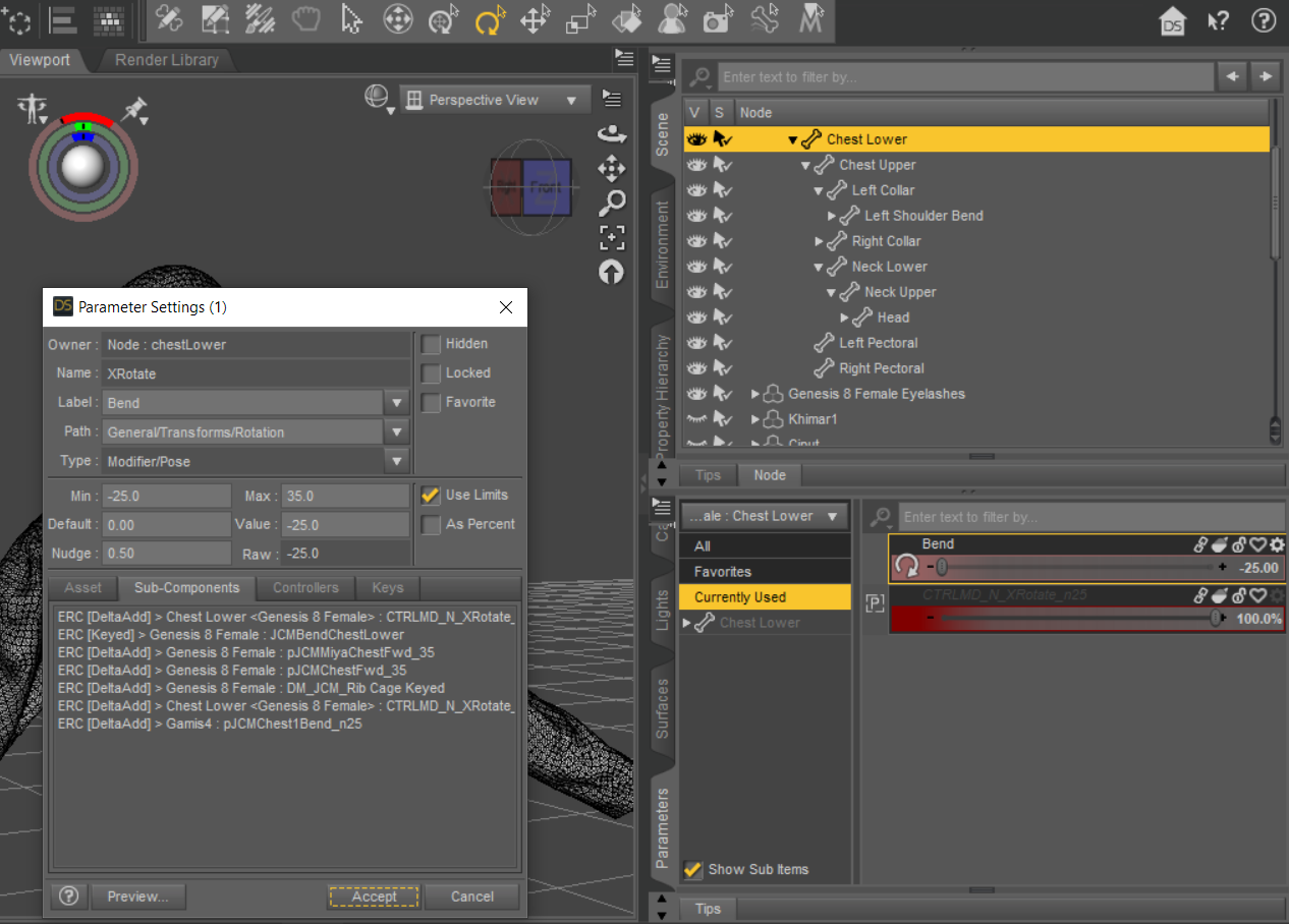

    edited August 2022
    O I see, I should select the Bend on a particular bone of the cloth related to the JCM.
    Here's how the subcomponents looks like
    1266 x 908 - 339K
