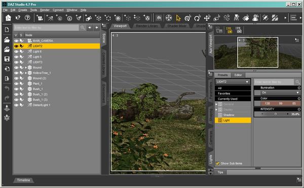

    Here's what I'd like you to do. Open up DAZ with your scene. Open the scene tab and find the lights. Click on the first light in the scene tab. Take a screenshot of that light. Then on the parameter tab, take a screenshot of the parameters. Then upload those. Maybe, by the name of the light and the way the parameters are set up, we can figure out which kind of light you are using.

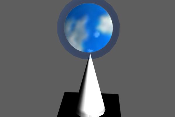

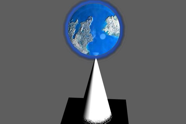

    well, this what gain does ... (i'm in 4.6)
    gain at 0
    1.0 is the default
    gain at 10
    800 x 533 - 50K
    800 x 533 - 97K
    800 x 533 - 97K

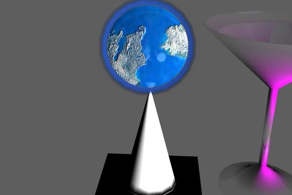

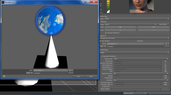

    this was a test with shadow sample
    =1
    =64
    800 x 533 - 70K
    800 x 533 - 73K
    edited February 2015

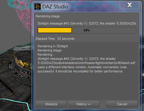

    ubersoft light gave an error message, interface versions

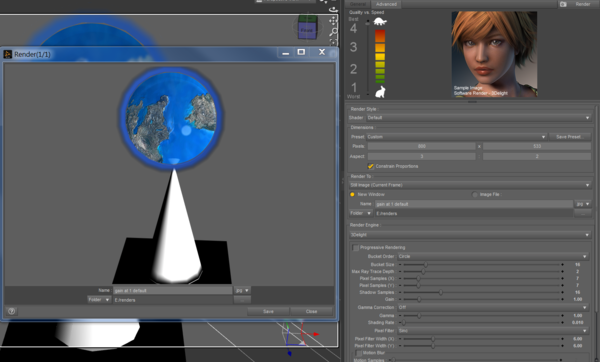

    testing pixel filter
    =1
    =32
    testing pixel sample
    =1
    =64
    1449 x 808 - 403K
    800 x 533 - 80K
    480 x 371 - 138K
    800 x 533 - 65K
    800 x 533 - 65K
    Post edited by Mistara on
    shading rate @ .01
    @ 256
    default = 1
    800 x 533 - 48K
    1472 x 887 - 508K

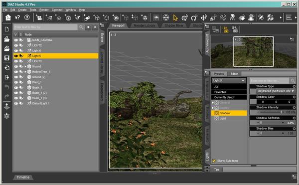

    i don't see a parameter/property for light type. doesn't look like it's changeable.
    but i do see different icons for the light.
    maybe, i should make a table list of all the available DS light types,
    then we could add tweak suggestions next to 'em for common render problems?
  • KeryaKerya Posts: 10,943
    Two screenshots of those lights
    1135 x 702 - 248K
    1135 x 702 - 236K
