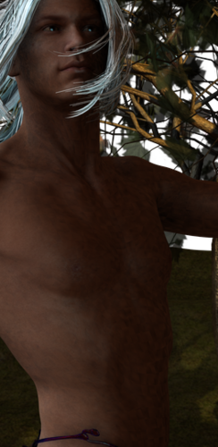

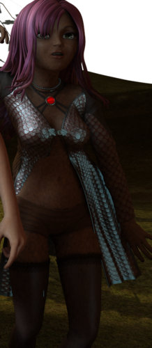

what would be the first few light adjusts to try to make less shmootzie shadows?
this was the enchanted glade and enchanted glade sunset lightset. (a duf file from a poser folder)
David and Jazzy don't look so good.
normally i would cycle thru a dozen light sets,
but this time was wondering if i could adjust something in the light properties or render properties ?
ds4.6
thanks :)

    I think the OP means that the shadows are grainy.
    Usually, this means you have to turn up the sample rate for the light source, if it is one of the area type lights. Or if it is a DAZ light it might be shadow softness or shadow intensity.

    I guess the set includes Uberenvironment2-light mabe with default or low settings. i was shocked the first time I used Uberenvironment at default settings because of the grainy shadow it would produce.
    Have a look at the settings in the editor and set the shadow samples to 128 or something like that.
    And your over all shading rate in your render settings should be 0.2 or 0.1.
    I hope that helps

    Most of the 'grain' in 3Delight is caused by a low number of lighting samples. For example, UberEnvironment by default uses a rather low number of samples. With a higher degree of samples, the blotches become increasingly smaller until they're unnoticed. The Advanced Ambient LIght also works on samples, and can be increased if you're getting a grainy lighting.

    Now I loaded them one by one - they are using differently coloured spotlights, usually one of them set to raytraced shadows with a bit of softness (2% up to 5%)
    One scene uses additionally a point light for the lamp.
