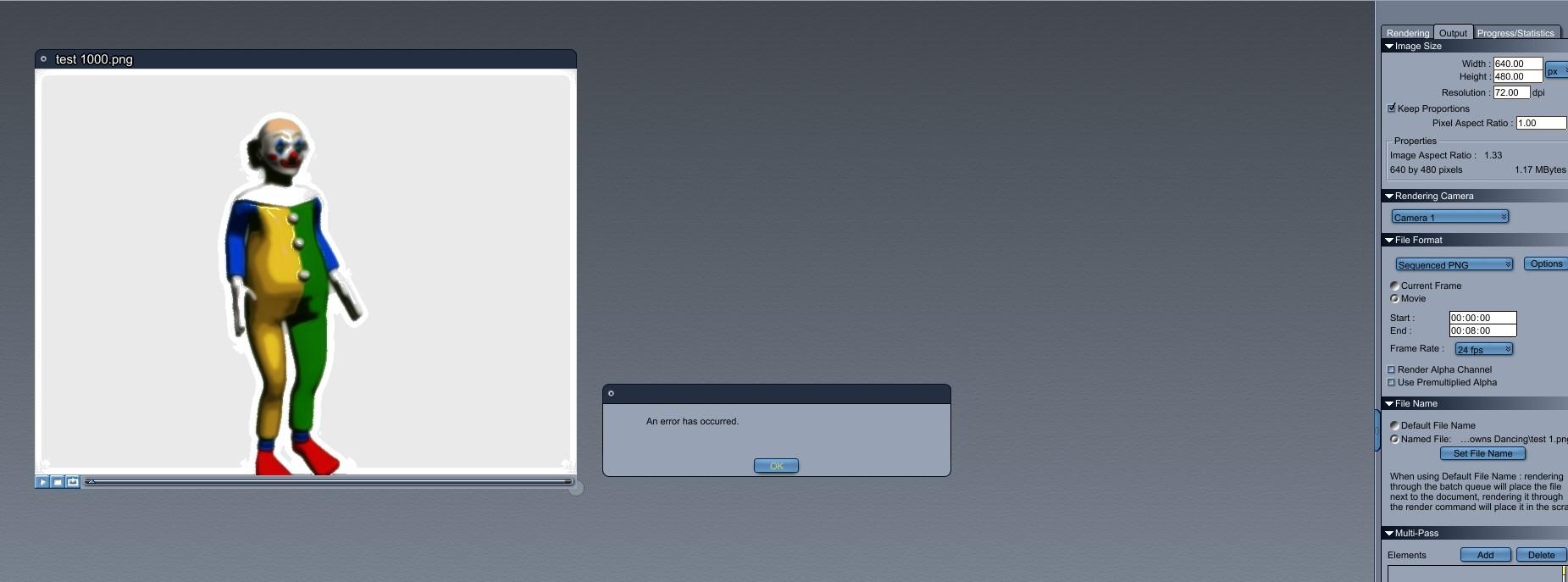

    Boohoo.  "An error has occurred."  Carrara does not like me rendering an animation with one of the GMIC filters applied.  I've tried it sequenced png and I've tried it to avi.  Errors for both.  No error when rendering to the standard photoreal without a post render filter.
    Simple scene.  Single figure with NLA clip for movement.  Solid color as backdrop.  Only mildly complicated scene element is some Carrara dynamic hair.
    For the moment, I will abandon the idea of rendering to GMIC filters unless I hear from people.  But if anyone has had success rendering animations with a post-render-filter such as Toon! PartIII or GMIC or YAToon, I'd appreciate any tips or suggestions.

  • WendyLuvsCatzWendyLuvsCatz Posts: 41,696
    you can render the image series in the backdrop using GIMIC and very low settings except pixel size
    I do it all the time
    ah misread thought you were rendering the scene
    some filters give me issues particularly the ones using a brush
    maybe it's the particular filter
  • DiomedeDiomede Posts: 15,464
    hmm sorry you have problems,
    I have rendered the commercial toon just as lines (can't recally what the commercial name is) with a an alpha channel and then superimposed them in post over an avi I made from a sequence of images
    that I'd fed into Carrara and used as a changing texture - gah could have explained that better
    If you want Gmic maybe you could render out a seequnce of non Gmic images and then batch file postwork them in GIMP - assuming you can do that with Gimp.
    Too many 'I have never...' for now, but I will file that suggestion away.  Thanks. I'm sure it will come in handy.

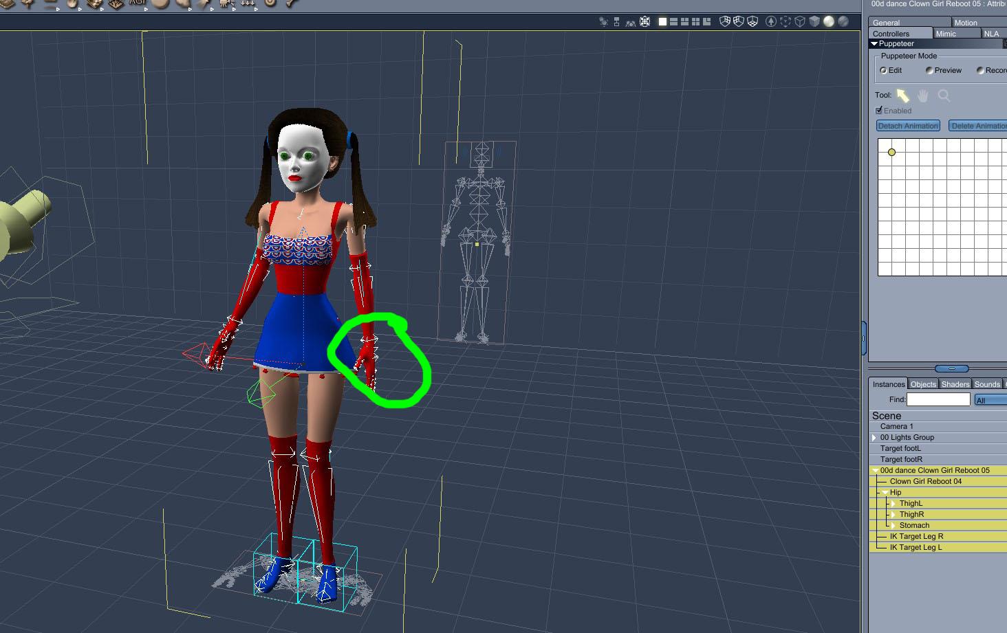

    Next problem.  I am trying to create and save some NLA clips for my custom figures.  They have inverse IK chains for the legs and feet.  For some strange reason, I am getting a wierd constraint-type-effect on a hand.  It happened in my fat clown and now it is happening on the female clown.  The first pic has my default load for this figure.  The second pic is after I selected the hip and moved it slightly in the Y axis direction.  Only the hip.  See how the left hand snaps to a strange pose?  Experimenting with turning off and on constraints, etc., something in the hand is caught up in the feet IKs, I think - but I am not sure.

    hmm you don't have a target helper somewhere Diomede ?
    Kind of disturbing to hear this.  I am not yet to the point where I can test it.  My vision of art is currently tied to GMIC, and if post-render effects will not animate, animation is out for me.
    That said, it seems illogical for them to not render.

    UnifiedBrain said:
    I got partial renders.  I don't remeber which was which, but I believe 80-something percent of one output rendered before I got the error and 90-something percent of the other.  Wendy reports success with post render filters.  It must be something about either my files, my computer, or something specific in my scene.  But whatever it was, you can see the unhelpful error code 'an error has occurred' with no helpful information.  In some ways it was even more painful to get the error after 90%.
    Anyway, I recommend doing a quck test of about 5-10 frames with the filter combination you are planning before rendering the whole animation.

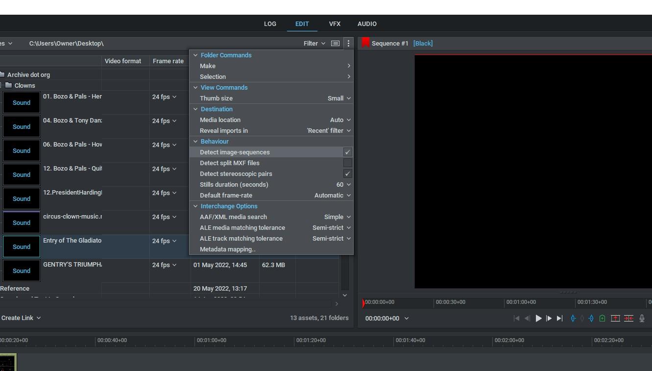

    @UnifiedBrain, I don't know about the software you will be using, but Lightworks has a menu option to detect image sequences.  So if you render to sequenced images, you should be able to load them.  Whichever software you choose will have something similar.  I am using the free trial stripped down version of Lightworks.
