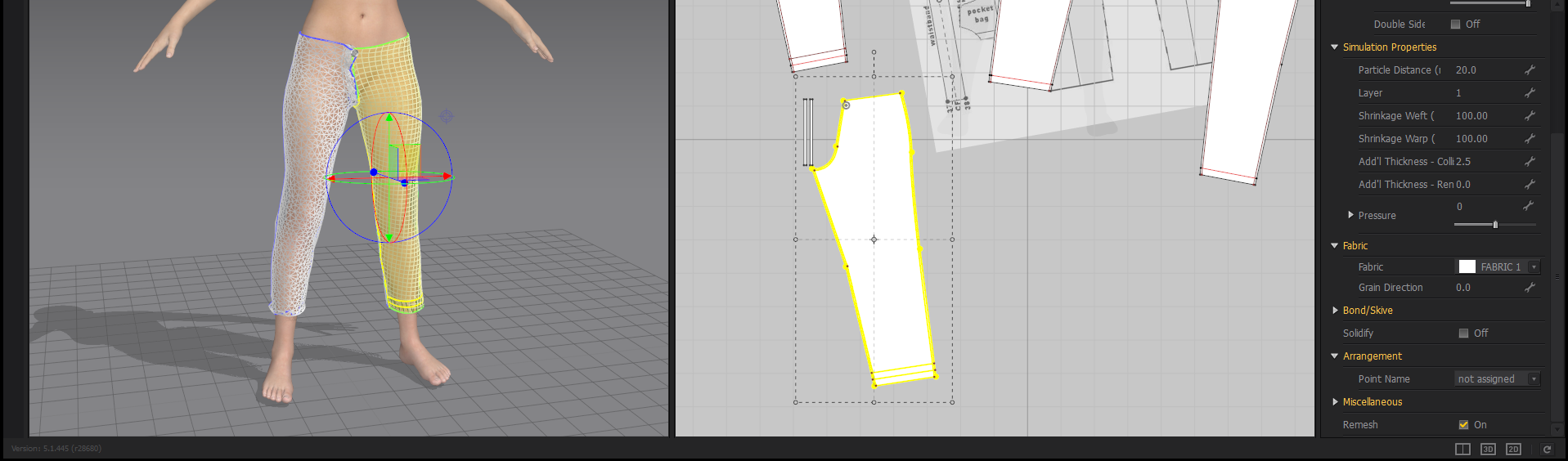

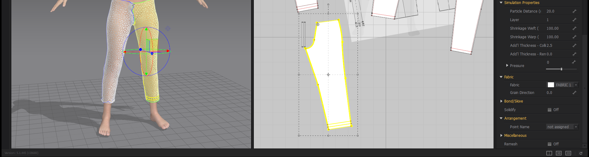

    I haven't opened MD in a little while, but I think all you have to do to retopoligize is check the "retopologize" button. This will make it look more like the kind of mesh you'll typically see on a clothing item in the Daz store. Retopologizing in MD is dependent on the orientation of the different components in the 2D viewer.
    Retopologize in MD is not a "push the button and you're done" kind of thing. Also, if you retopologize in MD, you lose all your seam welds and your exported dress will fall apart, unless you weld in another application.
    I suggest you try subdivision in Daz Studio (on your quadragnulated MD mesh). That will help quite a bit. Also look at the Geometry Editor command to rotate triangulation of selected polygons. Daz has produced a video tutorial about it.
    Maybe it's just a matter of which version we're using, but it is in 9.5.
    I didn't even know that was an option! Thank you, now my problem is this: every time the characters hand touch the dress (hands on hips pose) the mesh explodes. It doesn't do this when I buy a dress and do the same thing, so what am I doing wrong?

    I'm using version 10 and I just had to right click in the 3d window and the option was there for me...infact I had two remeshing options lmao

    Looks great! How did you get between the "before" and "after"? You evidently know something I don't know. (Which is probably a lot!) Were you able to export your garment as OBJ and keep the retopologized seams welded?
  • GordigGordig Posts: 10,807
    Look in the very bottom right of my screenshots. There's a little "Remesh" checkbox when you have mesh selected.

    Oh, I think what your are talking about is "Remeshing". In version 10 (I think) and 11, "Retopology" is a whole separate menu of commands. Retopology is a much more interactive process of drawing your own mesh, more or less. I think it is designed to make low resolution mesh for games, etc.

    I didn't see your comment before I posted. Yes, that is Remesh. Thanks for the clarification.

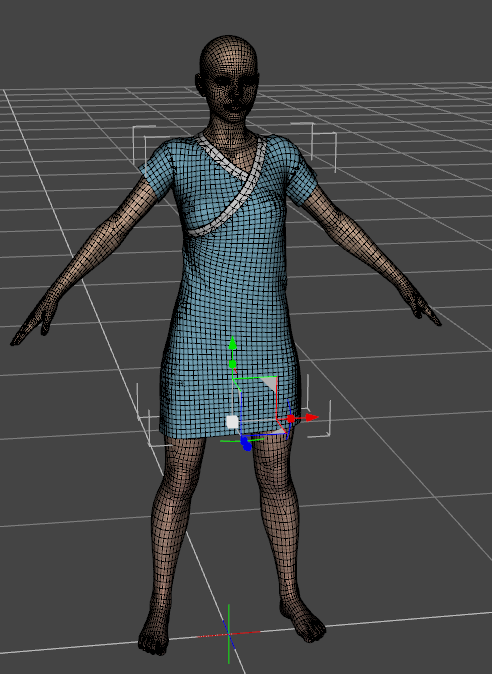

    barbult said:
    I did my first Marvelous Designer autofit, where I took a garment provided by MD for their avatar and autofit it to G8F in MD 10. The I exported it to OBJ and brought it into Daz Studio. I ran transfer utility and added dForce. On the left is the dress without any dForce on the basic G8F. The other three are G8F in various poses with dForce on the dress.
    This is a pretty simple garment - no sleeves, collar, cuffs, buttons or zippers, etc. The MD autofit worked pretty well on this.

    reizibarrientos_bb01567978 said:
    I love this dress, please tell to me where I can buy this one.
    This is a sample garment that comes with MD. I'm not aware of a place to buy it separately.
