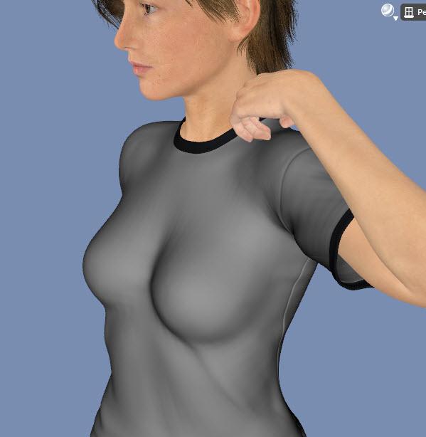

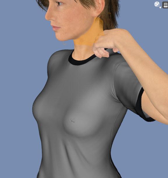

    On my dForce thread I have instructions on how to create a dForce breast helper: instructions here
    Image shows results
    Post edited by RGcincy on
  • tsroemitsroemi Posts: 3,543
    RGcincy said:
    On my dForce thread I have instructions on how to create a Force breast helper: instructions here
    Image shows results
    Oh wow, this looks great, will try that!
    Image shows results
    Agree it's fantastic, I'll also try that!
    (I bought your recent course too BTW - that's fantastic too!)
