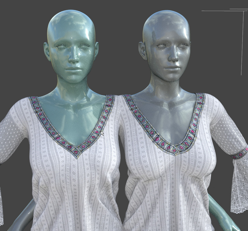

    I have been thinking about it too, and since I really don't understand all that well how/what Daz does what it does "under the hood" maybe I am chasing my tail...
    Regardless, I exported a g8 to Zbrush and played around a bit... just as a proof of concept. And then imported back to daz as morph.  I put a GF8, with breast enlarged next to my morphed up one.  While it might not look it inthe pictures, both models have about what is the same size... intended to be a realistic/larger size
    I then put some different clothes on em... I had the best results with dForce clothing, though I didn't simulate any of it, just put the clothes on the manequinn and adjusted smoothing
    Again, I really don't know what I am doing....
    The above was a slinky loin style dress, that didn't have a plunging neckline so it looks pretty good.

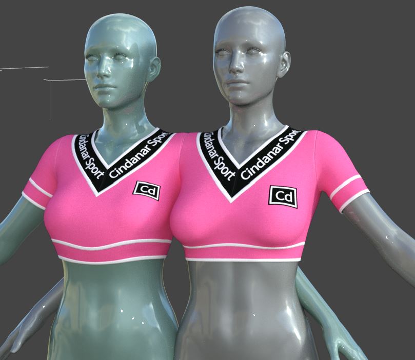

    The last was a sports top... mixed results.  On some of the non dForce clothes, it almost looks like there is a third boob in the middle.  I guess this is how daz reads the morph... I don't know how to adjust auto follow...

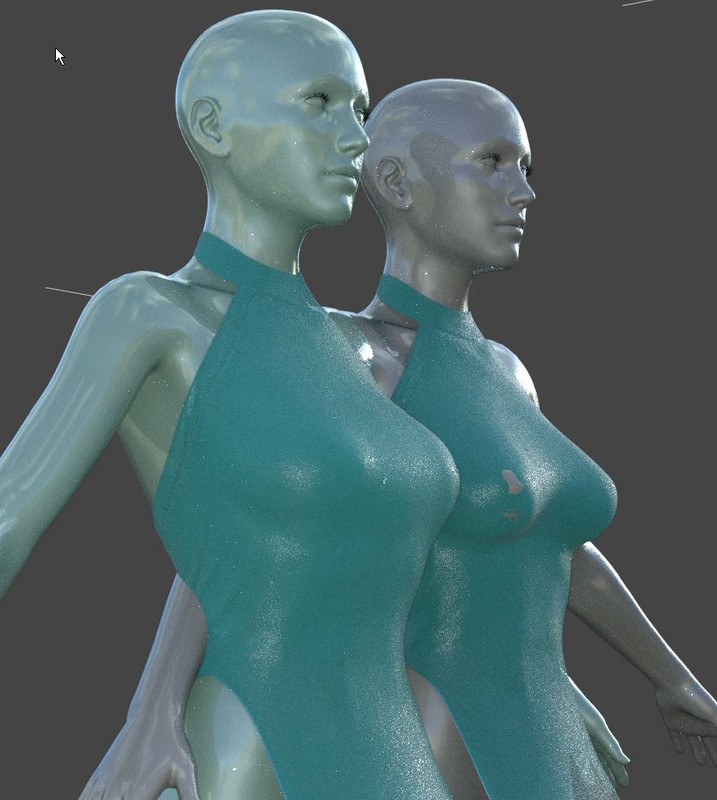

    This one really gives a good example of what is wrong with both approaches.  I am kind of curious how Daz hasn't come up with a built in solution yet, to a problem that is almost as old as the software.
    This is actually a really good solution.Because of the diversity in modeling from the breast shapes themselves to the clothing on top, there isn't going to be a 1 trick pony.
    It's probably going to need some helper morphs to go with, like raising and lowering the mid chester area. But overall great work.

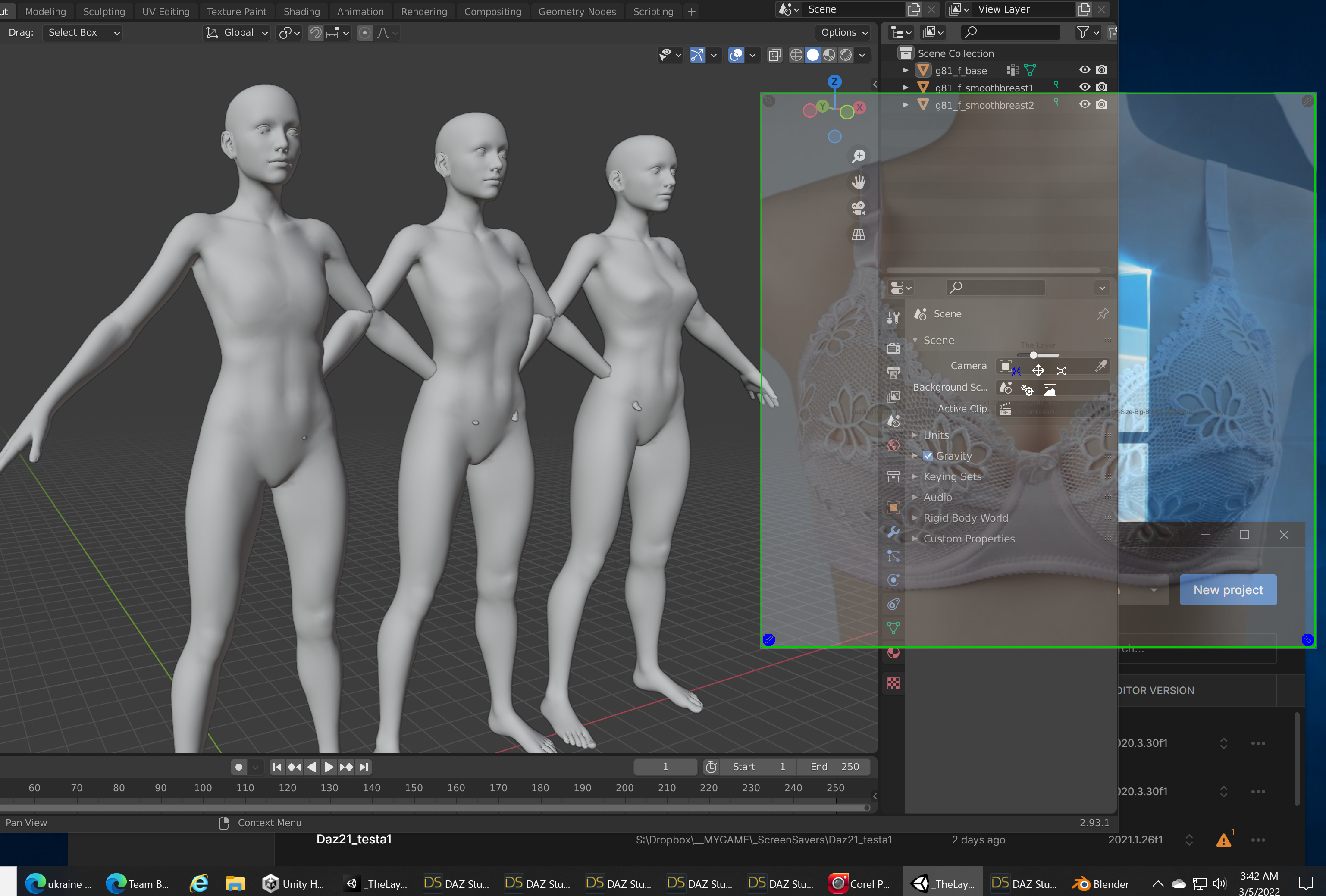

    I got inspired and wanted to play with this some too, so started making some in Blender.
    My problem the base shape of the character I'm using, the body morph itself. Even if I zero out all the breast related morphs the body morph still has significant changes to it that make it difficult So I'll have to either make morphs specific to that body by exporting it instead of the base G81 or remove the body's influinces on the verts for the breast. OR There's X glove, maybe...gotta find that in my file mess where I stashed it.
    I'll probably just edit the body morph itself as doing this in blender takes less time then it did to write this.

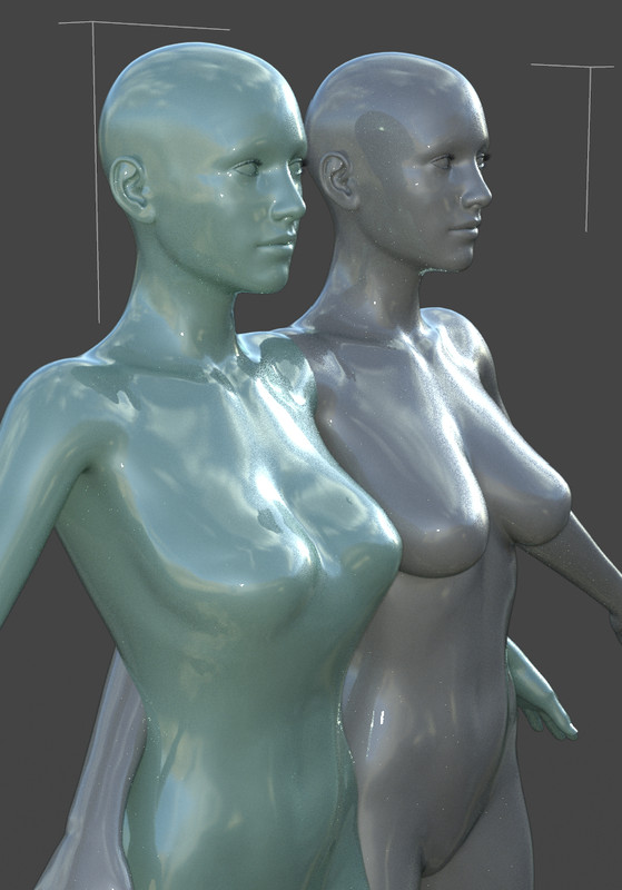

    Anyway, as far as this, it seems that some of you may be stumbling around in the dark a bit as far as what shape projection morphs should actually be. So, for reference, Whisky's projection morph, as seen in this earlier picture...
    ... has an internal shape that effectively changes her shape from this: (Sorry, I did these pictures with a quite short perspective on, so they're not as great as they could be, and would take me some time to redo, but hopefully they help)
    to this:
    And because it's a bit difficult to visualise from the still images how the vertices move, have one of the oddest GIF images I've ever had to make:
