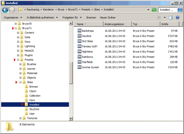

    Not very helpful at the moment, is it? But I can give you this: bsk files (Bryce SKies) must be copied into a particular folder. Locate where Bryce is installed. In the main Bryce folder, you will find sub-folders. Look for Presets, open it. There are yet more sub-folders. Look for Skies and open it. There are again sub-folders. You can create another one with any name, dougmain for example. In this folder (or any other that seems sensible to you), you can copy your bsk file(s). Next time you open the Sky Library, you will find your purchase in the category with the name of the folder.
    EDIT to add picture. Note that the Bryce main folder will be at another location.

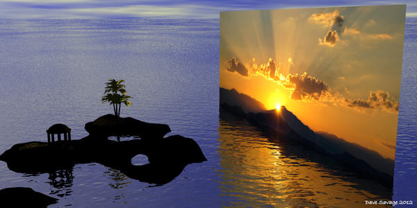

    First pic; Set up along these lines.
    Second pic; Gives these results.
    1000 x 500 - 120K
