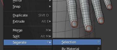

    Padone said:
    gerster said:
    other bug, which also appeared in the version before: nails seem to be grayish on the borders.
    That's probably random walk sss, that makes artifacts for disconnected meshes in the same object. If so it's not the addon it's cycles, and it's not a bug it's a known limitation of random walk. You can select the nails by material in edit mode then separate the selection. This gets rid of the artifact. Or use burley instead of random walk in the sss nodes inside the uber skin group.
    https://docs.blender.org/manual/en/latest/render/shader_nodes/shader/sss.html
    edit. Just tested I can confirm it's random walk. Both the solutions above work fine.
    Hey, just found the time and verified it. Yes, changing it to burley works like a charme. That's a good work around, until this is fixed by DAZ.
    DAZ_sam said:
    @gerster
    I get what you mean with the skin. Being completely transparent the skin is just set up wrong and needs a rehaul completely as well. Unfortunately, the bridge has larger issues on our list right now but, if you like to make edits for yourself in the meantime you can with no coding experience.
    \AppData\Roaming\Blender Foundation\Blender\2.92\scripts\addons\DTB\dependencies
    There you will find a blend file called link_library that can be customized to your choice. I did a basic job which is I am still not happy with but, we took it out of the code as we know some users like setting up their own materials. I will document this better in the future (this bridge needs that anyway) but, hopefully, that helps a bit?
    Not sure what you mean exactly with a completly transparent skin, the issue is like Padone described a troublesome setting in the shader. All you need to do is set Random Walk to Burley  for the nails and it should work fine...?
    However, there is no hurry because of me to fix this. As long there's no general geocraft support and ShapeKeys with Armature support, I can't using the bridge for my work anyways.
    Just wanted to report the bug with the nails.
