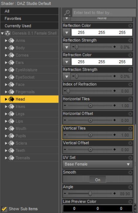

    Generally I do once a Head version of the textures (or LIE for tattoo), Body surface can use Torso texture. It's easy to create a new Material preset.
    It takes less than 5 min.
    Note: you can also select Genesis 8 UV set in the geoshell (For example Base Female instead of Base 8.1 Female)
