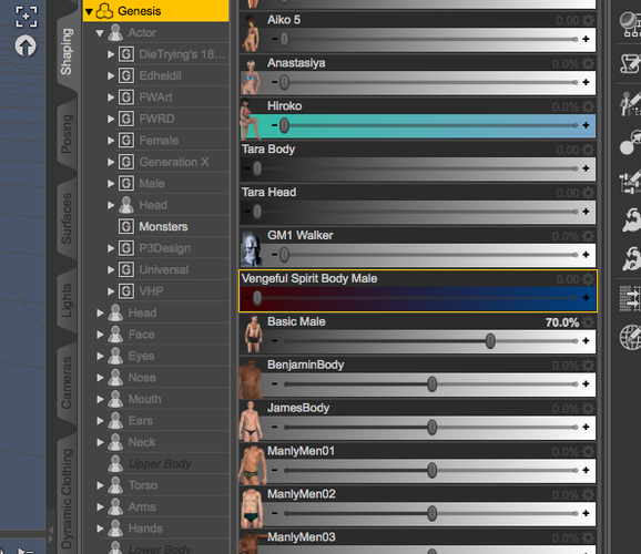

Everything works fine but: when I double click on Genesis figure I can't find, in the Posing>Editor tab, the ACTOR section... [see attachement]
Let's say I want to have a Genesis with 70%male, 25% Basic Child and 5% Basic female... how can I do this without those dials? All the pose dials (for example Head>Expressions) seems to work fine...Obviously I am missing something, but what?

  • PlatnumkPlatnumk Posts: 682
    Make sure the Genesis Figure is selected in the Scene Tab, Then you need to goto the Shaping Tab (if you ca't see the Shaping Tab then goto the 'Window' menu then 'Panes(Tabs)' and select 'Shaping' you should then see all of the actor diallers.

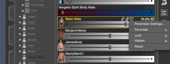

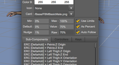

    PS. you may need to change the settings on each dialler by clicking on the little 'Cog' and select 'Parameter Settings' and putting a check mark into the box that says 'As Percent" next to the 'Default' setting
