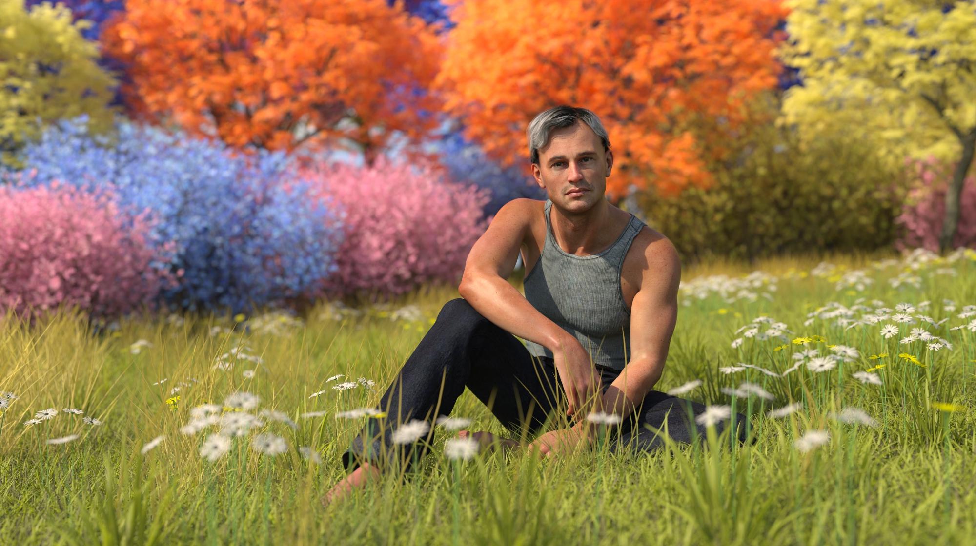

  • barbultbarbult Posts: 26,532
    edited June 2021
    I liked those colorful trees and bushes so much that I created material presets for the UltraScenery Oaks props. I generate the UltraScenery scene, like normal, and then apply the materials afterwards. I didn't bother to make new ecologies. I just created several hierarchical material presets to apply various color schemes to the Oaks. This is an old scene that I called up and applied one of the material presets. I love the colorful dreamy quality.
    3840 x 2160 - 4M
    Post edited by barbult on

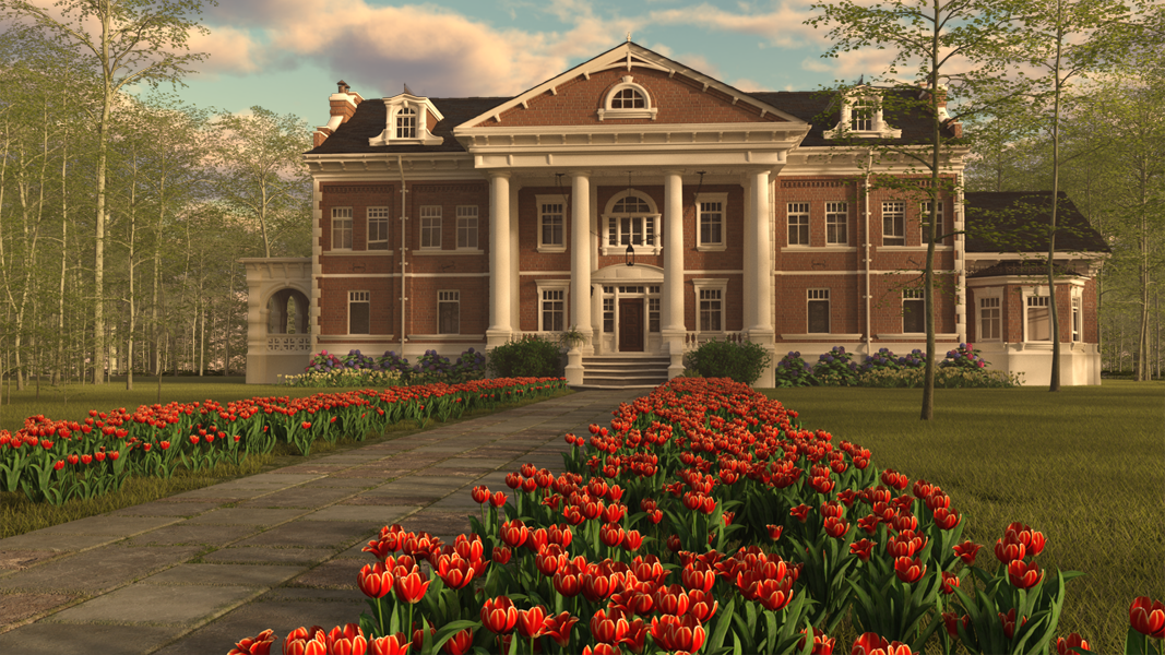

  • sandmanmaxsandmanmax Posts: 992
    edited June 2021
    Not to totally side-track the discussion of the dirt track (because I really need to know about that as I will explain below), Here is the latest image I've been playing around with.  I totally fell in love with the Albert Mansion and got obsessed with remodeling it (all done with shaders and surface settings) and bringing in the bulldozers and giving it a proper garden (Ultrascenery).
    I had some problems getting things to work.  First, is related to the path situation above - I was trying to create a custom height map that would provide a nice flat spot for the mansion to sit on but I wanted to use barbult's brick path shader technique to create the walkway.  So I tried to use the features with the paths but they wanted to put a nice little rise where the track goes.  It makes sense for a path to be built that way but I couldn't balance the house on it.  I did figurr out there are some maps that Howie uses that create this effect but I didn't feel like hacking a json file.  Is there another way to flatten out that path hump in the landscape? I finally gave up and created a totally flat terrain and used Code66's Auto Paver to create the walkway.  The 2nd issue was trying to create a height map with a flat spot at one end.  It either wanted to create mesas (when the map had distinct edges) or added lumpiness if I used any noise at all to make a gradiant more interesting. Any tips for height maps when you want something to look a specific way?  And last, I wanted to use HDMI for lighting but I kept getting clouds showing through the trees at the horizon line.  I ended up creating a 2nd scene (both of these are Harpwood) and just rendering my own huge tree-line and merging them in Photoshop.  You still see the white thru the trees on the left.  Is there anyway to deal with that?  I tried rendering the ground, I tried a Denki Gaka sky that had ground in the image and then rotated the dome in an effort to bring it high enough up show the tree.  It didn't seem to work. Any suggestions?
    (The tulip beds are ultrascatter pro.)
    1067 x 600 - 1M
    Post edited by sandmanmax on
    edited June 2021
    @sandmanmax - a couple ideas about your clouds showing through
    1. Did you select extend background in the UltraScenery build tab. That can help fill in gaps.
    2. You could use the HDRI for lighting only, and use an image in the Environment tab (not Environment section of Render Settings) for your scene background. You could even create that image with a completely separate UltraScenery build and a densely wooded ecology to fill the entire terrain. Light it with the same HDRI, for consistency of lighting and to get your clouds. Save that render as an image and put that image in the Environment tab as a Background.
    By the way, that AutoPaver did an excellent job! I think that looks better than the shader on the path would have. That sometimes get too repetitive. You did a nice job renovating the Albert Mansion, too. The tulip borders lead the eye right ot the mansion. It is a great result all around.

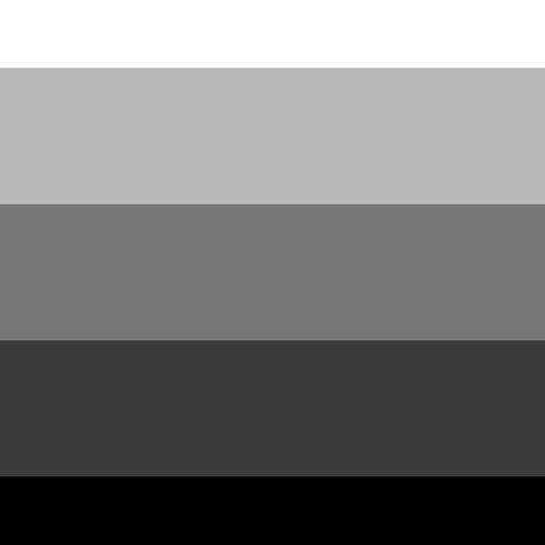

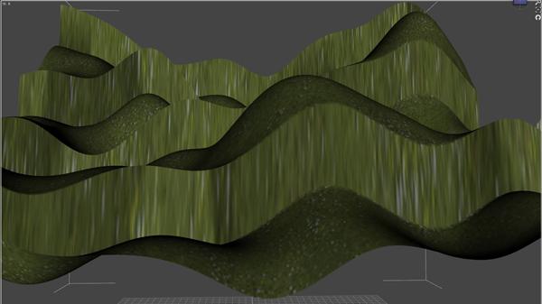

  • Jason GalterioJason Galterio Posts: 2,562
    edited June 2021
    I am trying to figure out what is introducing the waves to this landscape. I figured this was the place to come.
    I am using this greyscale as a height map. I've lowered the resolution of the greyscale for display purposes. The original file is 1500 x 1500.
    I have the max. altitude set at 50 (which is extreme, but I was trouble shooting). The features are set to none. The Ecology doesn't matter as each produces exact same wave. I turned the nature visibility off so that I could see the terrain. Here is the result.
    Where are the random hills coming from? And is there a way I can turn them off to reflect just the greyscale.
    On a whim I changed the resolution of the greyscale to 1500 x 15 (width) just to see what would happen. It produced an indential wave pattern.
    500 x 500 - 5K
    600 x 337 - 95K
    Post edited by Jason Galterio on

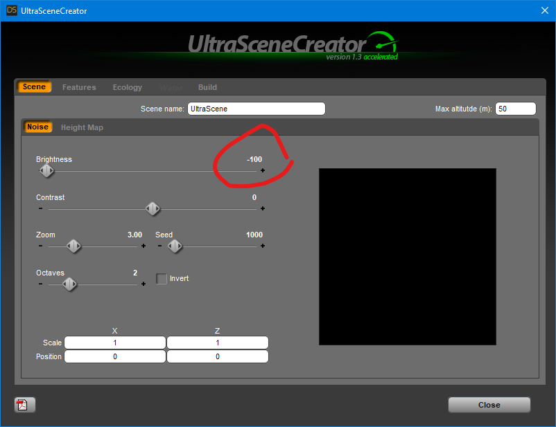

    edited June 2021
    The Noise part of the terrain definition in the Scene tab is probably causing your "waves". Turn Brightness to -100 (solid black) and the noise contribution should be eliminated, using only your height map.
    Edit: corrected brightness value and added illustration
    Yep. That's exactly what it was. I had no idea that the Noise window was still active when you use the Image Map.
    One correction though, Brightness needs to be set to either -100 or +100 so that the auto generated field is either all black or all white.
    Thansk!
    Thansk!
    You are correct. I typed that in a hurry without opening UltraScenery. I should know better. I'll edit the original to correct it. Thanks for the feedback, Jason.

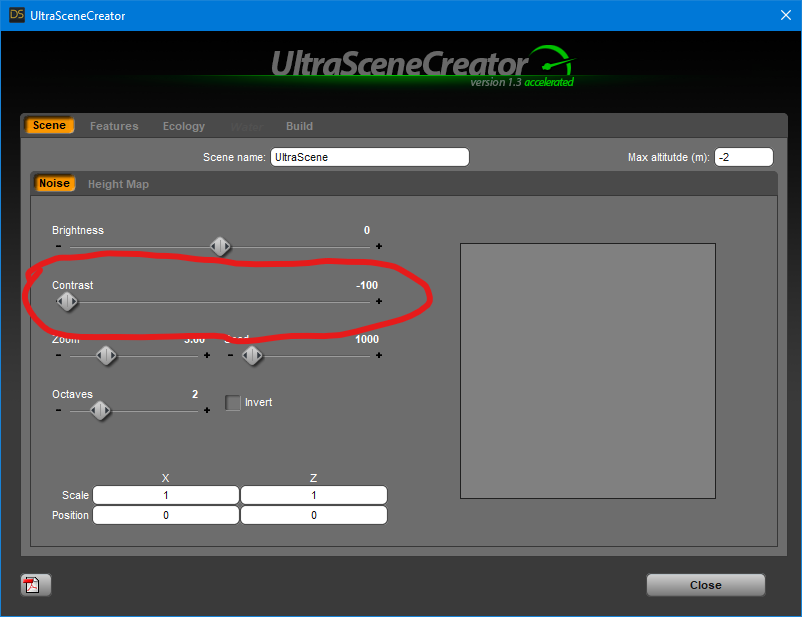

    edited June 2021
    Thansk!
    No problem at all. I really appreciate the quick feedback to be honest...  You pointed me in the right direction and enlightened me to what I was overlooking. I had been pulling my hair out for almost an hour.
    It would be nice if there was a way to make the whole field a 50% grey. Using all black or all white makes the terrain either lower or higher. But its really just a quibble...
    Really rough render below to show it works.
    You can make it all gray by setting Contrast to -100.
    802 x 617 - 50K
    Ah, thanks! I will give it a try...
    I've been experimenting with using the brightness at very low levels, -75 to -90. Just enough to provide a little bit of organic variation to the greyscales, but not overpowering them like the initial attempts.
    Thank you again for pointing out this. I've been operating under the misconception that the Noise window was inactive when using the image maps. Your advice has been a revelation for me.
