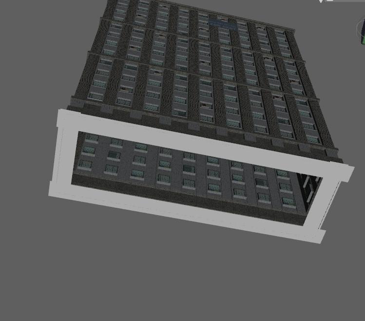

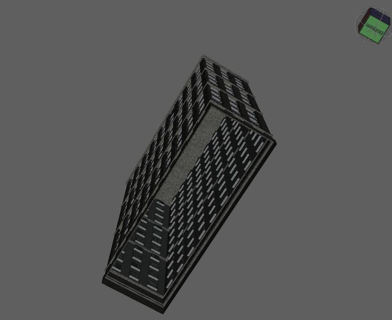

    Bought the tool. A little disappointed Daz didn't include the cutters. I've logged a ticket as suggested.
    I'm attempting to blow a hole out of one of Stonemason's Ubran Sprawl 2 and 3 buildings. I've tried with both but I flat out can't get it work. I've tried substituting the cutter for various primitives and also some debris props. No luck. It flat out won't cut. I've confirmed there's plenty of polys in the building mesh. Nothing happens when I hit fracture. Any suggestions?
    Screenshot attached.
    They're open-mesh, not solid objects. This is the Building 17 of your image.
    Oh ok! Sorry, dumb moment. Thanks for replying. So if I used your merge tool to merge a solid block into this, I could then use the fracture tool?
     Yes, that's the objetive.

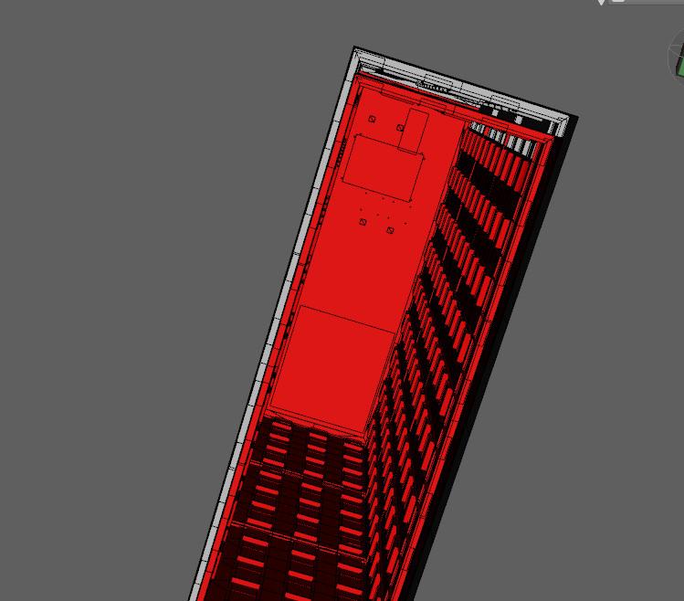

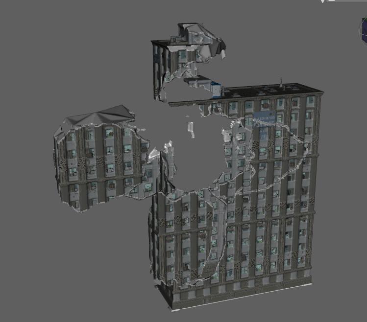

    There is a trick to force Gescon to fracture these buildings using a geometric shell (or a duplicate of the node) and four planes.
    1. Create a geometric shell of the building (or duplicate the building).
    2. Scale down the duplicate or shell (global scale to 90-92 %).
    3. Translate the duplicate or shell so the bottom part is at the same level as the original building.
    4. Create four primitive planes and scale them to get two pairs of planes that cover the gap between the original building and the duplicate. Let alone the central hole.
    5. Set invisible all the objects in the scene, except the planes, the building, and its duplicate.
    6. Export as .obj and re-import it. The imported object will have a closed-mesh geometry. You can use it with Gescon.
    7. Very large objects will need a high precision value to give acceptable results, but it could be beyond the scale of precision. The solution is to scale down these objects. After the operation, you can scale up the results, if you wish.
    8. I suggest setting the scale of the (imported) building 17 of Urban Sprawl 2 to 10 %. Then set the precision to 10 and the surface adaptivity to 0.001 to apply the fracture operation. If you choose to preserve the surfaces and uv map, it can take a while. In my test, it takes more than a hour.
    This is the building and its geoshell (in red):
    Here are the four planes:
    The final result:

    Oh that's clever! I had tried to just close off the bottom which isn't sufficient.
