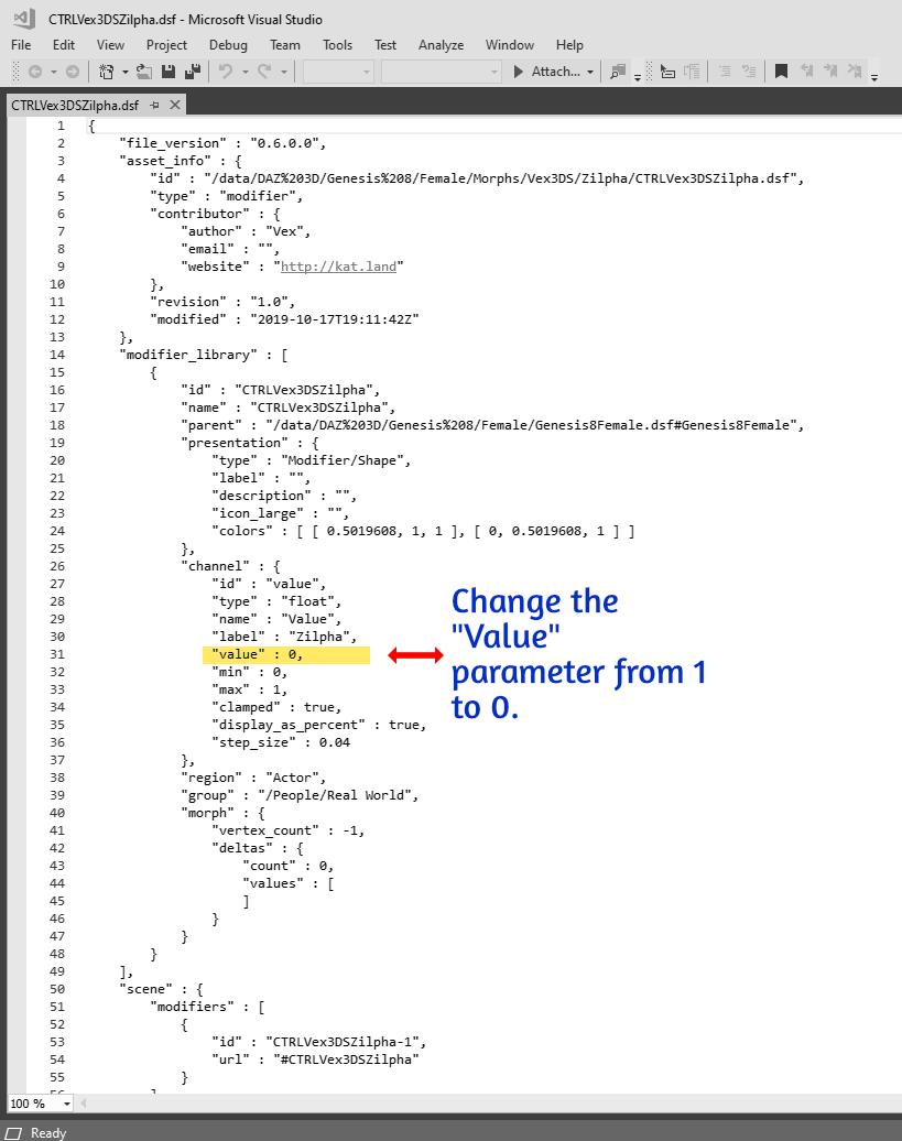

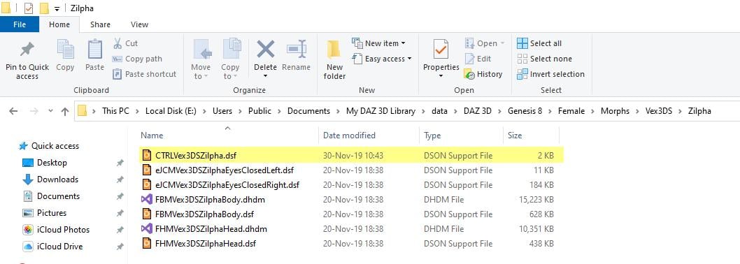

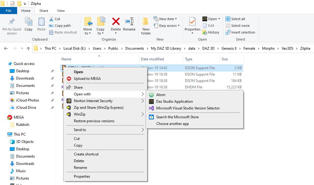

    Using Catherine3678ab's comment above, I went into the data file and changed the value from 1 to 0 and it fixed it.  Here are the steps I used and which file needed to be changed if others want to give it a try.  I have MS Visual Studio 2017 installed, which I used to open the data file, you may have another app that can open it.  Here were the steps (note, I have my Daz library on my E drive).
    Step 1 - Locate the file name CTRLVex3DSZilpha.dsf, it should be located in the folder C:\Users\Public\Documents\My DAZ 3D Library\data\DAZ 3D\Genesis 8\Female\Morphs\Vex3DS\Zilpha, if you have your content loaded in the default location on your C drive.
    Step 2 - Open file with MS Visual Studio (or other app)
    Step 3 - Change the "Value" parameter from 1 to 0 and save the file.  In the image, I have already changed the value to 0.
    Close out the app and open Daz Studio and load a G8F figure or open a prior scene with a G8F figure where you noticed this morph being used and go to the shaping tab, select the people parameter and scroll down to Zilpha, the slider should now be at 0.
    Hope this helps.  Many thanks to Catherine3678ab for the tip.

    Thank you @Catherine3678ab for the tip and @Sisyphus1977 for the walkthrough!
    For those who may not know you can open the duf file with wordpad.
