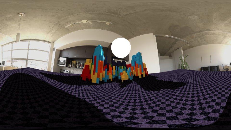

    here's a test
    i  downloaded 6Kx3K equirectangular exr images from http://www.cgchannel.com/2015/06/download-six-free-high-resolution-interior-hdris/
    then i ran a batch file to use imagemagick freeware command-line utility to convert it to .pfm
    c:\imagemagick\convert "I:/IBL/__MACOSX/canada_montreal_loft_max_sunny.exr" "I:/IBL/__MACOSX/test1.pfm"
    then i applied this pfm image as an environment for iRay renderer
    for unknown reasons it was upside down
    so i rotated the environment around the X axis by 180 degrees
    and we can see the image is valid, i reduced luminosity from 2 to 1

    ... and if i try using the mcjdenoise script to process the exr file ... imagemagick produces the little endian pfm file, the the intel denoise utility accepts it, starts denoising it 0%...3%...6%... and it freeze-crashes my pc
    900 x 540 - 229K

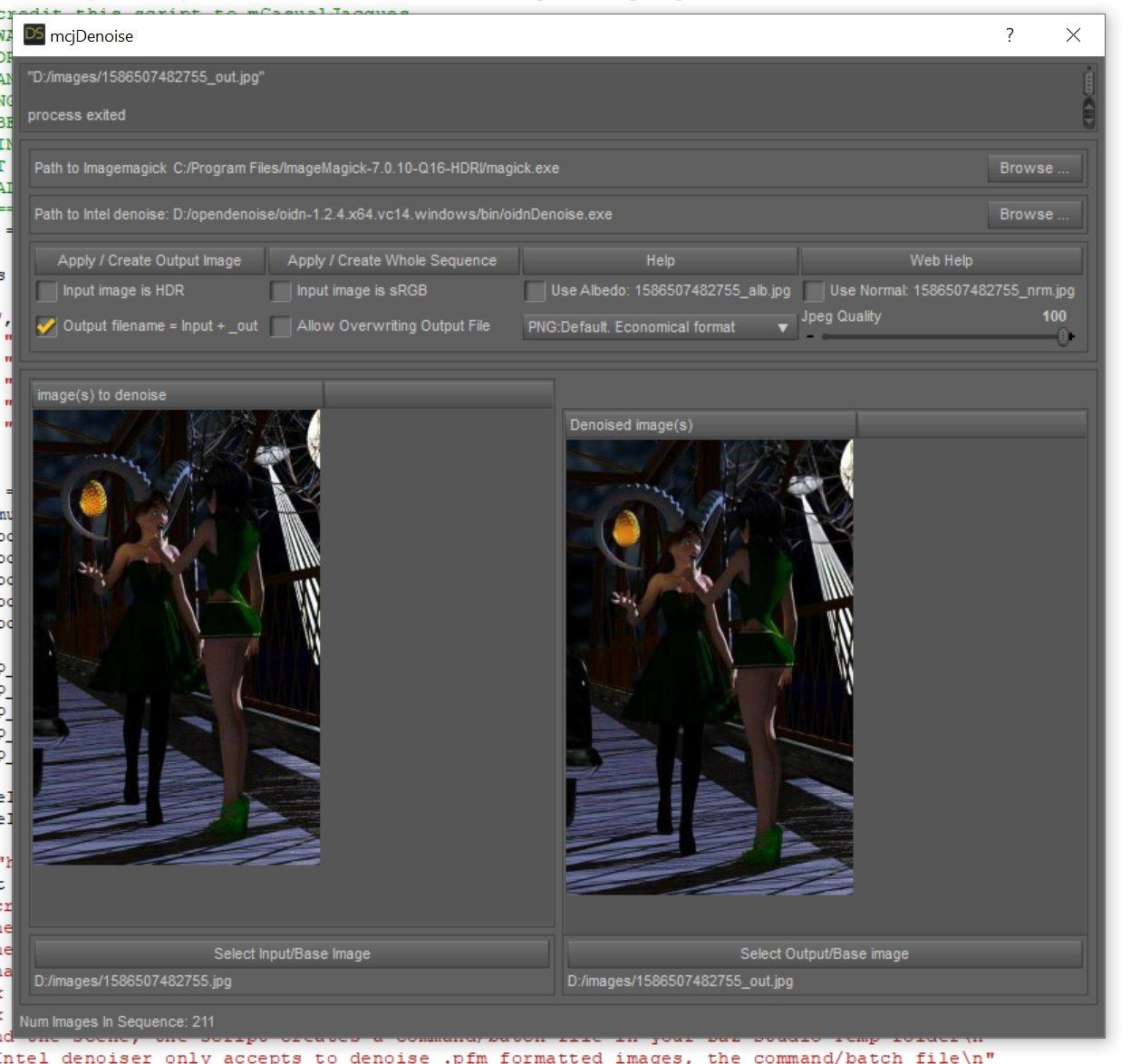

    as you may know you can get a daz script that uses the power of Intel's Open Denoise utility to denoise images rendered by renderers like Daz Iray
    https://sites.google.com/site/mcasualsdazscripts9/mcjdenoise
    but when using the old versions of the Intel denoiser  ( v0.9?) to denoise big images like 6000x3000 pixels, you may run out of memory and your PC may freeze ( it did for me )
    but version 1.0 of the denoiser will make it less likely ( it did for me )
    https://openimagedenoise.github.io/downloads.html

    come to think of it, since you said you cant select the exe ... it may mean you did not download the intel denoiser for Mac but instead the one for PCs
    thank you - i installed the binary package for mac, no exe files
  • mCasualmCasual Posts: 4,607
    ok now i see the 3 binaries are grayed outr and cant be selected
    they are maked as Unix Executable files
    so i google "cant select unix ececutable files"
    Son of the Raven said:
    ok i found the solution
    in the script, which you can open in a notepad or in the daz script IDE tab
    if you search for the 2 lines that read
    "exe Files (*.exe)"
    you replace this with
    "Any File"
    and the mac will now let you click on the denoiser oidnDenoise
    i will update the version on my web site in the next mninutes
    ( though this takes longer with the new web page format that gopogle forced us to adopt )

    new for 2021 - Mac Compatibility
    January 19th 2021 15:15 the file type for imagemagick and Intel Open Denoise was changed from (*.exe) to "Any File" for MAC issues with opendenoise which is extensionless
    "exe Files (*.exe)"
    "Any File"
    Right on, thank you. I changed the lines in the script (used TextEdit), will check it when my current renders are done (or after I sleep).
    Post edited by Son of the Raven on
  • Son of the RavenSon of the Raven Posts: 119
    edited January 2021
    "exe Files (*.exe)"
    "Any File"
    That worked to let me select the binaries, but I'm getting the message "Could not start the process" when clicking on Apply/Create Output Image. The binaries selected are "magick" and "oidnDenoise"
     i'll see if i can fix this
