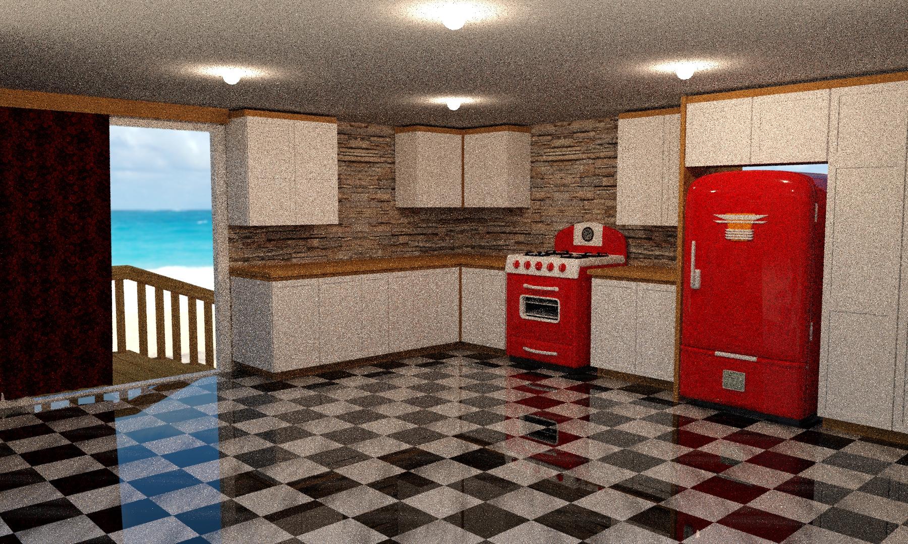

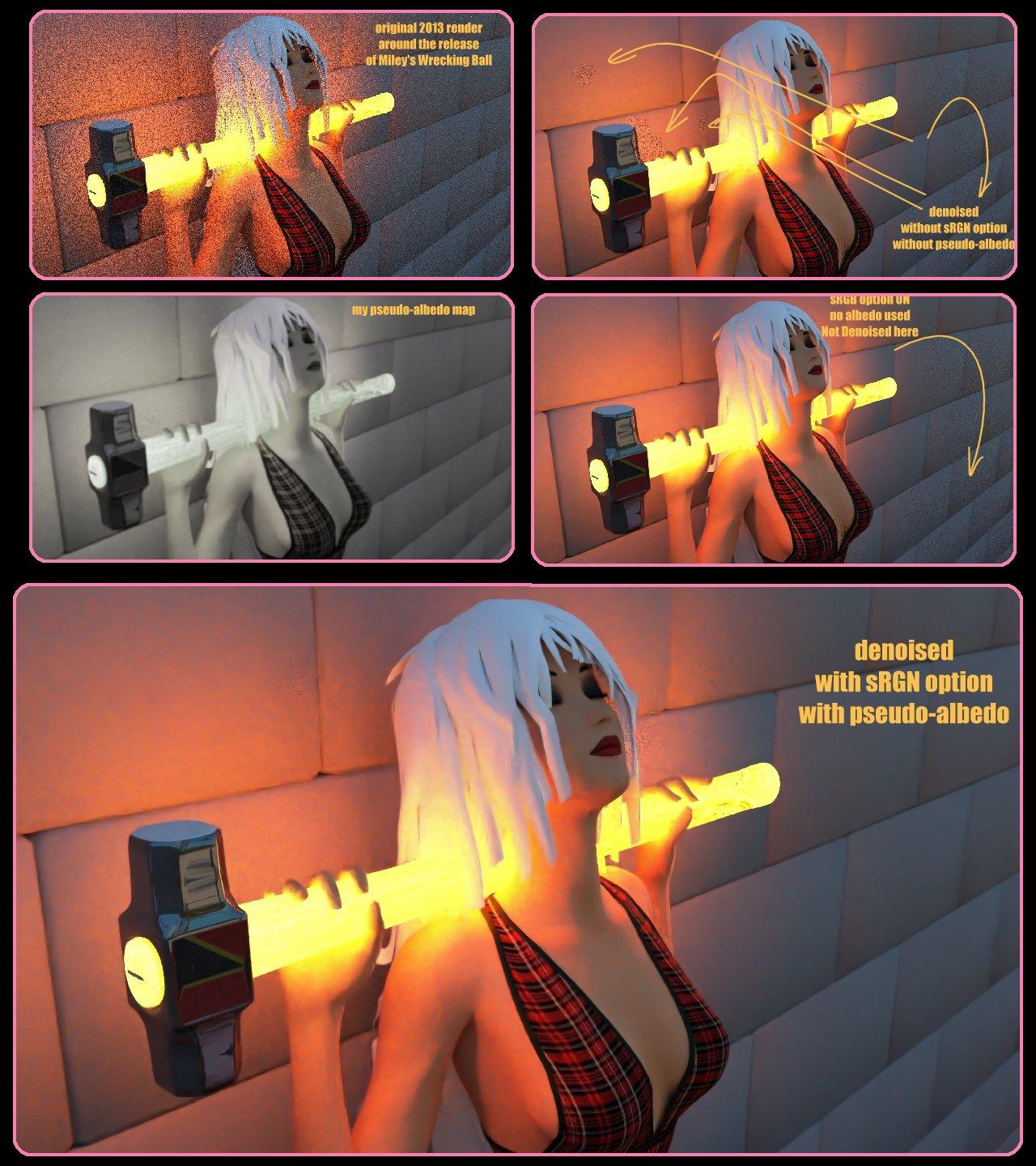

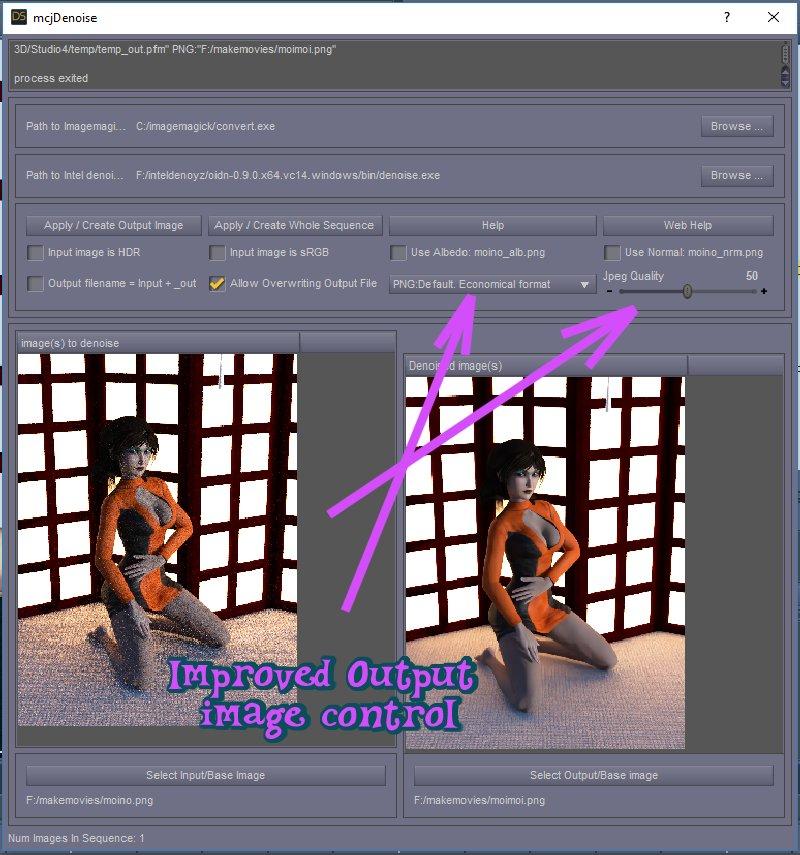

so it's a front-end for Intel Open Denoiser and Imagemagick-convert
it can process one image or a sequence of numbered images ( videos! )
https://sites.google.com/site/mcasualsdazscripts9/mcjdenoise
new for 2021 - Mac Compatibility
January 19th 2021 15:15 the file type for imagemagick and Intel Open Denoise was changed from (*.exe) to "Any File" for MAC issues with opendenoise which is extensionless
January 21st 2021 mcjDenoise2021ForMacs
there's a new version of mcjDenoise, my Daz Script that lets you use Intel Open Denoise to A.I.-Denoise your renders, for now i only have an antique macbook so apparently i cant run openDenoise, but your modern macs should , there's also the version for PCs https://sites.google.com/site/mcasualsdazscripts9/mcjdenoise
i had to figure out the not-well-documented execute-permissions of Daz Scripts, then use the .command extension then avoid quotation marks when running that .command file

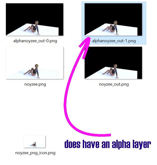

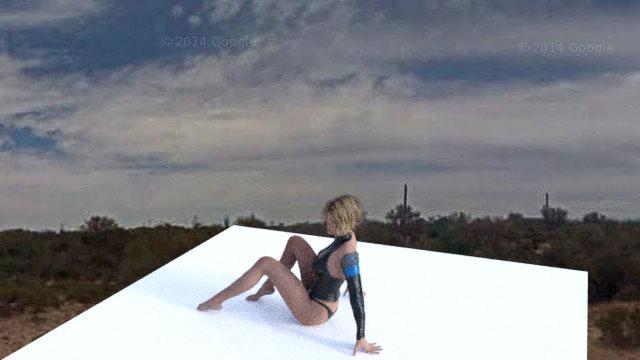

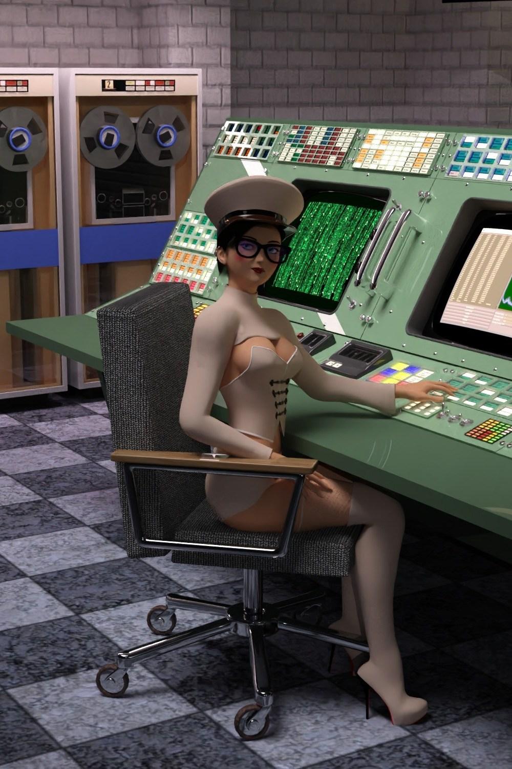

    UPDATE - DEBUGGED - UPDATE - DEBUGGED - UPDATE - DEBUGGED -
    ________________________________________________________________________
    Version History
    June 21st 2019 7:00AM - Release
    JUN 21, 2019, 11:49 AM - V2 - CORRECTED A BUG PREVENTED THE PROGRAM FROM STARTING
    Sure is worth the trouble wouldnt you say?

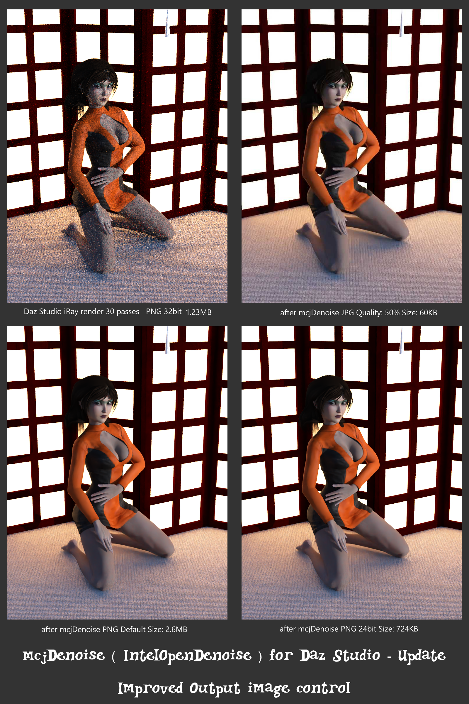

    Version 3 has a new time saving option
    https://www.deviantart.com/mcasual/art/version-3-of-mcjDenoise-802746178
    version 3 of mcjDenoise can auto-name the output image
    so if input noisy image is c:\pics\InspectorGabrielleIsNotAmused.jpg, the output file will be named c:\pics\InspectorGabrielleIsNotAmused_out.jpg
    baaaaad facebook for overcompressing images

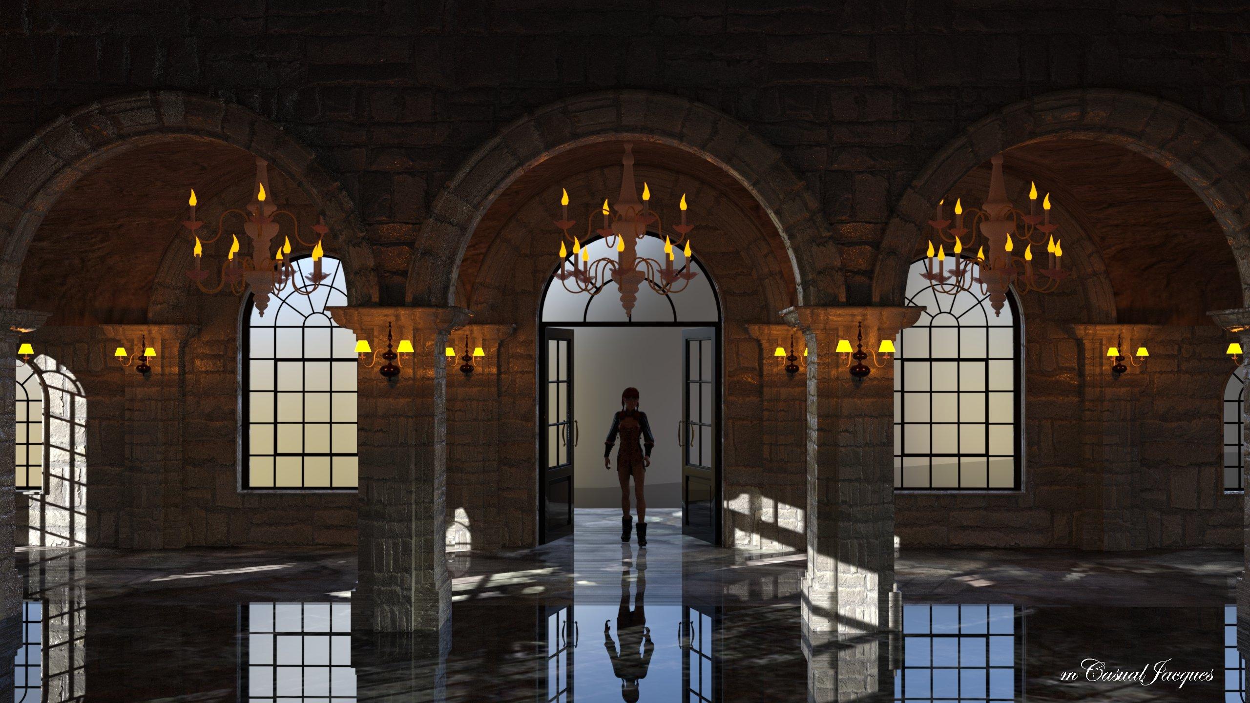

    10 iRay render passes then denoised using mcjDenoise ( Intel Open Denoise ) https://sites.google.com/site/mcasualsdazscripts9/mcjdenoise

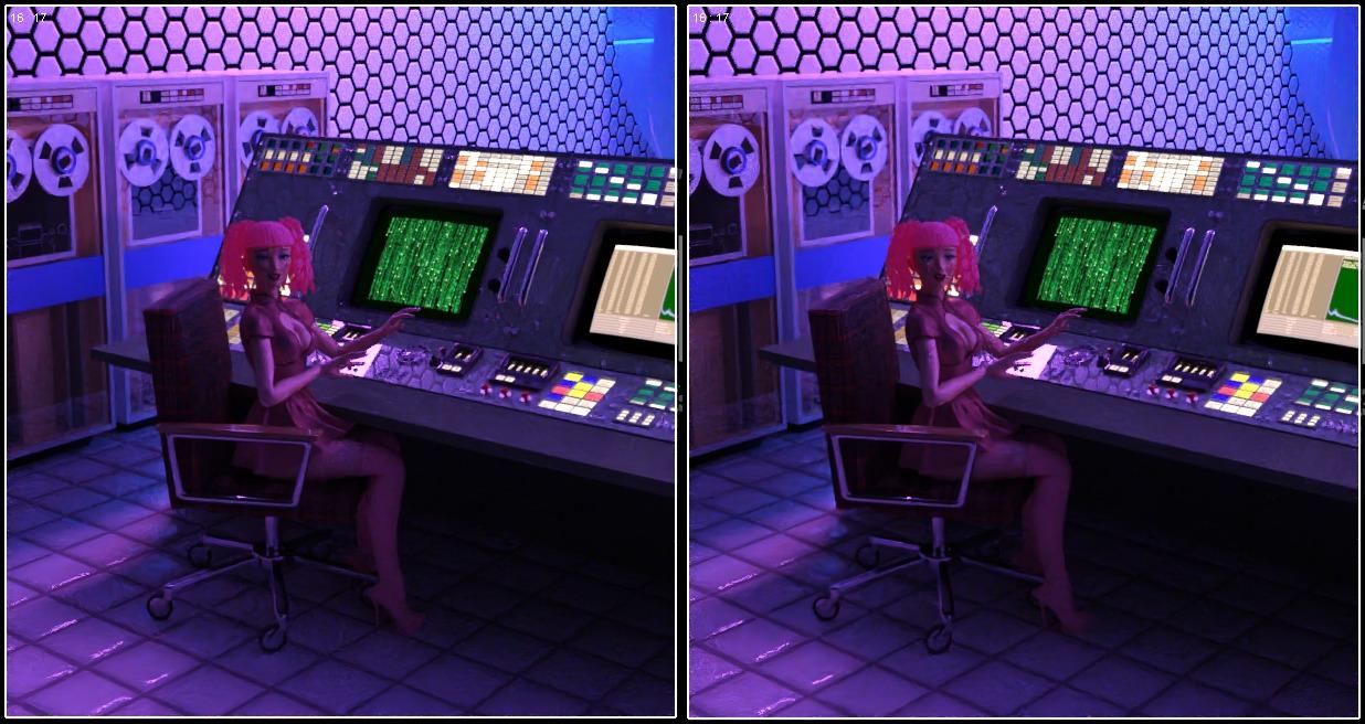

    everything but the kitchen sink
    222 iRay passes + intel open denoise

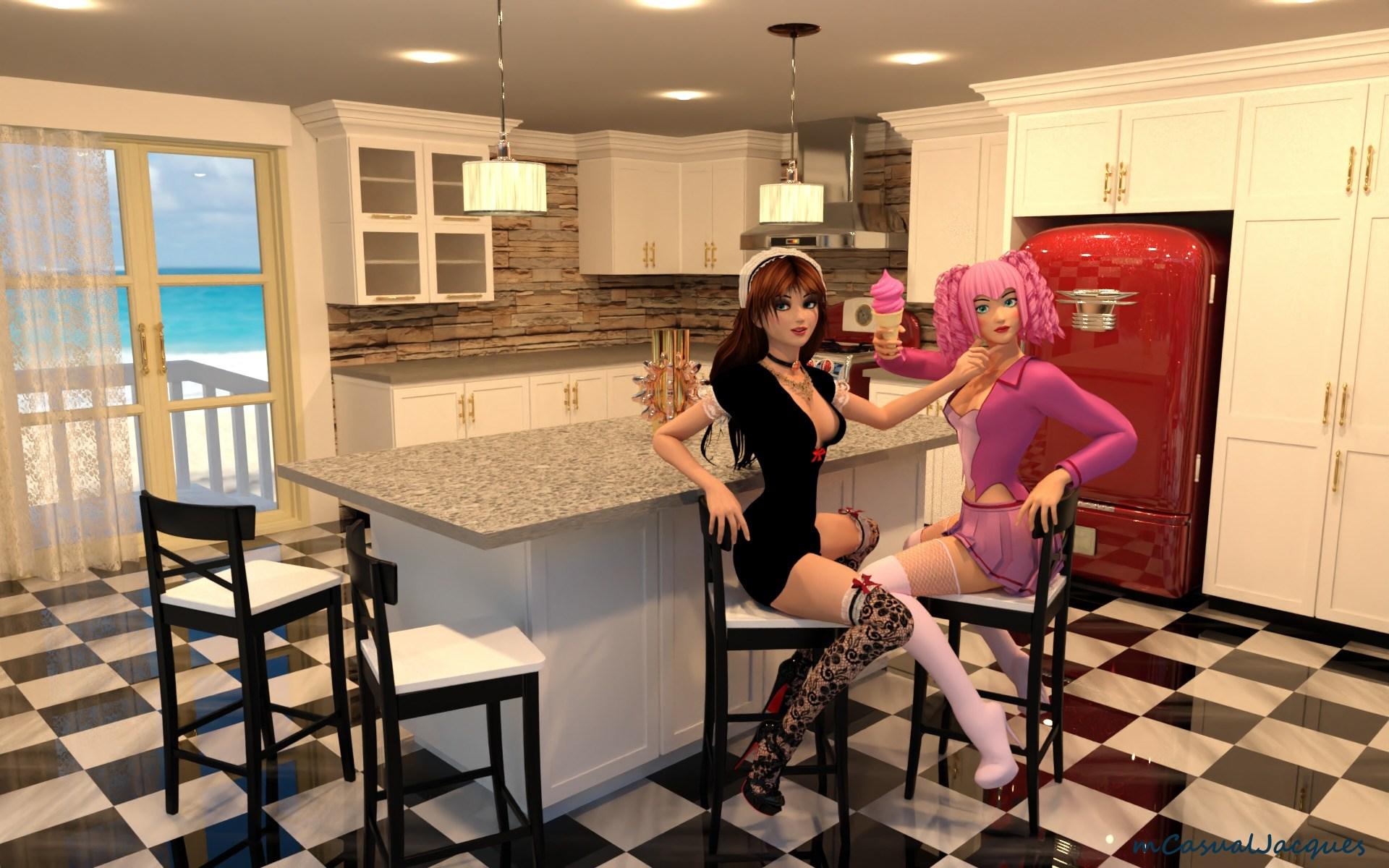

    The virtues of cherry ice cream crystals
    Peachy finds it cute that Gabrielle thinks the "cherry ice cream crystals" can "activate her DNA" and generate "3D body upgrades". Well it's cute but it's also true.
    (240 spp + mcjDenoise )

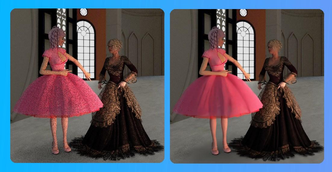

  • JackyBrownJackyBrown Posts: 585
    edited June 2019

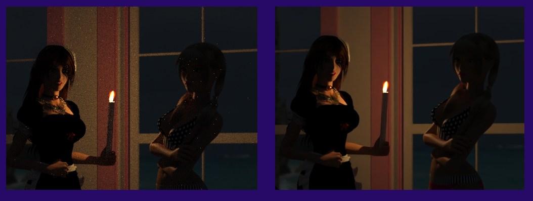

    Had a little trouble to get it working, but it was worth the effort... it works like magic! Thank you very very much! This is soooooooo useful!
    Before                                                                                      After
