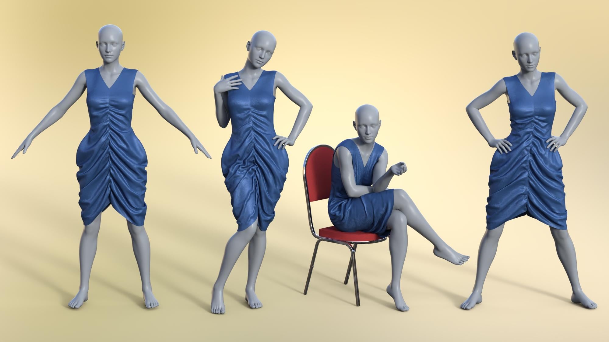

    I did my first Marvelous Designer autofit, where I took a garment provided by MD for their avatar and autofit it to G8F in MD 10. The I exported it to OBJ and brought it into Daz Studio. I ran transfer utility and added dForce. On the left is the dress without any dForce on the basic G8F. The other three are G8F in various poses with dForce on the dress.
    This is a pretty simple garment - no sleeves, collar, cuffs, buttons or zippers, etc. The MD autofit worked pretty well on this.
