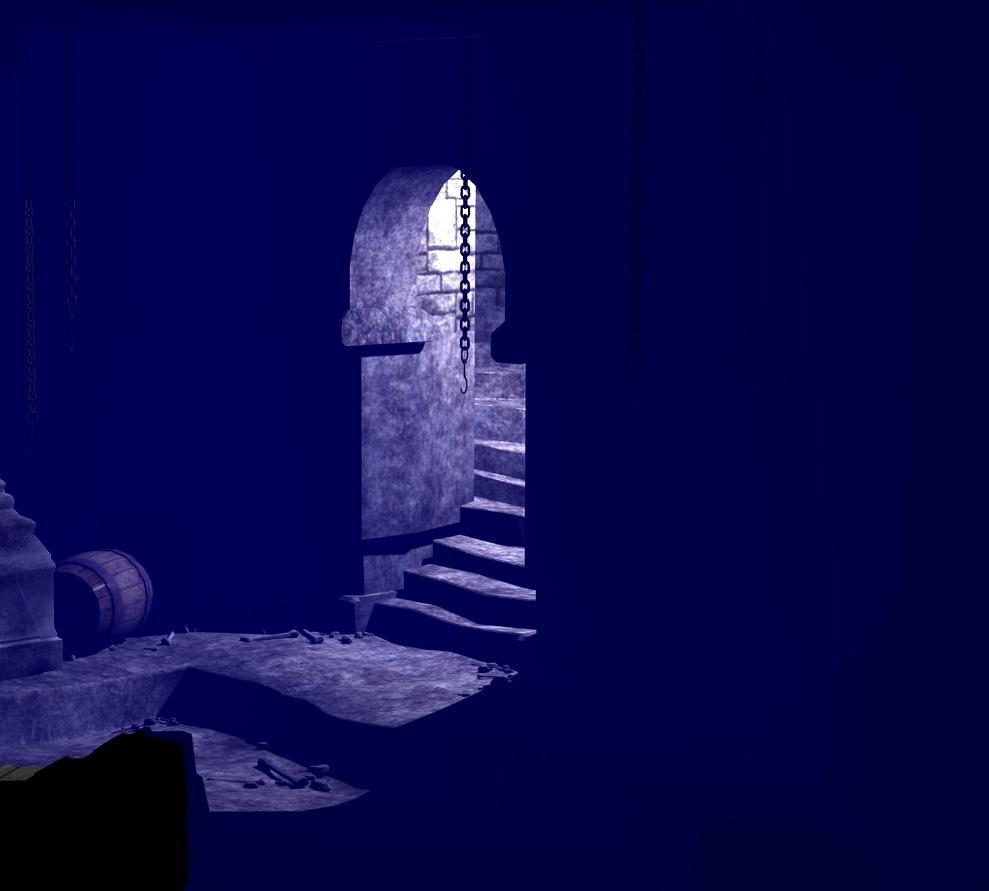

ShaderMixer, light/atmosphere interaction - how to do it ?
3dcheapskate3dcheapskate Posts: 2,728

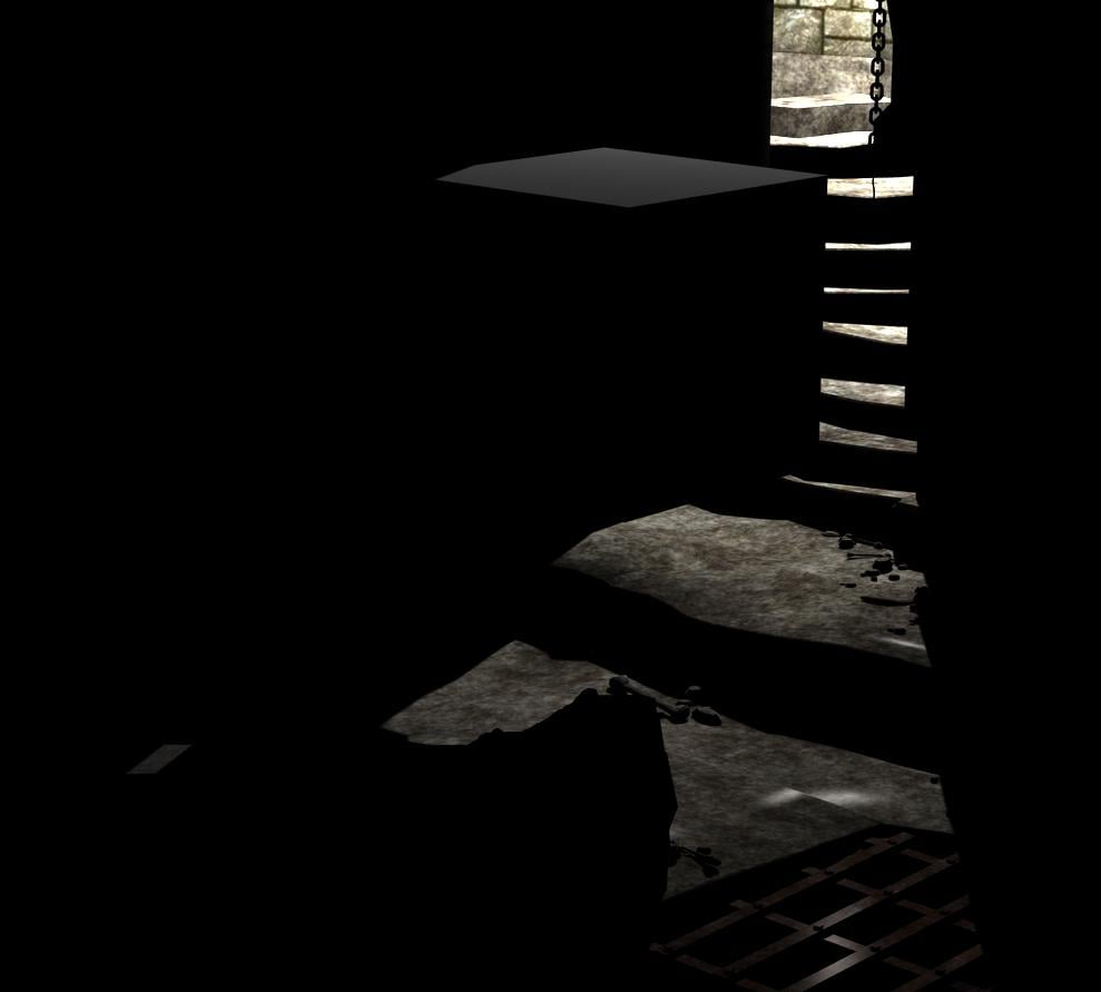

I've got a simple setup - a scene with a single point light (a simple DIY ShaderMixer one that I just knocked up) and a ShaderMixer camera with a Simple Fog* volume effect (ditto).
My guess is that I somehow need to make the Light Density input of the Smoke* brick dependent on the actual light. But I have no idea how to do that.
(The last time I looked at ShaderMixer was way back in 2013)

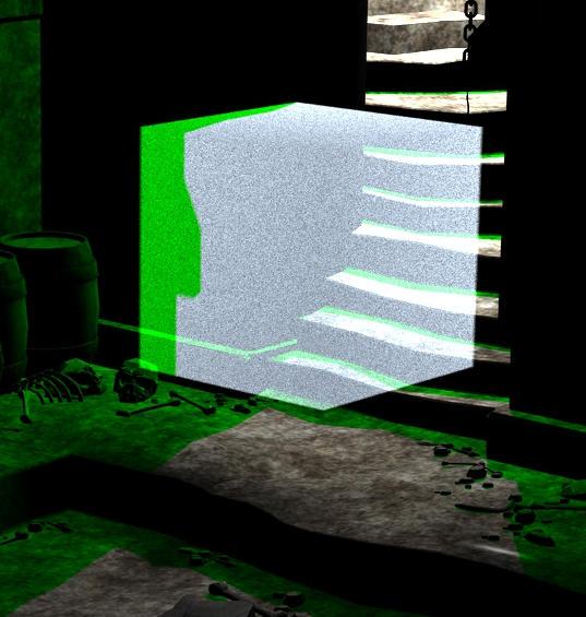

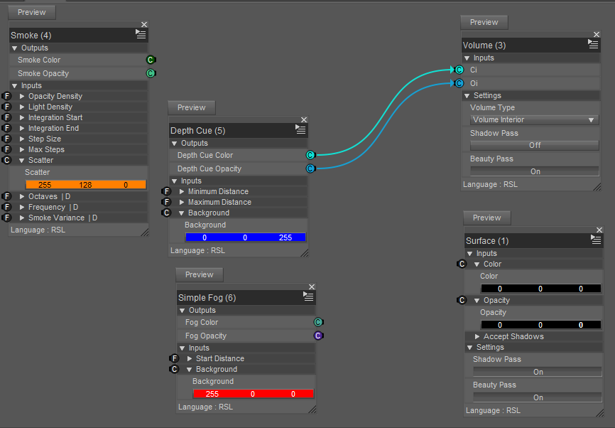

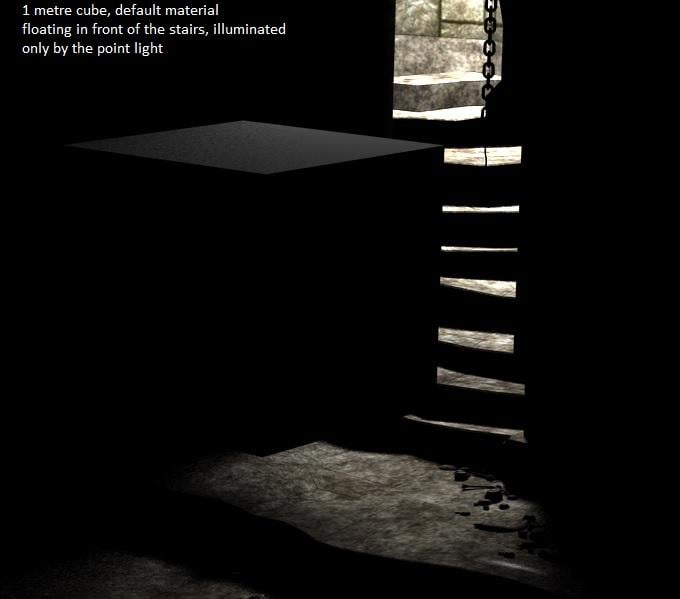

    As a test I tried adding a 1 metre cube to the scene, and used an ordinary point light and an ordinary camera. Here it is with default materials, i.e. a bog standard solid grey cube (note: I was actually still using my DIY point light with blur for this render. I changed that for the rest of the renders)

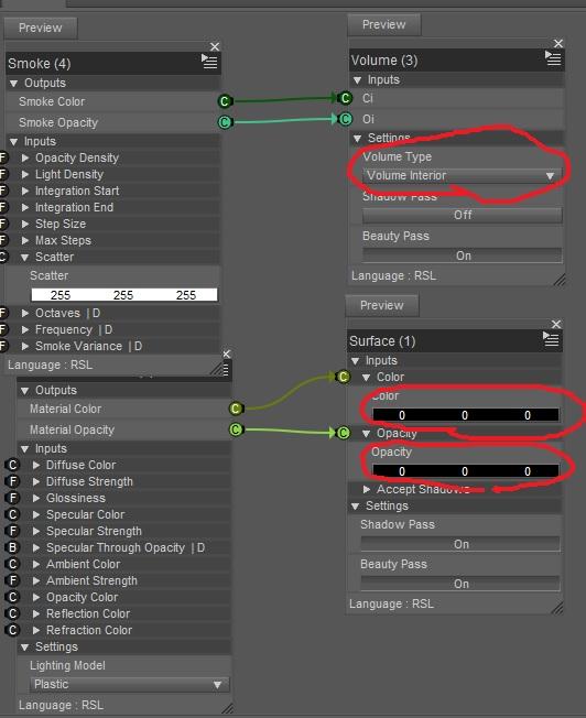

    The Volume brick (root) page of the online documentation luckily explains how to use a Volume brick for a standard material, i.e.:
    "In a material, it goes alongside the Surface root brick, and is not connected to it. You must also include a Surface Root with both Color and Opacity set to Black to create a volumetric effect in a Material."
    Unfortunately that's just about the only useful thing on the page.
    But the Smoke brick page shows how you simply plug a Smoke brick into a Volume brick, and mentions that "It can also be used to make a material shader that makes an object appear as a volume, using the “interior” option"
    So with fingers tightly crossed I simply add the Smoke and Volume bricks to the existing shader for the cube, leaving all settings at default values (except Volume Type and the Opacity/Color of the Surface brick)...
    ...hit the blue 'Apply' button bottom right of the ShaderMixer pane, and render...
    Hmmm...
    Buggerall difference
    If I use a Simple Fog or Depth Cue brick instead of the Smoke one I get exactly the same.
    If I scale up the cube so the point light is inside it but the camera's outside it just renders totally black.
    If I scale up the cube further so the camera's inside it as well then it renders as if the cube wasn't there,

    Probably a very stoopid question but did you remember to set opacity to 0 on the cube?
  • 3dcheapskate3dcheapskate Posts: 2,728
    edited November 2020
    laughyes
    In a roundabout way that was the problem !

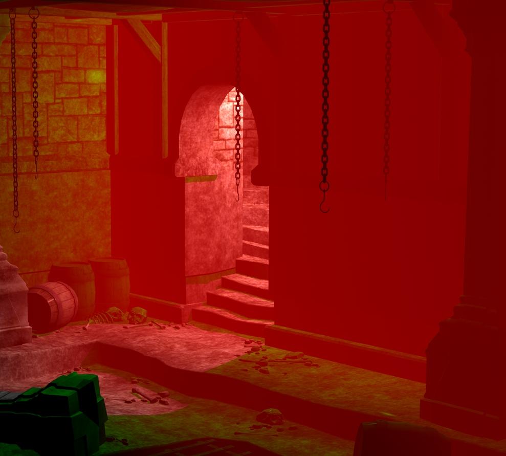

    Three new renders using (left to right) Simple Fog, Smoke, and Depth Cue bricks plugged into the Volume brick. (the green is the shadow colour - see comments at the end of this post)
    What I did was to look at the opacity values on the Surfaces tab of the cube. There was no Opacity Value, Just an Opacity Color, which was set to white. So I set it to black and rendered, and that did the trick. I then re-read the bit in the Volume brick documentation where it says "In a material, it goes alongside the Surface root brick, and is not connected to it. You must also include a Surface Root with both Color and Opacity set to Black to create a volumetric effect in a Material."
    Just a Surface brick, nothing about a DAZ Default Material that's usually plugged into a Surface brick. So I deleted it. Here's the resulting network (all three volume-driving bricks are shown, although only one is used at a time)
    (N.B. The green colour in the renders is the Shadow Colour of the point light on the staircase, which would usually be set to black, but I wanted to be able to see how the volume and light/shadow were interacting.)
    To me it looks as if the Depth Cue totally ignores the shadow, which sort of makes sense, but that the other two are affected by the shadow. And with the Simple Fog I think I can make out the geometry of the cube, so positioning/orientation/size of the volume prop with respect to the camera may be important.
    More playing required.

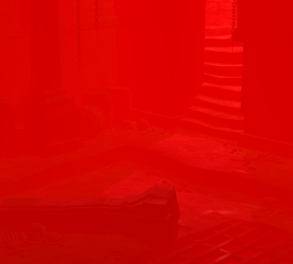

    Well, I'm getting nowhere with this.

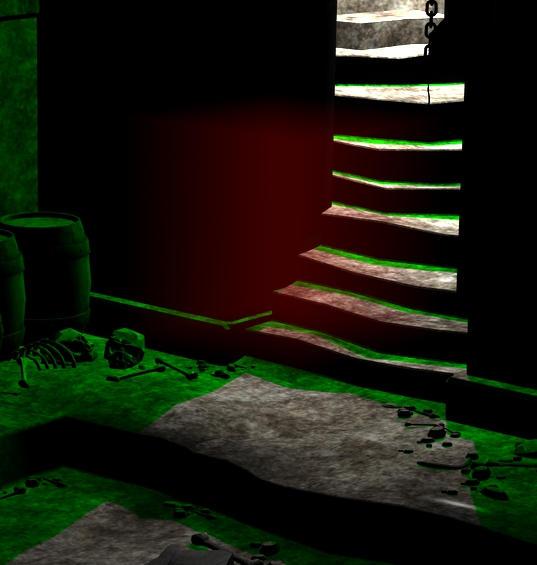

    First I tried expanding the cube so both camera, light and scene were inside it. So the cubes just an ordinary box and everythings inside it. Here's the render - as expected. Green is the Shadow Color of the DS point light.
    I then applied the same volume shader as before to the cub, with a red Simple Fog
    Tried with the Smoke and Depth Cue. Same sort of thing..
    Move the cube so the light was inside but the camera outside. Same thing.
    Moved the cube again so th light was outside and the camera inside. Same thing

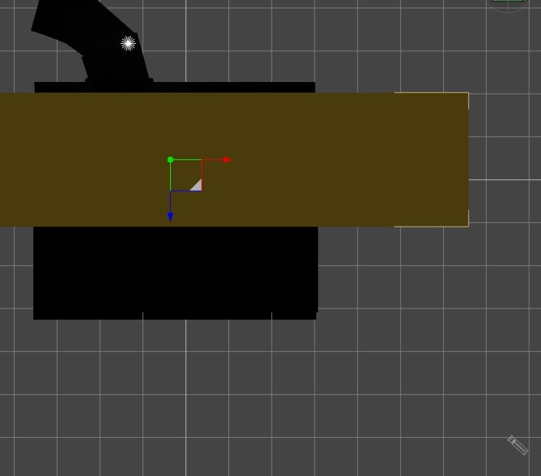

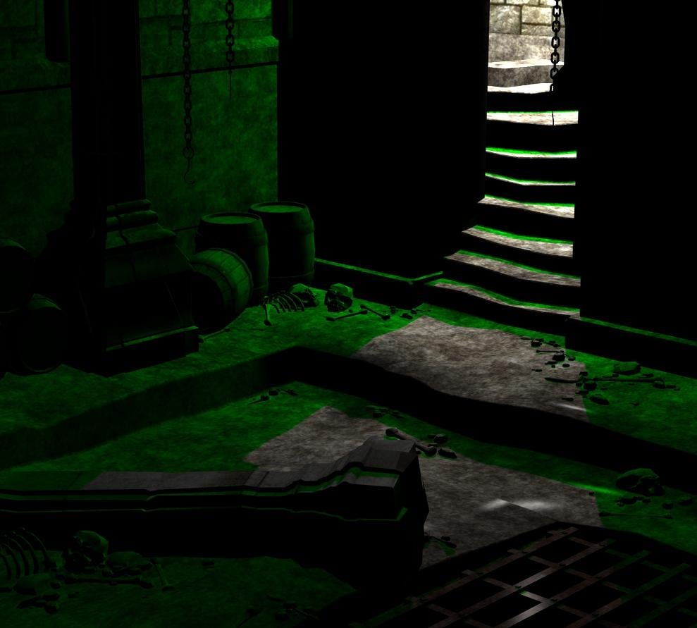

    Then I changed the setup slightly so that the camera is in shadow - here's the top view. The brown rectangle is the stretched cube with the volume shader applied. Point light top left, camera bottom right.
    Same shader as my last but one post applied to the cube, i.e.
    Left to rignt below - Simple Fog, Smoke, and Depth Cue. The green is the Shadow Colour of the DS point light. The front face of the cube cuts through the fallen pillar bottom left of the renders.

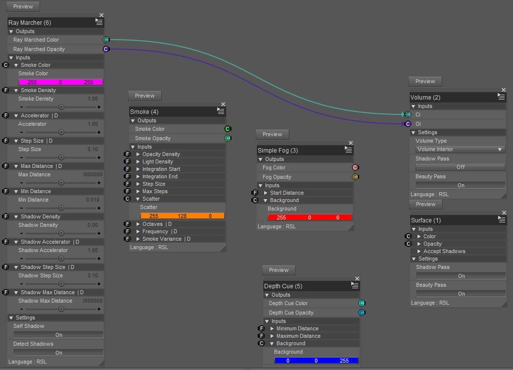

    It's the last image on the Smoke page , under the "In a material" heading, that gives me hope, because there seems to be a shadow within the volume under spuggles right arm.

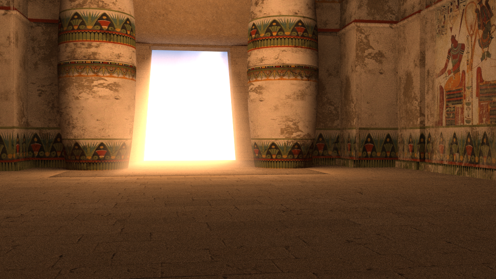

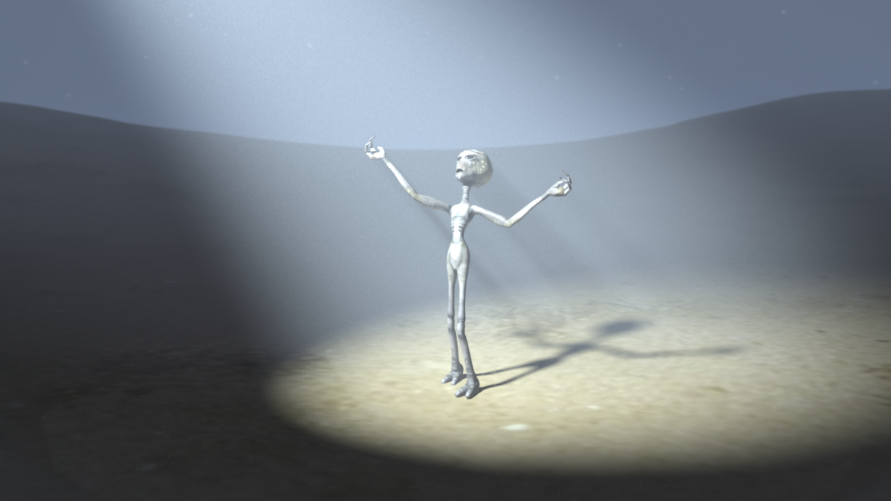

    And just in case it isn't clear, this is the sort of effect I'm trying to get (Poser render with the built-in Poser atmosphere)...

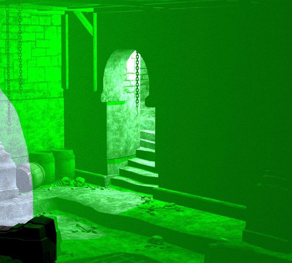

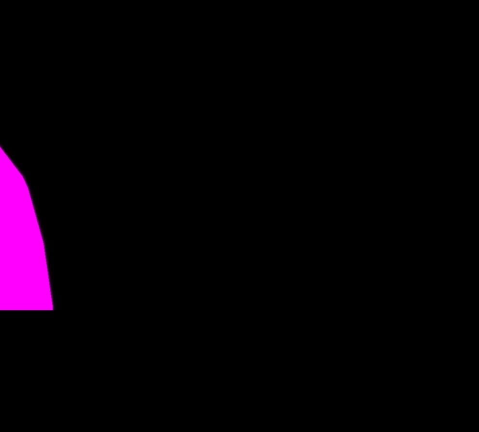

    Ray Marcher using default settings, except Smoke Color set to pink.
    I cancelled the render after about half an hour because I can see it's not going anywhere (the horizontal line at the bottom of the pink arch is as far down as it had got)
    No idea what to try next. Do I try adjusting parameters ? Do I need extra bricks ? Do I just give up again ?

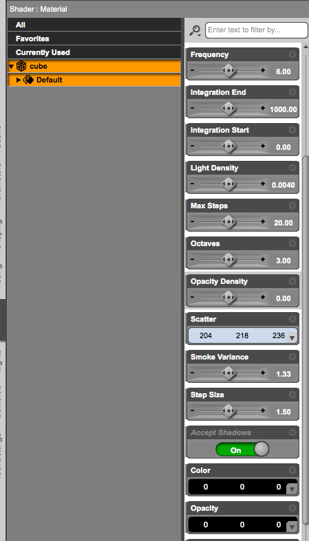

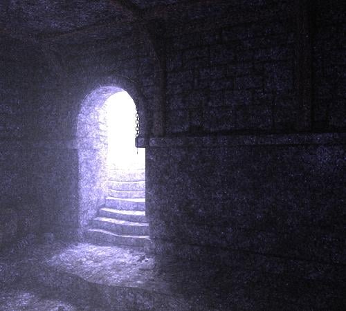

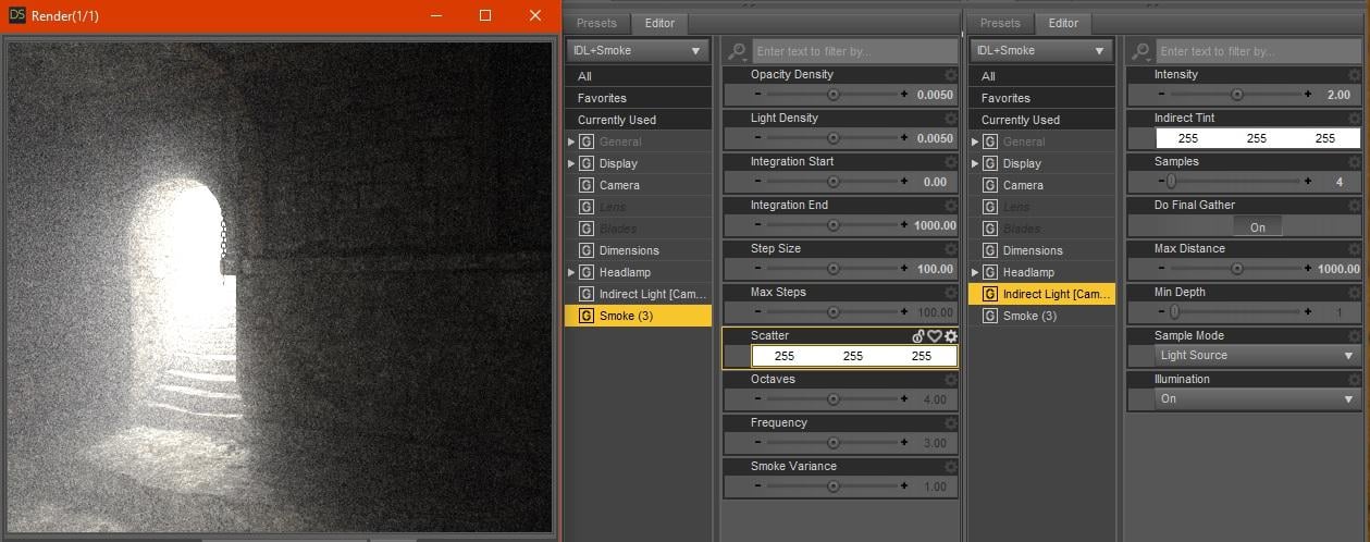

    Well I have it working now, using the smoke brick and shadow pass on for the volume. It just takes some fiddling around with integration start/end and light/opacity density. But it is slooowlaugh. I'll try to clean up the shader a bit and do some more testing before posting my settings. Meanwhile, try using very low numbers for the opacity and light density, such as 0.001-0.01.
    yeslaugh.
    Thanks, that helps a lot !
    I'm getting somewhere now - not very good but it's actually giving me a volume effect for the first time (I think I had densitys rather high for thia one)
    It seems that render speed depends mainly on this:
    (Integration End - Integration Start) / Step Size
    The smaller the value the faster the render (but the lower the volume effect quality), and vice versa.
    I used start = 0, end = 1000, step = 100 for the attached, which took just 20 seconds to render.

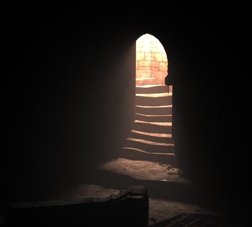

    Also just tried it alongside my crappy DIY point light as per the OP -
    Yes ! I now have a point light with soft shadows, and atmospheric fog.
    Two 20 second renders, with only the Opacity/Light Density settings changed, both within your suggested 0.001 to 0.01 range. integration/step stuff as per my previous post. Scene changed slightly - camera moved and cube stretched to include part of the stairway.
    Lots more work required, and I'm awaiting your results/settings with great interest.

    Here I used a single distant (sun)light, a volume cube and an indirect light camera for ambient light. Got a bit of grain on the floor, upping the indirect light samples to 128 would probably fix that. And the indirect light intensity is probably a tad over the top, keeping it at the default 1 would have been more physically plausible.
    The volume settings used:
    Apparently setting opacity density to 0 makes it render a bit quicker, you can replace the fog effect lost (in areas not directly lit) using a simple fog camera.
    The Indirect Light camera settings:
    IL max distance was at the default 1000000;)
    Post edited by Sven Dullah on
    edited December 2020
    ...and testing creating a light beam using a spotlight...(Beam me up to the mothership LOL)
    I found out that including the default surface in the volume shader makes it possible to set visibility for the viewport using opacity color and ambient strength/color. Just need to remember to zero them out before hitting render:)
    And here's how I set up the Indirect Light - Fog camera:

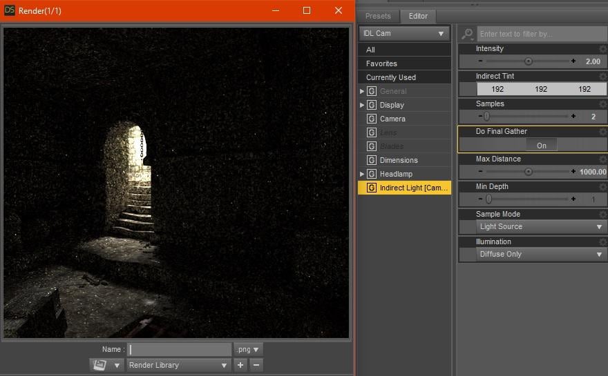

    Just added an IDL camera (just an Indirect Light (Camera) root brick, nothing else) and twiddled a few things to speed up the render - ended up with Samples=2, Max Distance=1000, and Illumination=Diffuse only. Also added a large wall out of camera frame to give something for the IDL to bounce back from.
    I absolutely LOVE the graininess of the image in the bits that were just black before ! To me that's similar to the way things actually look if you try and look at things in the shadows...
    (on my main monitor all I see in the shadow is a few random bright pixels, but on the built-in laptop monitor I see a distinct grainy image of the walls of the room)
    500x450, 22 second render.
    I played with the Intensity and Indirect Tint to try and brighten the shadowed parts while keeping the really bright spots to a minimum, and came up with this, which I really love too...
    880 x 545 - 131K
    733 x 452 - 136K
    Post edited by 3dcheapskate on
    laugh
    laughlaugh
    And if I create a camera with both Smoke and Indirect Light and use the sttings I had before which gave me quick renders, I get this rather grainy result, but it's definitely working nicely.
    Only 1m45s to render 500x450
    I accidentally did a render with everything the same as above except Step Size =25 instead of 100, Opacity/Light Densities both lower, and Smoke Color different.
    Took a bit longer - 3m45
    1259 x 498 - 204K
    500 x 450 - 191K
