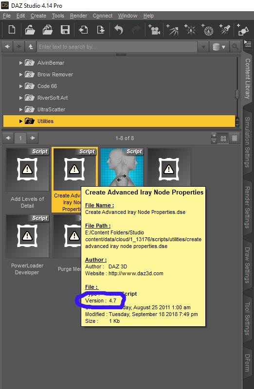

  • I also have an error on startup :(  , in daz 4.10  and  daz 4. 14
    875 x 1076 - 61K

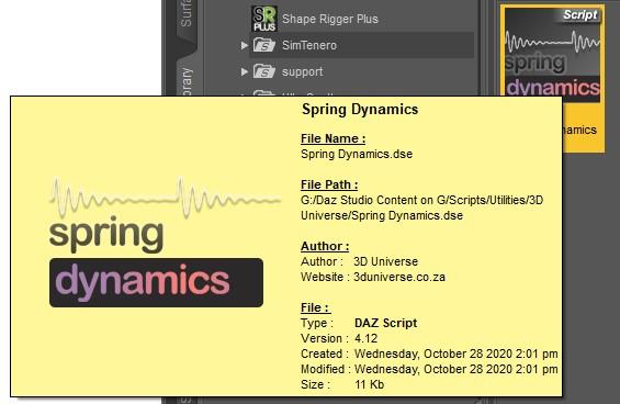

    Sorry, you said you were using that version but I didn't realise it was the script version too. To be clear, I am asking about this (for the Spring Dynamics script)
    522 x 800 - 220K
  • nowefgnowefg Posts: 557
    Ah! I don't use Tootips, to limit the amount of stray info that pops up when I'm working, Turned it on, though, image attached, but It doesn't specify a version.
    It's whatever version was offered for sale the morning it was posted, and then redownloaded the following day...
    735 x 1371 - 100K
    I thought DS would show the script version even if it was higher than the DS version - I would now be somewhat inclined to suspect a corrupt installation
    Yours looks different than what I'm seeing. This is the tooltip I see:
    I think Richard is probably right about a corrupted installation. You may try uninstalling and then redownloading it.
    565 x 368 - 45K
    Post edited by 3Diva on
    Lindsey said:
    I downloaded both the manual and DIM installer and both .zip files are identical in content.  It's just a script do I don't image it would matter where you installed the script within the DAZ Studio Formats library.
    FYI - If you launch the script with nothing selected a message box appears as shown in the attached pic.
    whfield said:
    Good Day,
    I installed through DIM.  My Daz Studio is 4.12.0.86.  My tool tip does not show a version number.  Steps taken:
    1.  Download through DIM -- Failed to work and uninstalled.
    2.  Download through DIM a second time to the "Recommended Location" by DIM -- Failed to work and uninstalled.
    3.  Downloaded Zip for Manual installation -- Failed to work and uninstalled.
    4.  Downloaded from DIM a third time to check for version number.  Tool tips did not show a version # only date of creation and date of modification for the file.
    5.  Attempted to use it on a base figure -- still failed to work:
    I have not had a script behave like this.  Your assistance is appreciated.
    Curioser and curiouser.... I don't like to see other customers, including DIM users, having similar malfunction issues with Spring Dynamics, but it is good to know it's not just me.
    Sort of...
    If I was the only one the product won't work for, I could just go refund now. As it stands, it seems worth a little longer wait, to see what, if anything, can be done to rectify the problem. I have twenty-plus dollars tied up in this non-functioning product, which is about my high limit for single item purchases at Daz, but can wait one more day, to see if a fix happens.
