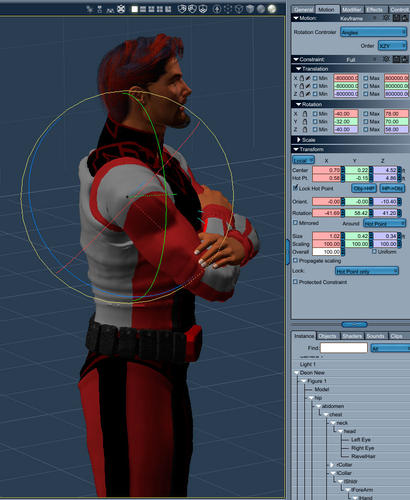

Hi, I've had this problem often on imported Daz characters such as Mike3 and Vicky3 in Carrara. After doing several rotational poses for the characters, the rotations start loosing their 90 perpendicular axes relative to each other.
Check this shoulder of this V3 character -- it is totally mangled. I cannot pose joints like this anymore!
Please, does anyone have and answer to this problem?

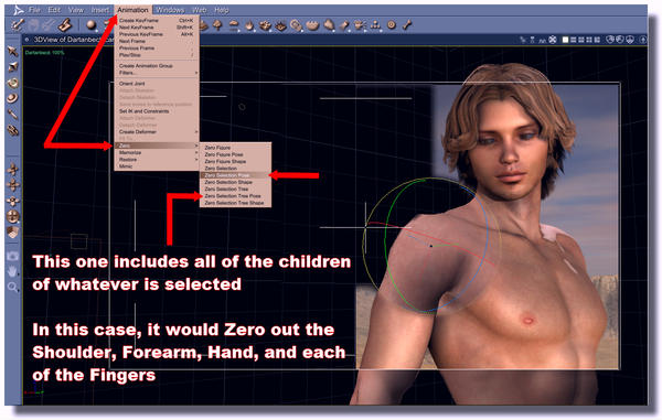

    Of course, there's also one of my favorite new menu items of Carrara 8.5, which is the new Zeroing options.
    This feature has become so handy for me that I felt lost whenever I worked in another version of Carrara, so I don't work in those versions anymore ;)
    The joint I have selected isn't all caterwonky, but I selected it just to show the menu.
    Notice that even though I don't have the actual figure selected, I can still zero it in several ways, right from here. More importantly, notice how I can choose to either zero what I have selected in pose or shape, but I can also do the same for any children of what I have selected as well.
    I do a lot of hand posing, where I actually rotate all of the joints by hand. This makes for a very fast way to set all of the fingers back to zero for a fresh, new pose.

    Geez, I don't know if I'm totally ignorant or plain stupid, but I cannot find the modifier you are referring to. If you look at this new screen grab (of yet another joint rotation gone wrong), could you point out in the Motion panel what exactly you are referring to?

    What he is suggesting is that you use the Universal Manipulator instead of the Rotate tool to rotate the joints.
