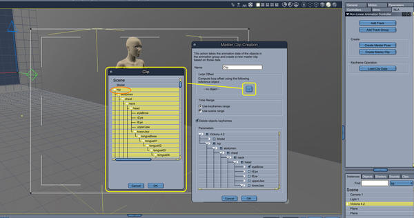

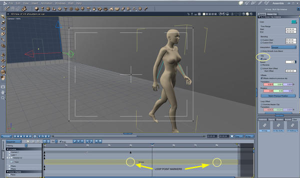

  • fis7157fis7157 Posts: 26
    CARRARA QUESTION... I'm using NLA walk cycles IM TRYING TO GET MY CHARACTER TO CONTINUE WALKING FORWARD when i loop the walk cycle it returns to the original staring point before starting the walk over and if i add a continuation clip to follow threw the motion it goes back to starting point before the next NLA clip.. My character is is doing the Micheal Jackson moon walk.. lol Help Plzzz..
  • DUDUDUDU Posts: 1,945
    edited April 2014
    Its often the keyframes of the hip make displacement, erase them and creates new a path for the whole character apart from the NLA.
    PS: if he don't want to move, select the top of the tree of the character and group it...
    Post edited by DUDU on
    Thanks deleting the hip track keeps the character animation from sliding back doing a funny moon walk BUT THE RIGHT LEG IS DOING A FUNNY KICK AND MY CHARACTER LOOKS WOBBLY PLZ HELP.. CARRARA CAN DO ALL THESE THING BUT A SIMPLE WALK IS SO DIFFICULT SMH..
  • 3DAGE3DAGE Posts: 3,315
    edited April 2014
    HI :)
    When you load in an animation as Key-frames,.. then you convert that to an NLA clip,. there's a Dialogue panel that pops up, which has several options on it. (see pic)
    You need to select a "Bone", so that Carrara can calculate how the animation will loop.
    Once you've loaded that NLA clip into the time-line,.. You need to set the "Loop" option in the NLA panel,. then click and drag, to stretch out the NLA clip in the time-line, for as many loops as you want
    you should see Loop point indicators to mark the end/start of each cycle.
    Pic 2
    Hope it helps :)
