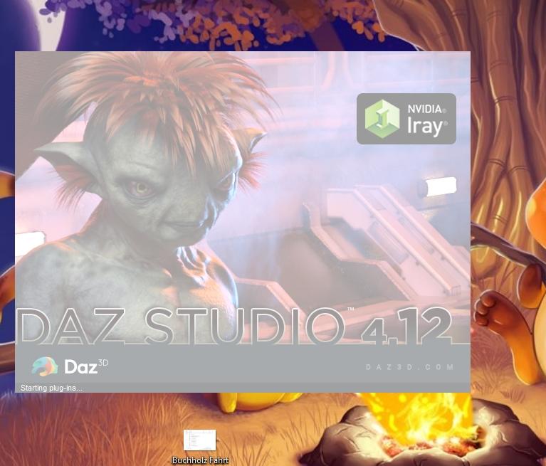

    @ManFriday for some reason, my Dazstudio does now freeze with the .dll's
    At this point.
    if I move the dll's out of my daz folder I can start it but... rip beta :(
    is there a logfile that explain this behavior so I can share it with you?
    It worked first great yesterday, but now its... broken.
    Would be good if we can find the bug.
    Update: my Backup Original .dll does still work.
    I introduced a bug in the latest beta that stopped it from working if more than one instance of Daz Studio was running. I have already found the cause and fixed it, I'll probably do another beta soon. Sorry about that!
  • LoonyLoony Posts: 1,817
    edited February 2020
    will try it.
    its weird, because from start does my studio not load a scene, so... its not part of a object who causes this.
    weird, can't delete it, because daz studio is using the rota dll O_o
    okay, now I could delete it, after killing the task.
    redownloading worked, maybe I just had to kill the buggy taskmanager instance who still was running, no idea...
    I am able to reproduce the bug, so barbult you can try it too :)
    I use for changing stuff in a scene a Subscene and then load just the 1-2 Props/people etc in a second daz studio, so I dont have to clear the complete scene, like just moving a figure into a new studio.
    That does work with the normal .dll
    With the Beta .dll this will cause a crash in the second studio, also after crashing and closing Studio 1 too, the second studio will stay up in the taskmanager details.
    there will be 1 left, even after closing all daz studios. And THAT will cause that no daz studio can't be open anymore.
    So the new plugin have a problem with multi instance, the old plugin not.
    @ManFriday if you need I can make a video, if you don't understand or can't follow my steps :)
    Edit: just saw there was a answer from you haha... the forum didnt showed it, thanks :)

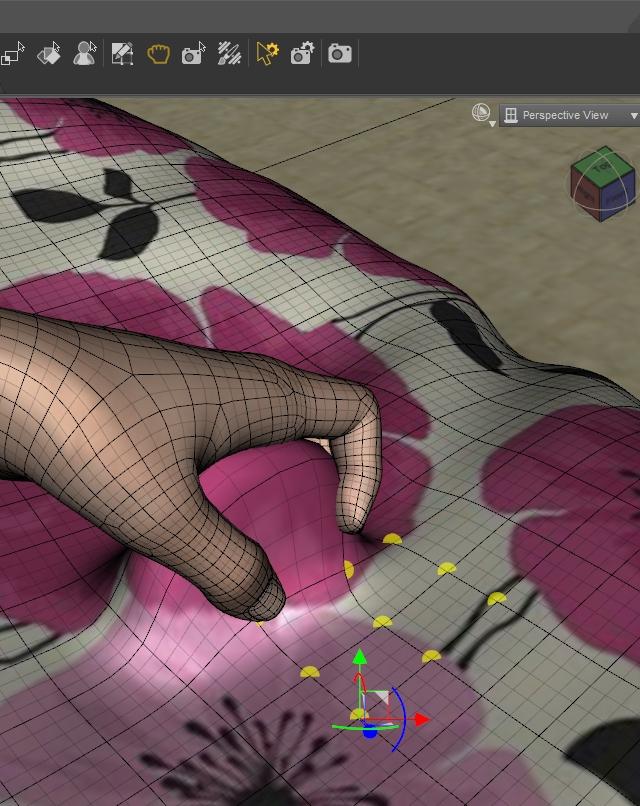

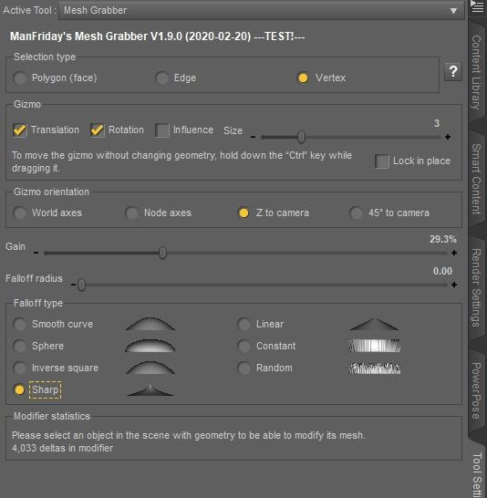

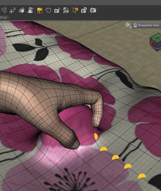

    I wanna make a grabbing from the blanket, and I tested it with my shirt^^... and I see grabbing make some kind of lines.
    (random google ref^^)
    but, when I select the lines with the geo and switch to the mesh grabber, it increase the points O_o
    I try to use the sharp tool.
    @barbult, yeah I had that problem too, thats why I use the geo editor, but it seems like... the grabber dont wanna use the geo vertex/edge...

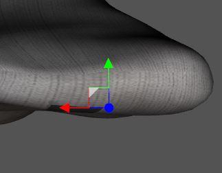

    MrDarck said:
    I flipped the camera more around and... *magic* the green arrow did now appear O_o...
    Maybe also a MeshGrabber bug?
    It seems like the green arrow re-appeared when the larger part of it moved above the seam on the frontside of the sock? Did you also try zooming out from the sock? Because, if it suddenly does re-appear when you do, it might be caused by the combination of transparency channels within the socks' textures and/or skin textures and of the channels used by the arrow itself. In which case it wouldn't necessarily be a Mesh Grabber problem, but rather something that might show up anywhere in Daz where such arrows (or other such control tools) are used. It wouldn't be a common problem, it needs specific circumstances to coincide, like here.
    Post edited by Drip on
