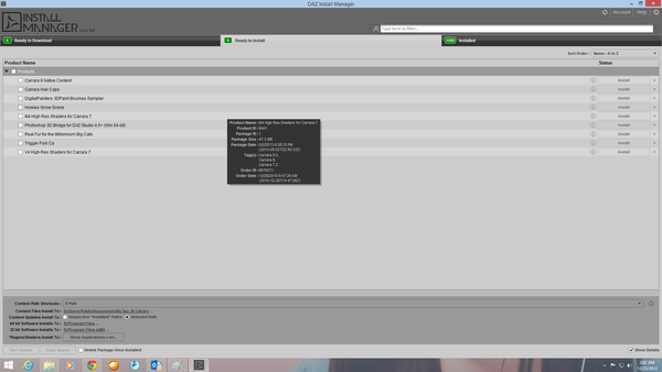

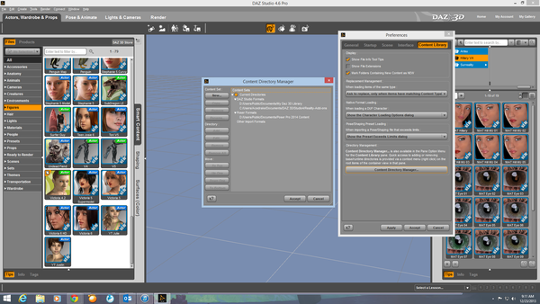

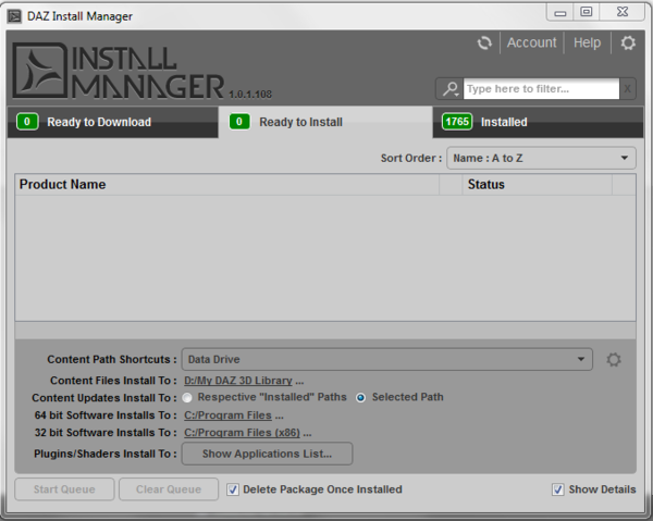

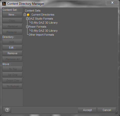

    Can you post these 2 screenshots: ...
    1) In DS, Edit > Preferences > Content Library > Content Directory Manager, expand the "DAZ Studio Formats" and "Poser Formats"
    2) In DIM, on Ready to Install tab check the "Show Details" box in the lower right
  • acedrakeacedrake Posts: 41
    Here they are, the screenshots
    1920 x 1080 - 133K
  • JaderailJaderail Posts: 0
    edited December 2013
    Umm we need to see these.... BOTH
    677 x 541 - 37K
    477 x 462 - 37K
    Post edited by Jaderail on
    Here is the other screenshot.
    1920 x 1080 - 716K
  • Richard HaseltineRichard Haseltine Posts: 111,494
    You need to add D:\Users\Public\Documents\My DAZ 3d Library under Poser Formats.
