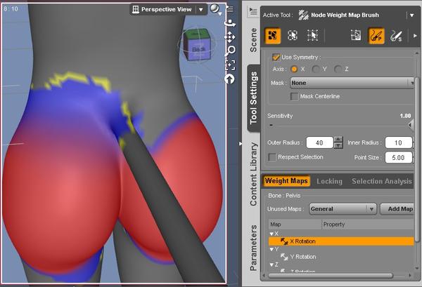

Here's a picture of what is happening. You can clearly see I have the symmetry on. I know for a fact my figure is 100% symmetrical, but painting weight maps only applies the paint to one half of the figure. This is frustrating me to tears.

AH HA!!!!! I think I figured it out. Weight map symmetry is based on BONE symmetry and NOT GEOMETRY symmetry!!!
Somehow my spinal column got misaligned on the x axis by a few points. When I zeroed it the paint brush symmetry started working again.
