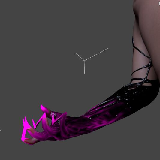

    I did, what happens is that the male's hands, for example, on the claws, get a "stretched" look where part of the claw stays locked in place.  It's just one example.  Apparently, the nodes on skeletons or something between the males and females is different, so some items leave a smeared graphic.  Here is what it looks like as an example:
    https://www.daz3d.com/forums/uploads/FileUpload/ca/90379175a8aa800ad4c4281656bbc0.jpg
    Noah LGP said:
    Did you try just to autofit it? Something like this should work well with autfit
    Those Liquid Armor Gloves are a bad example. The tips have trouble following extreme morphs on the Genesis 8 Females, never mind crossing over to the Males. I tried for weeks to find what was interfering, but gave up and returned them. Something to do with the base geometry and which bone the vertices/faces/edges they are linked to.
    The cross-fit usually works pretty well, though, on most other items I have tried.
    True.
    There are a few of exceptions when the crotch, the breasts or the middle zip are distorted.
