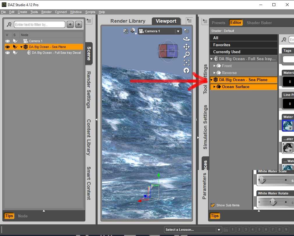

    I'm using Daz Studio 4.12 and not able to get any of the Shaders to affect the Sea Plane or Full Sea Iray Decal. The steps I took:
    1. Double clicked Environments > DA Big Ocean
    2. Clicked on NVIDIA Iray preview
    3. Clicked on 'DA Big Ocean - Full Sea Iray Decal' in the Scene Explorer
    4. Double clicked Shaders > DA Big Ocean 06 Giant (or any other Shader)
    5. I expected to see something about the ocean change but nothing happened (the preview didn't even update; as if I hadn't done anything)
    For #3, I also tried selecting both the Sea Plane and Iray Decal and then double clicking on a Shader - no effect.
    Can someone let me know what I could be doing wrong?

    Hi edpark,
    To apply a Shader Preset you also need to select the relevant surface in the Surfaces tab. See the attached picture
    The shader presets are divided into the base ocean shaders in the folder: Big Ocean Plane - Shader Presets, and the Full Sea Decal (A semi transparent top layer of the ocean generally used to add white water effects across the entire ocean) in the folder labeled Decal Full Sea  - Shader Presets
    To change the base Ocean shader select the DA Big Ocean - Sea Plane in the scene tab then select the DA Big Ocean - Ocean surface in the Surfaces tab. Then you can apply a shader from the folder Big Ocean Plane - Shader Presets.
    To change the full ocean decal select the DA Big Ocean - Full Sea Iray Decal in the surfaces tab and apply shaders from the Decal Full Sea  - Shader Presets folder.
    Hope this helps.

  • edparkedpark Posts: 8
    Hi Razor42, I see where I went wrong now; I was so used to other products where you select the object you want to affect in the Scene Explorer and then double clicking on a Shader makes the change.
    Sorry you have to keep repeating yourself!
