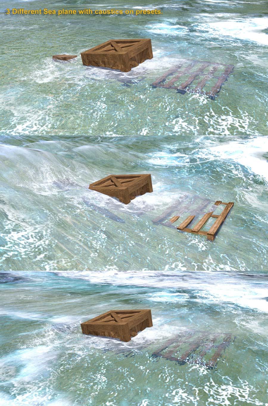

    Thought I would share a few of the test renders while looking into this. Still love playing around with this one.
    900 x 1360 - 235K
    900 x 1360 - 230K

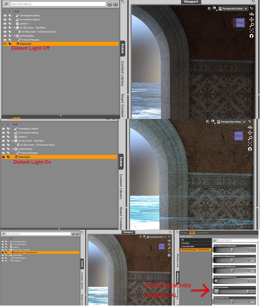

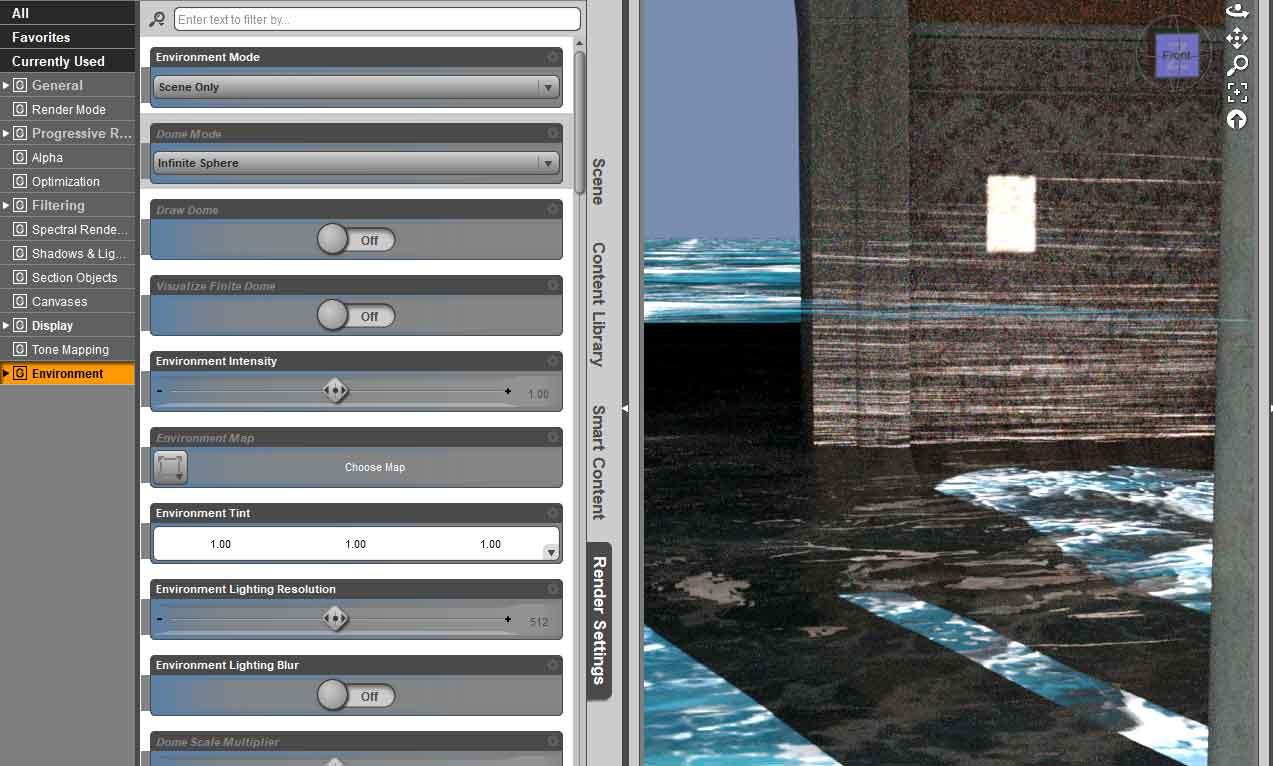

    Okay after a bit more research I found a few possible "glitches" with the caustic sampler and render settings that may cause issues. And also a few things that may be helpful if this is what your experiencing.
    The one I suspect relates to the HDR Dome scale/Dome radius. Adjusting the settings for the decal mapping system and clip settings or by adjusting the dome scale and dome radius seems to help.
    EDIT:Looks like the clipping settings do not actually correct the issue, I'll keep digging.
    Post edited by Design Anvil - Razor42 on

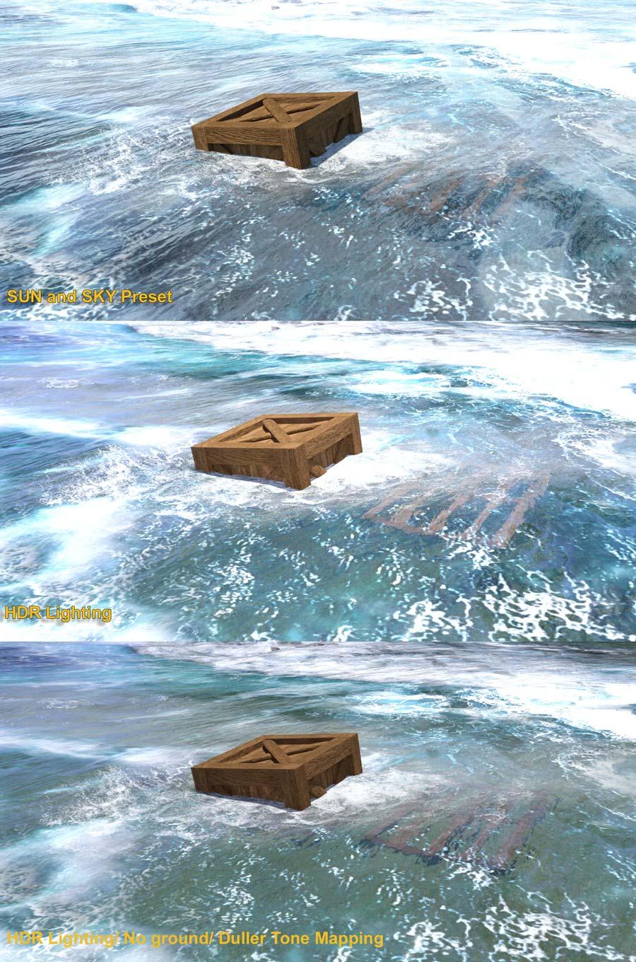

    You're right Rev2019 Caustics do seem to be the source of the issue. It appears that this issue may be related to the oppacity map on the decal as turning it on or off seems to remove the show through. The issue also is sporadic based on the camera proximity to the object and the angle as you mentioned. I tried resaving the oppacity map in a number of different formats, none seemed to help.
    1273 x 766 - 80K

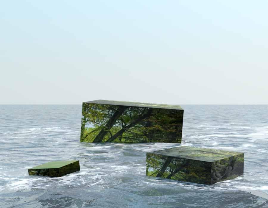

    Okay, the best I can suggest is to disable the opacity map on the decal if you encounter this and it's not possible for you to work around with the lighting settings or camera position. The refraction weight does most of the heavy lifting hiding parts of the decal anyways. In the majority of cases the caustics work correctly with the decal, but there does seem to be some kind of issue between the caustics settings and the decal transparency maps which is obvious in specific situations. Feel free to ask Daz what the issue is and if they have any specific suggestions to correct it and I will be happy to implement whatever they suggest as an update for DA Big Ocean, but I suspect this unfortunately may just be one of those quirks that need to be worked around.
    The image below is all default settings and is unaffected by the issue.
    900 x 478 - 36K

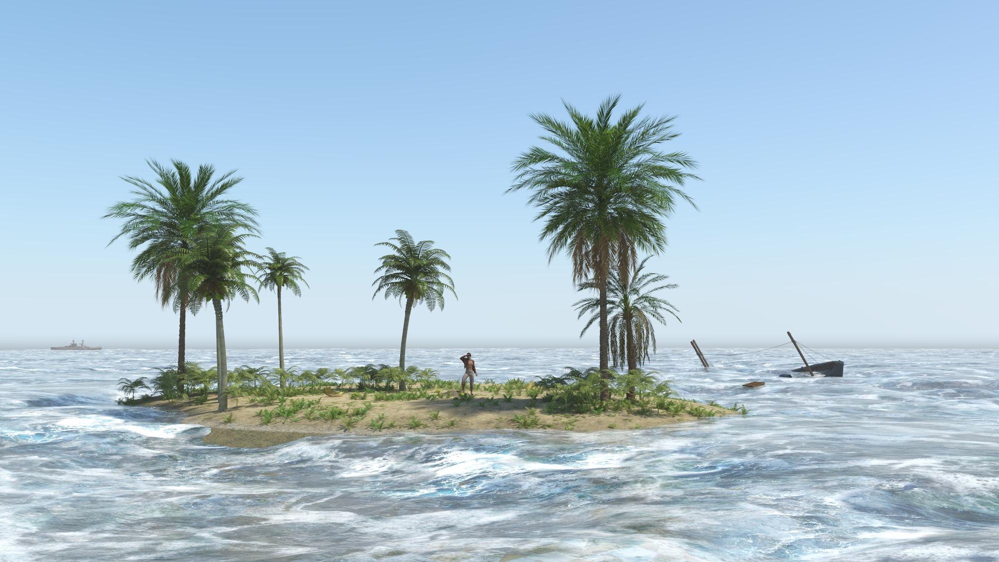

    And now my rant: I ran in to a problem using the DA Big Ocean render settings with an UltraScenery island scene. The render settings presets in DA Big Ocean changed my Instancing Optimization setting to "Speed". That is death to any scene with a lot of instances. Daz Studio crashed over and over until I finally discovered what the render presets had done. The render presets in DA Big Ocean seem to change a lot of settings unnecessarily. I can understand changing the Sun-Sky Settings, and Tone Mapping, but changing my filter settings, optimization settings, render time, converged ratio, render samples, etc. is very annoying to me. When render settings are saved, it is possible to select to save only certain parameters. I wish the DA Big Ocean render presets had been more selective in what they included so they didn't overwrite everything. I have now edited the render settings presets to remove some of that stuff so this doesn't happen to me again.
    I do like the product, though. This is one of my UltraScenery scenes with DA Big Ocean, after changing Instancing Optimization back to Memory.

    Nice work with the shipwrecked render also, the ocean looks great and you really captured the sense of isolation. I’m not quite sure if that ship on the horizon is a glimmer of hope or the source of his troubles.

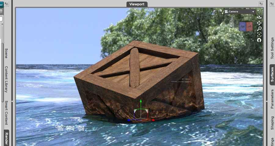

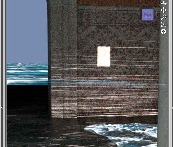

    Yeah, I had a bit of a look into it and found it hard to pin down exactly what is going on but it appears to be some kind of glitch relatied to caustics and the transmap settings on the decal. 0% and 100% seem fine, but anything in between causes a strange bleed through effect on prop items as in the image below. Though I am not sure this is the same as what you are describing, I will need to download the pulbic beta and have a look, as I mainly came across the issue when using HDR lighting and multiple scene lights such as the camera light and a distant light.
    Were you having issues rendering the scene at all with caustics and the sunset bloom preset?
    654 x 557 - 220K

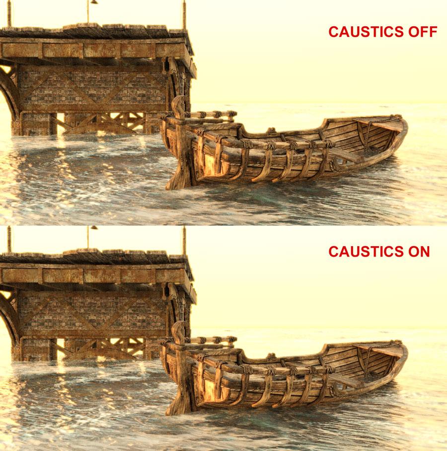

    Does the caustic setting really add anything to Big Ocean renders? I can't see any difference between my render with it on or off. I attached both renders. Do I have to add bright scene lights to have it do something? I never use the camera headlamp.
    2000 x 1125 - 1M
    2000 x 1125 - 1M
  • Oh okay, thanks for checking it out and letting me know. A bit more looking and the bleed through issue is present in the Sun and sky Sunset bloom preset also. Scene lights seem to make it more obvious but you can see it with any lighting to varying degrees as long as caustics are on.
    Caustics are a pretty specific case and may help with a little bit of realism in certain cases. You can see the caustics a few posts up on the crate, but they do take a very specific set of lighting conditions to see and in most cases caustics are better left off.
