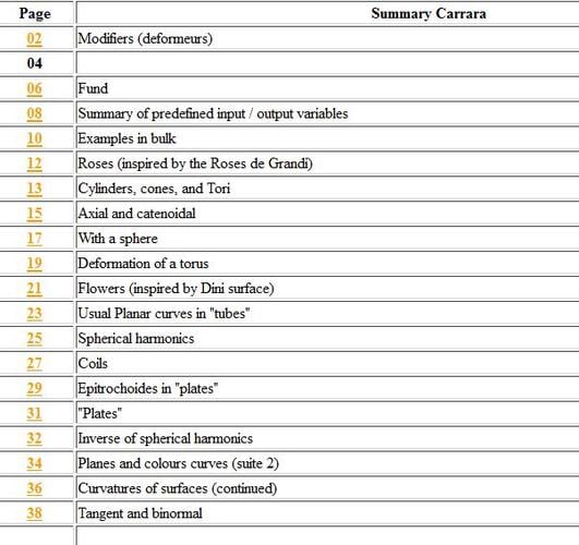

    This site is in French, but it lists some formulas and shows pictures of the results. Most them are pretty complex, but they give you a good idea of what's possible...
    http://gianp.free.fr/carrara/indexcarrara.html
    Excellent! That's exactly what I was looking for! But now I'll have to find a way to translate that main menu! :ahhh:
    Thanks for this!

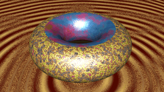

    I actually fiddled with it once to do this
    two objects with the p2 sliders animated in reverse to each other
    r1=10*p1;
    r2=10*p2;
    t=2*PI*u;
    p=PI*(v-0.5);
    x=r1*cos(t)*cos(p);
    y=r1*sin(t)*cos(p);
    z=r1*sin(p);
    that is just the carrara torus formula BTW, I have no idea about maths!

  • DUDUDUDU Posts: 1,945
    edited October 2013
    Waw !
    How are you animate it ?
    The formulas changing makes keyframes ?
    PS: the 2 sliders ? Cool !
    Post edited by DUDU on
  • WendyLuvsCatzWendyLuvsCatz Posts: 41,813
    no the sliders underneath and the bits under parse and more gives options

    Okay, so I've translated the French site, and it works, thank you Pjotter!
    Edit: I tried to just make an English link - but, alas, we must simply follow Pjotter's simple instructions, above, to translate to English

    Territan is absolutely correct. There are quite a number of places where we may use formulas in Carrara - and it could certainly fill a good book.
    Let's have a quick look at this French page: http://gianp.free.fr/carrara/indexcarrara.html
    I cannot understand French at all. Thanks to Pjotter, pointing this out: we simply copy: http://gianp.free.fr/carrara/indexcarrara.html
    and paste it into Google Translator, the big box on the left. A link will appear in large letter on the right. Click on that and you now have an English translation of the whole site and all of it's links. (Thanks, Pjotter, once again)
    Edit: I just tried translating again and got unwanted results. I tried this translator site and it worked - http://www.freetranslation.com/
    If something screwy goes on with translation, just find another translator. Some work site-wide, like this, others only words or phrases. Again, establishes my urge to have a translated copy that I can keep.
    Something strange going on with my web - having trouble with translators. Posting an image of the main contents page translated for future use
    Using the descriptions, have a look through some of the examples by clicking on the number to the left.
    These shapes can be really valuable i computing all of these different areas Territan is mentioning. From subtlety to its complete opposite, this guide can give us some extreme examples of how different formulas will behave as a tweener, shader, modifier, or model.
    Since these are three dimensional formulas, I am understanding that the center of the resulting shape is 0,0,0 or absolute zero in three dimensional space. In RBG, zero equals Black as 255 = White. In a tweener the center will equal the data from the left side of the sequencer timeline, and the further away it gets from center, the closer it gets to the data on the right.
    Just a small rationalization to what's going on here.
    So with that in mind, you'll see that some of these formulas will give subtle results, perhaps, while many or most others will do something really special. I really need to translate this whole, amazing site and print it to book!

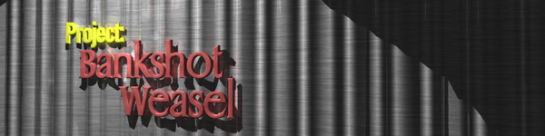

    Okay kids, here's a somewhat simplified formula to get you started:
    x=60*(u-0.5);
    y=p2*sin(x*20*p1);
    z=30*v;
    That'll produce a vertical plane. Move p1 and p2 off of zero, and you'll see it get wavy.
    Here's how to read what's going on here.
    First, you know how objects are UV-mapped, and how one corner is the 0,0 coordinate and the opposite corner is the 1,1 coordinate, and everything in between is some pair of decimals between those? That's what the u and v here are doing: Every value of U and V between 0 and 1 (in tiny increments) is plugged into the formulas. Whatever results come back, that's where Carrara puts a pixel, and that pixel will have that uv mapping.
    I flat-out multiplied v by 30 in order to get a vertical thing, running from z=0 to z=30.
    I subtracted 0.5 from u so it would go from -0.5 to 0.5 instead of 0 to 1. Then I multiplied that by how big I wanted the wall in the x axis, in this case 60. So the wall runs from x=-30 to x=30.
    y is admittedly a little more complicated, but much more interesting. I wanted a wavy quonset-hut type corrugated metal wall effect, so I want it to wave back and forth across the y-axis. So I set y to a value based on the sine of x (you know, like a sine wave?) so it would oscillate back and forth.
    Sorry, yeah, it does contain a little math. As the old saying goes, "Welcome to the Turing Tarpits, where anything is possible but nothing interesting is easy."
    I multiplied x by both 20 and p1 so I could control the rate of oscillation without changing the formula itself. After I had that number, I multiplied that by p2 so I could control how deep the waves were.
    You'll need to move both p1 and p2 off of zero, but when you do, you'll see it get wavy.
    Different formulas loop across different values using different variables, and use different variables for output. Again, the Carrara 7 manual has that information.
    Admittedly, the parser is a bit finicky (it doesn't like decimals that start with the period, for example), but this provides Carrara with the power to image any shape and effect you can define mathematically.
    Post edited by Territan on

    Oh, and that vertical wavy thing that I wanted? The one that looked like corrugated metal?
    Here's what I wanted it for; I run games on G+, and I sometimes render my own event banners. This represents a change, in that this is the first one I did in Carrara.
    And while the formula unit is cool, it's hampered by a lack of examples.
    What we need... is a cookbook.

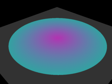

    Okay, here's another one.
    Lemme set the scene: A single plane on the floor, with no shader on it. A single spotlight, shining directly down on it. The picture should appear below.
    The secret to this colorful outburst?
    Select that light in the object list, then the Effects tab. There's a Formula in the Gel menu, and that formula is:
    red=1.0-pow(pow(u,2)+pow(v,2),0.5);
    green=pow(pow(u,2)+pow(v,2),0.5);
    blue=1.0;
    Here's a new twist: u and v range from -1 to 1 instead of 0 to 1. While that may seem silly, it does mean the point the light is aimed directly at is u=0 and v=0, which is kind of convenient for some math anyway.
    Blue, I simply set to 1.0 full intensity. Everything gets blue.
    Red and Green take some explaining. It's derived from the Pythagorean theorem. Remember x^2+y^2=z^2? That's the formula you use to determine the distance between two points: add the squares of the differences, and take the square root of that.
    Green is set to u^2+v^2, so the farther away from the center, the more green it gets. Green + Blue = Cyan.
    Red is 1 minus that value, so the closer to the center of the spotlight, the more red it gets. Red + Blue = Violet.
    So the light varies from a cyan outer ring to a violet center.

    So now that I've had a short perusal of "That French Page", I am certainly going to be using formulas in Carrara. Does this mean I'll look heavily into figuring out my own stuff the likes of what Territan (bless his heart) is doing? Maybe. I've never done poorly at math - and geometry was just, plain cool! Loved that class!
    The point was supposed to be that I wouldn't really need to. There are examples a plenty on that French page to keep me fulfilled for some time. It's not like I'm looking to replace box modeling with formulas.
