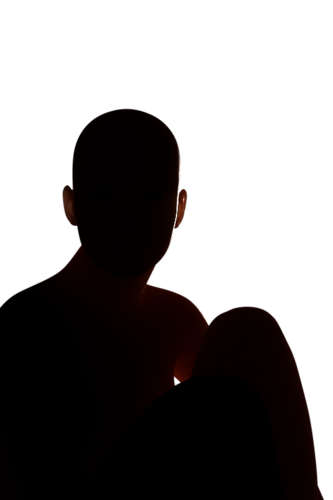

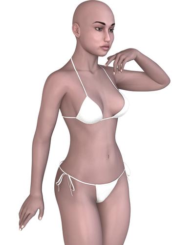

    I think you could do to lower the shading scale a bit. Generally I put it around 1-1.5. Easiest way to test is stick a distant light behind your character set its power to 200%, shadows to raytrace and render. The chest should be mostly dark and the ears super transparent, if not then you should lower the shading scale. Observe below, one oft hose poor Genesis' seems to be lacking in a skeleton and organs!
    The character certainly looks pale but not too washed out, I think I probably have less color and I'm certainly real. If you are worried about the texture losing too much detail, have you plugged the diffuse textures as the subsurface image? I generally do that plus a little pink for my subsurface color, at the very least it helps dark eyebrows stay dark.

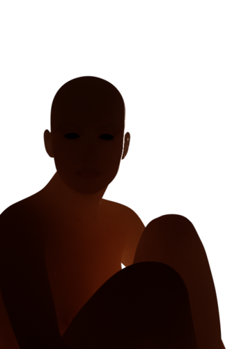

    Thanks for the input. Glad to see this thread is still alive.
    I have SSS scale at around 0.75, so quite a bit lower. I don't see that much of difference in SSS shading rate between 1 to 4.
    That's probably to me overdriving the gamma/gain too much. After some tinkering, I've tone it down so it's just a tad darker and the color of the diffuse textures are generally 'retained).
    I'm using the hemoglobin map on the subsurface color slot and try to avoid plugging the diffuse map there. The SSS effect on eyebrows (and other parts) are controlled with a separate SSS strength map which I plugged into the SSS strength slot.

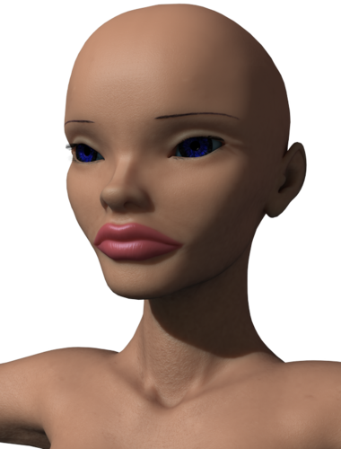

    The lady looks great, Wowie! As I said, a delicate flower. Now I've read you're using higher scales, it makes sense how you achieved that.
    The gentleman a few posts above is probably a bit too shiny, but I guess it's because you're using HSS which does not do Fresnel attenuation of specular... IMO it's pretty much indispensable unless you're willing to ”cheat” with a lower spec overall and a set of spec-only lights in strategic places =) A reflection map set to Fresnel also helps, but it gives a different look.
    But. I would love to dare you. Try getting real black eyebrows or black ”goth” makeup with a SSS strength map on a single-level shader, like the HSS you're using. Make it as black as on the diffuse map. I failed at that. Can you? Please?

    You see, it kinda depends. For closeups and ”photorealism”, then you're absolutely right, you just cannot replace a photo texture. But for what I do... which does not really have closeups that often, and which tends to be, I don't know... ”hyper”-real, as I tried to describe above... I think it should be okay. Especially for toons.
    Take a look: it's a morphed version of Sixus1's HER, and it uses procedurally generated noise maps. These are not procedural shaders, it's US2 with two maps plugged into the bump channel (no other maps): one for lips and another one for the rest of the skin surfaces. Random noise maps generated in Paint.NET.
    So I think that for my purposes, a procedural shader should be great. It should have more flexibility than pre-generated noise maps.
    Tech specs:
    UberSurface2
    only Layer1 used, only parameters of active channels listed (others are off)
    Diffuse:
    white, 5% strength
    Bump:
    Noise map generated in Paint.NET
    min -0.04, max 0.02
    Fresnel:
    90% strength, falloff 2
    Specular:
    (67, 118, 146), 175% strength, glossiness 10%
    SSS:
    "Skin2" preset, 100% strength, scale 0.1, shading rate 2
    608 x 800 - 413K

    example 1
    I really hope this does not get pulled.
    note that I am not a merchant vender never sold anything and this wip could last forever so at the moment this is not a commercial add for an upcoming character
    Okay, so I got the skin set up and am happy with it, kind of got an over exaggerated lively glow and I have not done anything to the nails, they are Dawns default nails.
    1081 x 1528 - 118K
    Post edited by Type 0 Negative on
  • Type 0 NegativeType 0 Negative Posts: 323
    edited October 2013
    please forgive the double post but I needed to make sure the images went up in the right order and please note the time of this post I am not thread bumping.
    Problem here in this image,
    after doing the first example render, I went into the surfaces tab and set up the nails the way I wanted them, I then saved the nails as a DUF materials preset. I made sure that when the widow opened only the finger nails and toe nails were selected and saved.
    I then applied my saved preset and rendered and when I did, it changed the skin making it look like this. see how the skin is dulled down now? However, I double checked the skin materials in the surface tab and nothing has changed, everything is exactly the way it was, nothing changed for the skin in the surface tab but the skin changed on the render.
    1081 x 1528 - 117K
