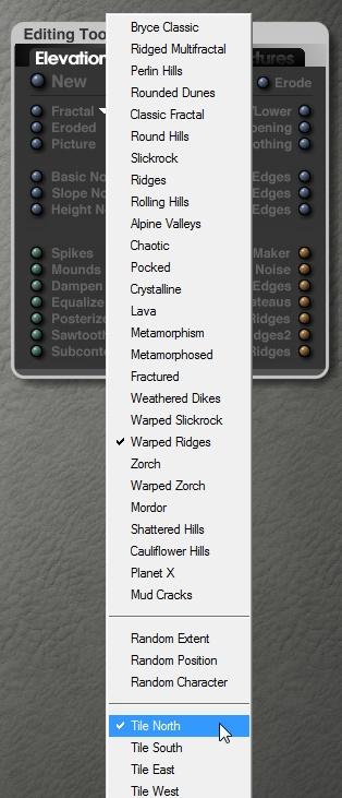

  • SlepalexSlepalex Posts: 911
    edited November 2018
    I've been doing terrain test trials between the different Bryce generated terrains and GeoControl Filters. The challenges that I'm facing are lack of consistencies of the same type of Bryce generated terrains (Modor for example) and using the same GC Filters. My next step in this research would be to import a Bryce generated terrain of the same type, and carefully paint the effect on the terrain. I only have one Paint Undo, so this could be pain stakingly slow.
    The other huddle is to find GeoControl's Zero Edges parameters in order to have all of the terrain sides untouched by the filters. I tend to prefer terrain tiles set up before importing them to GC, and have consistency throughout including having sharp edges.
    Eugenius, I did not understand what you mean.
    But if you mean the repetition of actions in TE and GeoControl, then remove the check marks "Random" on the Fractal tab. If you want to to arrange a few terrains as tiles, then alternately mark "Tile north, south, east, west".
    If you want to repeat the successful combination of filters in GeoControl, then save the settings as a GTS file to disk and you can always load them for any terrain.
    314 x 731 - 85K
    Post edited by Slepalex on
  • Dave SavageDave Savage Posts: 2,433
    Also, if you are going to deselect the 'Random' options so that Bryce will create the exact same fractal everytime, you can deselect all three at once, by pressing the 'Shift' key while deselecting one of them and all three will deselect at the same time. It saves having to do each one individually.
    Oh! I didn't know that either.

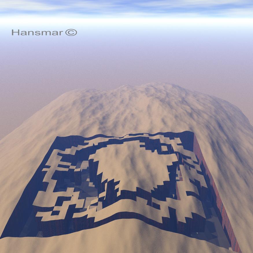

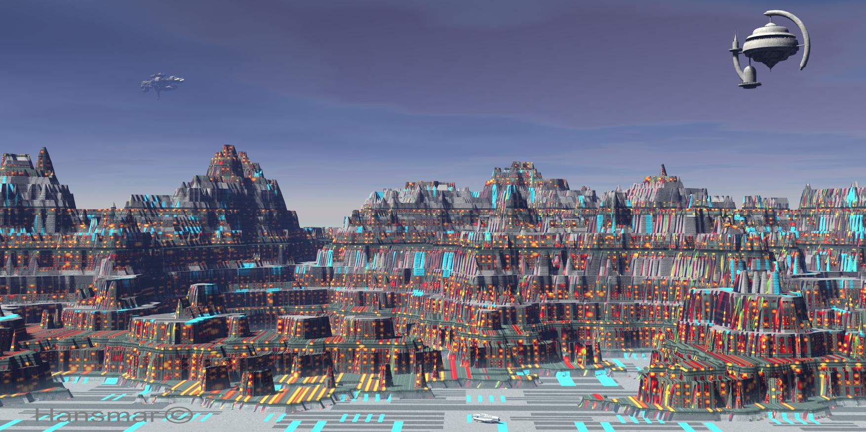

    I made some new works too. First an excavation, made with a normal Bryce terrain and a terrain made in WM and alt-posterised in Bryce used to dig out some part. Then two normal terrains, coming from WM, a bit lowered and stretched and textured and rendered in Bryce. The last one is a heavily posterised and with subcontours. Copied twice and stacked with different textures.

    Horo - Thanks for the great input. One of the Terrain Prests in GC Demo has a terrain which all four sides were completely flat; I thought it was the Zero Edges but apparently, I was mistaken :-) Tiling at 512 and then changing the resolution sure does speed up the process. I tend to forget the Picture Tab sometimes and it will come to good use in this experiment. In GC, I decided to start from scratch and as I went on, winded up removing a terrain generator and an erosion filter; the result has much better details and consistency. Thanks again for your help.
    Hansmar - Excellent job! The first image looks like an American Indian labyrinth. I love the rock style and fog on the second one. The Dry Mountains look fantastic, given the low-resolution hurdle and awesome scifi city; reminds me of the Klingons' architecture.

    Hansmar - lovely renders my fav is the Dry Mountains

    Hansmar - nice terrain work.
    Eugenius - you're welcome. You can also make zero edges (sort of) with Isolines. Good examples.

    Hansmar really nice terrains. love the texturing and the colors with the scifi city..built right into the mountain
