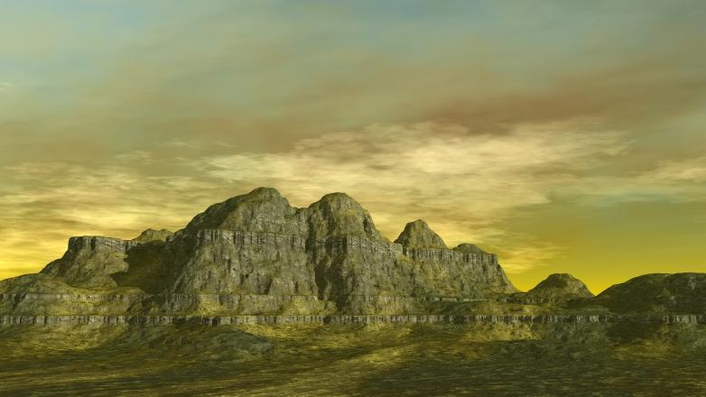

    Horo, after all, we still know very little about the capabilities of Bryce. This is not about hidden opportunities, but about the obvious ones that lie in the most visible place.
    As soon as I read your words “The posterize option in the TE is not bad but is limited to the whole terrain height.” I immediately remembered what I was doing yesterday.
    This message of Dave Savage about the manipulation of erosion in TE led me to this thought.
    So here we go. Create a terrain and apply posterize. Turn on the Unpaint Effect mode and use a soft brush to erase posterization in some places. Below it, the original terrain is exposed. If we overdo it, we turn on the Paint Effect mode and in some places we restore posterization.
    Quite a bit of patience and your words about the impossibility of posterization in some areas turned out to be refuted.
    Glory to the Great BRYCE!

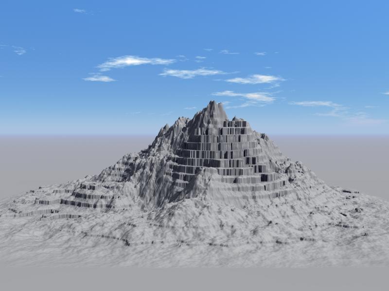

    Here is a quick sketch with a combination of Eroded, Erode, Posterize, Unpaint Effect and Paint Effect.
    If you pass this terrain through the filters with noise by default in GeoControl2, then you can get quite decent terrain.

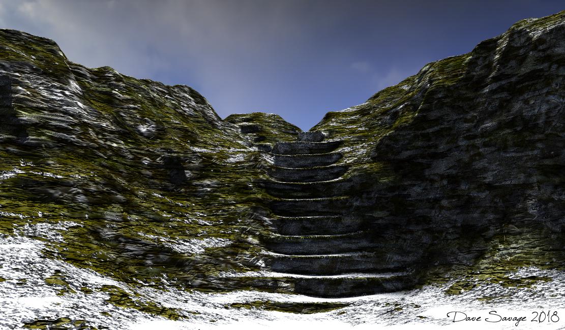

    Alex: Yes, that's exactly what I did for this render and the problem is solved.
    Eugenius: That looks cool.
    Here's the one I smoothed, It doesn't need much, just a quick click.

    Bravo, Dave!
    I once made a stone staircase in an old park, but I drew it in a 2D editor.

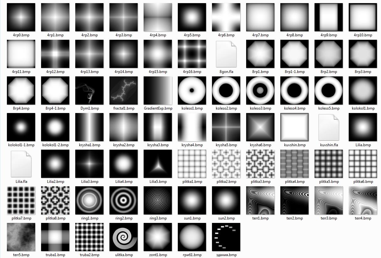

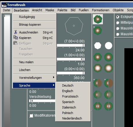

    There is another old free height map generator. Called TerraBrush.
    It is still available http://www.cyberfunks.de/
    These are the height maps I created 10 years ago for modeling in Bryce using symmetric grids.
    Does not require installation. Just open the EXE file.

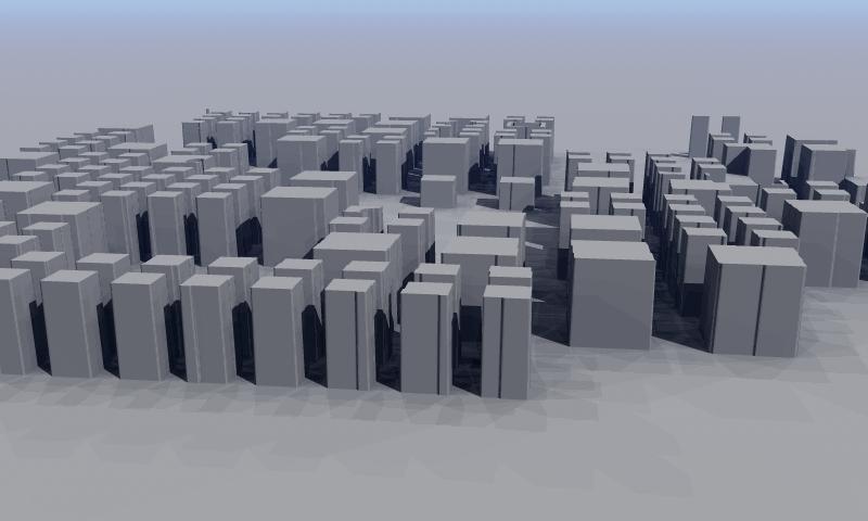

    If you mean it, then this is done in 5 minutes in TE.
    800 x 480 - 178K

    Thanks Alex for TerraBrush.
    TerraBrush.Zip
    If anyone else is interested in using it this might help.
    Just run it, no install needed but it starts in German language.
    Go to the Language settings to change it to English.
    463 x 440 - 66K

    If you only want a flat surface with a road/pavement grid on it, you don't need the TE... use a 2D plane and then draw the roads in another software. :)
  • PixelPiePixelPie Posts: 381
    @Slepalex - I love the terrain you made with the stairs.  I made several tries and was unable to get the brushes to work last night.  Not sure why the terrain editor is freezing up on me.  I may have to reload my iMac and use it exclusively for Bryce--keep it as my retro "way back machine".  It seems with every new update on the Windows 10 platform there are more issues.  Bryce crashes a lot on me which is one reason I was looking for an alternateive.  Also, thanks for the link to TerraBrush.  I can't wait to try this out.  I played a little with WC1 which is much like GeoControl.  I could never find a set of tutorials or an official user guide for WC1 or GeoControl.
