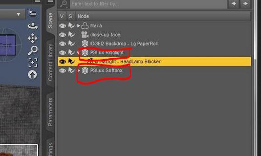

I have a ring light on the top back of her right shoulder and a softbox on front of her left shoulder. (see screenshot)

    Hmm i think im using bad lighting.... See screenshot.

    The headlamp blocker is not the problem, the Lux Light is.
    The headlamp blocker just makes sure your camera doesn't use its headlight.

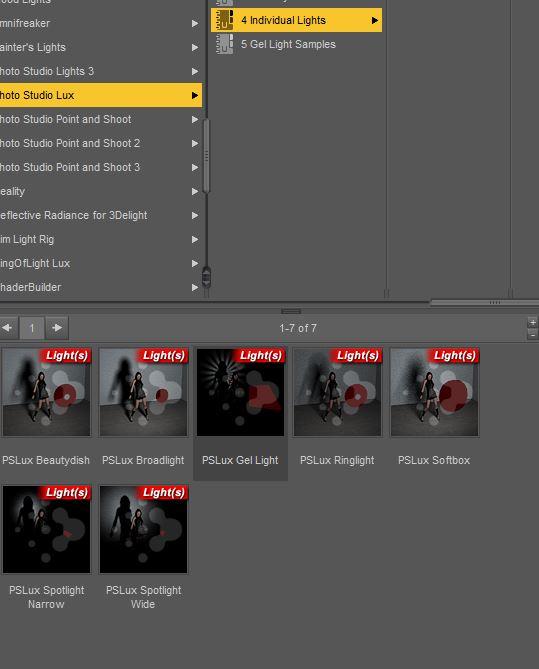

    Are you by chance using these lights?
    If yes, there's your problem - these lights are for the LuxRender engine, and will not work in Iray or 3Delight.

  • DestinysGardenDestinysGarden Posts: 2,553
    Actually, that set does render in 3Delight, and it has all the parameters set up in the surfaces tab if you port your scene over to LuxRender through the Luxus plug-in. It won't do a darn thing in Iray though, no.
    Yes, and so there is my problem. I will change to different lighting. Thanks BeeMkay
