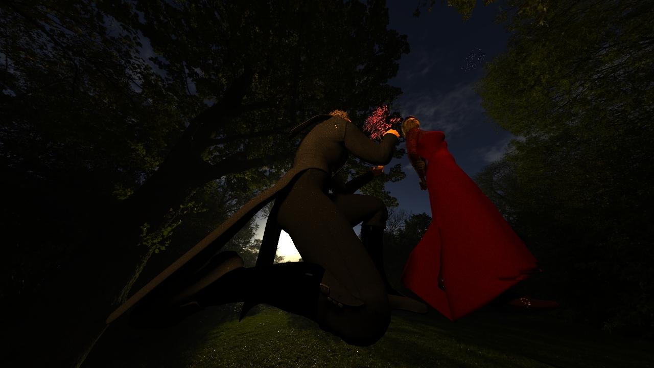

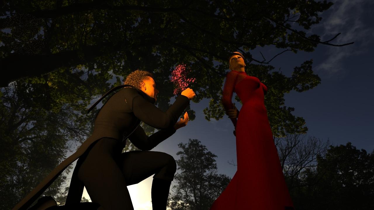

    To get a view from the floor up you will need to hide the floor if the camera is below it.
    Wide angle lenses will work although there will be edge distortion on the wider settings.
    There is a section under Cameras/Lens called Lens Distortion which can straighten some lens distortion.
    Here are two images. The first is directly through the camera set at a Focal Length of 15mm and low to, but not under, the floor. The second image is the same lens at, more or less the same place, using
    Lens Distortion Type - poly3
    K1   -2.00
    K3  -20.00
    Scale  -5
    I had to do some repositioning of the camera as the settings move it slightly. The settings I got were pure luck as I went through quite a few different scenarios and mixing settings to get those :)
    I found a tutorial detailing the different settings but I can't find it now. I do remember that K1 is the top of the image, K2 the middle and K3 the bottom, or perhaps it is the reverse :) I have no idea what the other distortion types do other than they use different parameters to achieve the results. It is a long while since I played around with them so this is all from memory
    Click on image for full size.
    1280 x 720 - 486K
    1280 x 720 - 552K

    Wow. this is what I was looking for.... always at wide angle, there is lens distortion...Thank you!
