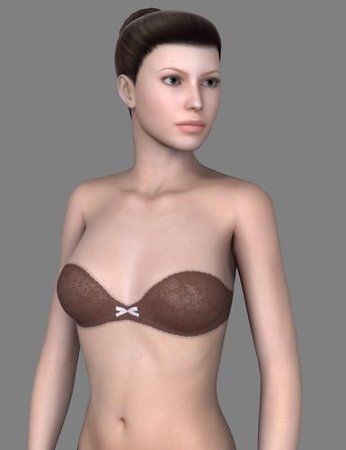

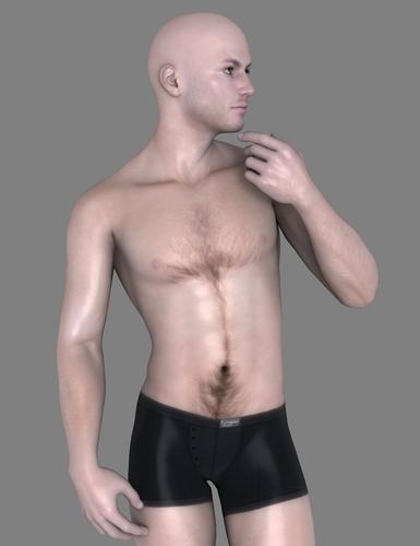

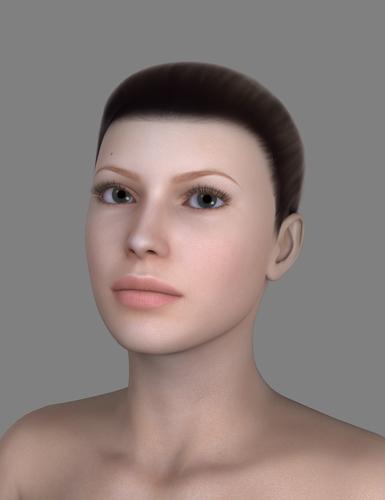

    Finally had the time to do some quick renders.
    It's just plain HSS for the shaders, UE2, plus UberAreaLights and one standard default distant light. I mainly work in DS3. Have DS4, but always seem to crash when I tried to render (randomly).
    The materials and lights still need some tweaks. As you noted, the transluency is pretty heavy and can be too much. That's mainly to setup the upper limits for the lights.
    The materials and lights work best together. The materials will likely show up overexposed/underexposed with most light sets available (free and commercial). The main purpose for the materials and lights was to avoid having that Poser/DS look, and strike a good balance between quality and render times.
    800 x 1040 - 233K
    800 x 1040 - 237K

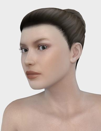

    Another render, using pretty much the same light. The difference is that I turned up diffuse strength and lower diffuse color by about 10% (strength up, color down) for the second render.
    800 x 1040 - 226K
    800 x 1040 - 222K

    Super pretty! =) HSS does seem to handle SSS differently from UberSurface, I wonder why... were there any undocumented code rewrites under the hood? Ah, Omnifreaker only knows...
    And yeah, DS4 tends to crash when it wants more memory (which, on systems with 2GB RAM or less, is almost all the time when the scene is any more complex than a figure and UE set to AO...). What I do then is render to RIB files which are then easily rendered through the standalone 3Delight.
    The lights vs complex materials is a giant problem actually, it's true. You'd think that it were avoidable if we tried to stick to physics-based stuff, but there are way too many variables in unbiased rendering to really ensure universal presets.

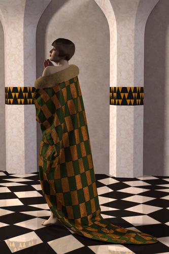

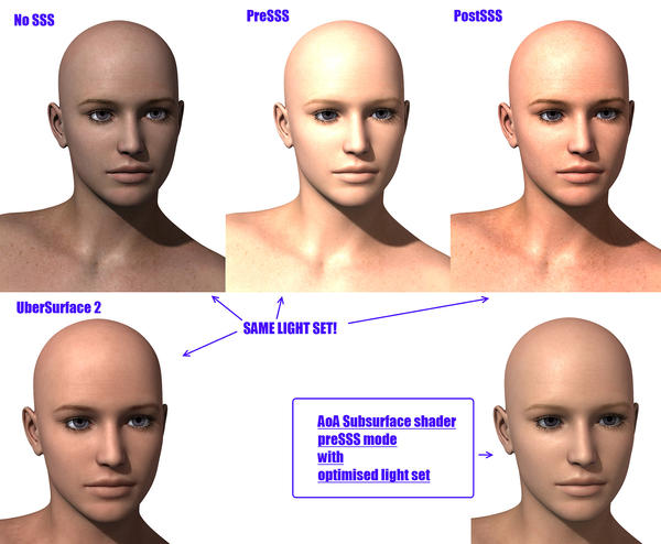

    At home, I was testing AoA's shader further and loaded my "go-to" lightset based on my own HDR map that I routinely use for US2 renders. Pictures speak louder than words, so here's a giant sheet of various effects for comparison. In short, you gotta optimise your lights when you switch shaders, because man, do they render differently!
    2000 x 1646 - 495K
    I think the SSS brick is the same for all three (HSS, US/US2 and AoA Subsurface). The controls are different though. I like HSS more because there's not actually that much to work with. The addition of scatter and absorption color in US2 makes it work differently from HSS, but it's still tied to diffuse strength (I think).
    Yeah, I really need to upgrade to a proper 64 bit machine. I think DS4 bumps into the limits of 2 GB (the amount of RAM I use) way too much compared to DS3, particularly when rendering. Just waiting for Haswell to be launched next month.
    I think you mean biased rendering. I personally don't think biased or unbiased makes much of a difference. I've seen just as many bad renders with unbiased renderers and good ones with biased renderers. Ultimately, it's up to the artist to tell the renderer what he/she wants. They need to understand how to coax the best results of the tools they're using.
    The optimized lights/materials looks better.

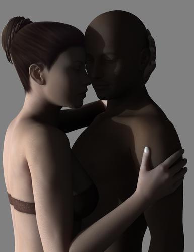

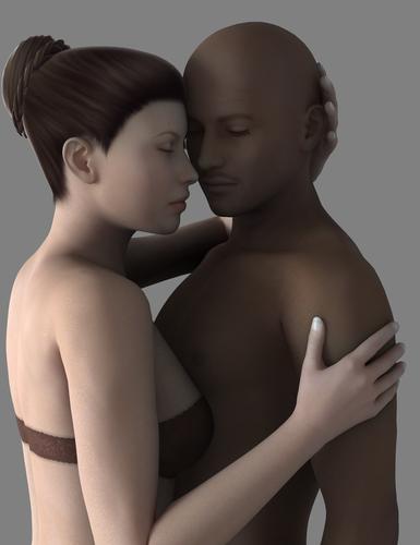

    A point you might want to consider when making materials is not having UE affect scatter (too) much. Put it more simply, you're seeing UE rather than SSS. I made this mistake before. That's why I now always test with two lighting setups - one with soft diffuse light (much like photo studios) and another with harsh lights with very low UE intensity). Once you figured it out, you have a skin/materials setup that's pretty flexible regardless of lighting.
    Another is having both light and dark skin characters in the same space. Your materials setup should be flexible enough that even in shadowy areas, dark skin is still generally visible (or barely at least) With preSSS methods, you generally have to lower SSS strength a bit. I'm thinking with the postSSS, you don't need to do that.
    Edit. After rendering the shots below, I think I can have the same SSS settings and just rely on the diffuse color/strength combo to control the amount of SSS applied.
    800 x 1040 - 299K
    800 x 1040 - 279K
    Good for you pointing that out. I see so many not working on their lighting and expecting instant great results with the shader. The other thing I keep coming across, except for a couple of people, is the fact that folks aren't referencing real photos to see how far off they are from real skin. Not a problem if you don't want real skin, but for those who do, it's very important.

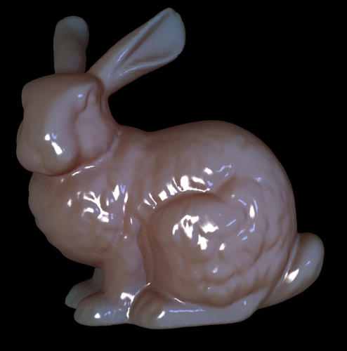

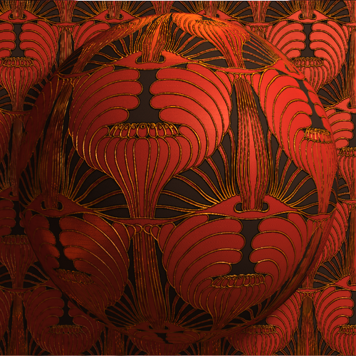

    Hi everyone,
    How are you doing? Sorry I'm later than I promised... it's been a crazy couple of weeks, and pwSurface is one complicated shader =)
    Type 0 Negative, your settings are very cool! Though I felt that I could try and see if they could be made more 'predictable', so to speak, so I changed the SSS scale, turned off the ambient channel, and, on the lights, turned all the shadows on. This is why: the SSS scale of 1 makes 3Delight think the object is 10 times smaller than it is "for real", so the SSS effect becomes very heavily dependent on actual geometry; the 0.1 scale proved to be more reliable, in my experience. Then, ambient on surfaces that aren't supposed to glow in the dark can turn out to be a surprise when you decide to render a night-time scene. And as for shadows, raytraced SSS performs correctly only if all the lights cast shadows, otherwise there may be unwanted surprises, too.
    So I tried to recreate the style of your settings but with these parameters accounted for (there's quite a lot of settings that had to be changed both on the settings and on the lights, so that the looks matched the original...). Hope you like it. Check your PM for the archive with the preset files.
    What I learnt in the process is weird but interesting, and it applies to the default UberSurface and HSS as well. It's about attaching a colour map to the SSS node.
    What I'd found out before was that if you add a colour map to SSS and leave the multiplier colour at pure white (255,255,255) or a shade of grey (R=G=B), it's the same as turning SSS off or setting the colour to pure black (0,0,0). It stops working. Period.
    BUT if there is "actual colour" in the multiplier, it starts working again! The difference between the highest channel value and the lowest one should be 20 points or more for it to happen. Like (255,235,255) or (225,245,245).
    Using the correct 0.1 scale, this is enough to "tint" the SSS map without overpowering it. It opens a lot of possibilities for those shaders that only have "colour/strength" controls!
    A note on pwSurface translucence node: it is VERY different from that of omnifreaker's shaders. The "density based" mode sounds very interesting because it could potentially be useful for rendering super translucent ears without having to paint maps (and yeah, maps for ears are important for shaders that do not have "backscatter boost"). Unfortunately, it's too slow for me to properly test it right now.
    Wowie - thanks for the advice! Candles sound like an interesting idea for calibration...
    1236 x 800 - 124K

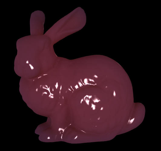

  • Takeo.KenseiTakeo.Kensei Posts: 1,303
    Translucence?
    1920 x 1080 - 172K

  • wowiewowie Posts: 2,029
    This is very interesting and explains results I was getting. I had been getting the same results but hadn't fully realized what was happening, just that putting color in the color channel with the map got better results. It didn't occur to me that it was a bug where it wasn't working at all, even though it basically appeared like that. Sometimes it takes someone else explaining what you are seeing to have it actually click ;)
    I believe the upper limit is anything above 250,250,250. Values below that works fine.

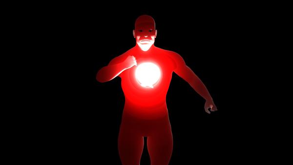

    Translucence?
    Hi there! =) How did you get the light to shine through that belly?
    I didn't test with HSS, but both the default US and pwSurface2 consistently refuse to activate SSS when R=G=B, even if we're way below 250.
    pwSurface density based translucence is really neat, I tried it out a bit but it is slow, so slow i gave up on it but got some interesting looking things to happen, kind of weird on skin though, more like it would be good for glass-like things perhaps. Could possibly be used on teeth and eyeballs, that would not hurt the render time so bad and might be usefull. Hope to have some time for that idea soon.
    Teeth sounds interesting, if they're modeled with enough detail it might be very impressive, they should be more translucent around the sharper edges then. IDL should probably be enabled on the inner mouth, too, for there to be more light to pass through them.

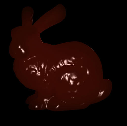

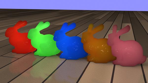

    Translucence?
    Hi Muskatt, thanks for the word on my DeviantArt account. How have you been doing ? That's been a long time since we had a discussion in a thread : ). The answer to your question is Point Light inside the body of course. That's one of the interesting effect of SSS
    I should give advices here but there are so many I don't know where to begin
    I don't know either if I should post examples with shaders I wrote to illustrate my point
    However here are a few things :
    - render with point cloud script if you can. That speeds up things
    - people tend to confound SSS and softness due to specular with low glossiness. Put a back light to see the real effect or minimize specular effect
    - begin with the basics and render without maps. Skin is very complex
    - I don't think US, US2 or PW Surface are physically plausible shaders so don't bother too much about energy conservation or any other law.
    Here are some simple renders with red/pink SSS and the use of double specular to simulate coating over the SSS layer. Choosing a good color for the first specular layer can give interesting results. Only UE + US + a distant light with raytraced shadows
    557 x 564 - 131K
    607 x 571 - 109K
    609 x 617 - 110K
    610 x 605 - 95K
  • Mustakettu85Mustakettu85 Posts: 2,933
    The bunnies look superb, Takeo. Where are those old test meshes (the bunny, the dragon, the teapot) available from now?
    I'd say you should... if anything, it may inspire others to study the possibilities of shader builder...
    For me, actually adding maps is the most complicated thing! I still plan to get that procedural shaderMixer material done... anything to avoid maps, LOL
    It's still a good way to avoid "overexposed" surfaces, in the first approximation - particularly when using the diffuse map in the diffuse channel. I don't do that anymore with US2 (I stick desaturated maps in the diffuse), and that latest discovery that the default US can also take the colour map in the SSS colour multiplier means that I should experiment with the same technique for it... that way sliders could be rather arbitrarily turned up to 11, LOL
    edited June 2013
    Thanks for those. I think they are very helpful.
    Edit: I watched both videos and I think although we won't get physically accurate materials without those shaders, we can have a reasonable approximation. It won't be as flexible or as foolproof.
    Below is a render of my new settings, mostly based on getting both SSS and specular as close as possible with Elite Lana. I saved the materials and applied that to M4's with the default texture (only diffuse and bumps were used, in their respective slots). I did have to make SSS strength maps for all the skin surfaces. The diffuse values in the color sliders most probably are well off (since if you want proper SSS you need to desaturate the texture, either in an image editor or by cancelling out the color).
    Looks rather nice (at least I think so).
    800 x 1040 - 213K
    Post edited by wowie on

    I'm doing some thread necromancy I suppose (Hey its better than thread necrophilia!) But I gave been messing with shader mixer and have made something rather cool. The relevant surfaces were made using 4 images: a bump map a spec map and two black and white control textures. specular/reflections and opacity are fully controllable for each colour and the displacement is sort of based on the specular.
    I do have a question for anyone who can help. Is there any way to control the order things show up in the shader panel? Also some categories refuse to be hidden, they just go grey, is there any way to fix this?
    Reworked, adding some SSS strengh maps and a poor attempt at hemoglobin map (just to add a bit of redness here and there).
    Also tweaked the gamma and gain in the render options. So, please if they looked washed out or not.
    Thanks.
