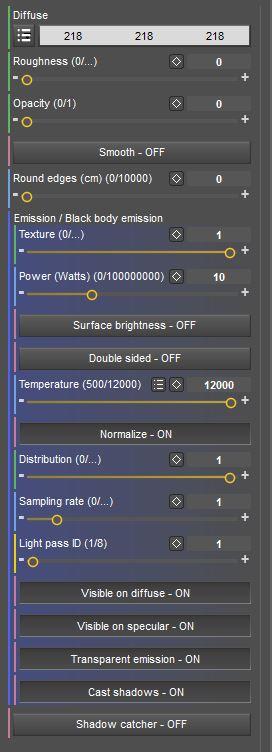

  • SunnydaysSunnydays Posts: 14
    I'm currently testing Octane demo for Daz, it indeed looks very interesting.
    I was trying to recreate spotlight behavior in Octane. For example, I want to have light shine on specific spot only, like blue spot in this Iray render (IRAY.png). As you see the light falls only on front showman.
    In Octane I made a very small emissive sphere and put it near the spot I want, but I can't figure how to prevent the light to shine in all directions(octane.png). The blue light is on side snowman as well, which I want to prevent.
    Does anyone have tips about this kind of set up in Octane?

  • joseftjoseft Posts: 310
    edited March 2018
    What you are after is IES lights. If you look on the Octane forum, there are plenty of threads about it. It is not an octane-only concept either.
    Basically you plug an IES file (downloaded from many sources online) into the distribution node of the light in question, and it behaves essentially like a map that instructs the renderer how to project the light from the emitter. Many different IES files for different light behaviors
    Edit - many people also create custom light/softboxes, simulating light techniques used in photography. Basically placing the emitter inside some open geometry, causing the light to only shine out through the open part of the object. For your purposes, you would use an open cone type object with the flat/bottom part of the cone removed
    Post edited by joseft on
  • bluejauntebluejaunte Posts: 2,270
    Are you saying there are no spotlights in Octane? A sphere will emit in all directions of course.
    joseft said:
    Thank you for the IES tip. I could get some light directionality with it, but lack of light cone visualization makes it hard to fine tune.
    I tried cone-like prop as well. I' still figuring things out, but it seems that to get sharp spotlight you need to put cone really close to the object you illuminating. Thus cone renders too. But if I don't want it to render and make it transparent, it also stops blocking light.
    There are no dedicated spotlights in Octane. Local lights(non-HDRI and non-sunlight) are made through emissive textures.
    Sunnydays said:
    joseft said:
    Odd. So maybe make a flat round mesh like a spotlight instead of a sphere?
  • DustRiderDustRider Posts: 2,911
    Create a plane primitive in DS, convert to SubD,, set SubD to 8, apply the proper emission surface (or use the one you have in your sample - make sure it is single sided), move very close to the snowman (with the emission side toward your snowman), set scale to appropriate size, and you should have the effect you are looking for.

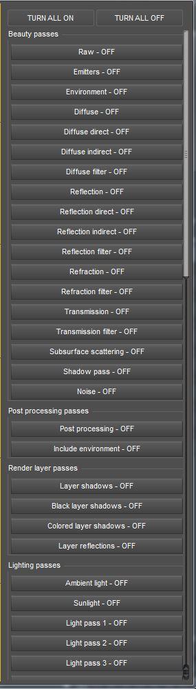

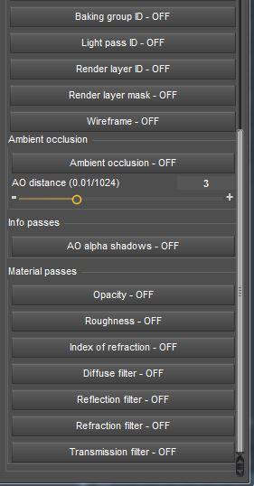

    edited March 2018
    joseft said:
    You can achieve things with Octane that you cant with iRay, at least not with the Daz version/integration. A good example of this is render passes, being able to render multiple different lights, depth, AO, SSS etc all as seperate passes gives a great deal of control to fine tune those effects by combining them as seperate layers in postwork, or to create interesting and exagerated effects that would not be possible otherwise.
    Most, if not all, of this can be done in Iray with Canvasses and Light Path Expressions (in the Advanced tab of Render Settings).
    Below are all the available options for render passes in the DS plugin for Octane, so everyone can compare for themselves. Octane also has Deep Image rendering, which I don't think Iray has.
    285 x 1000 - 61K
    277 x 957 - 53K
    281 x 538 - 35K
    Post edited by DustRider on

    Attached is a screen grab of the emitter settings, I think there are a few very useful features at the bottom that we don't have in Iray.
    272 x 752 - 42K
