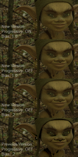

    As promised I am letting you know the status of the artifact bug. I believe I've fixed the issue and I have submitted the update to DAZ. I can't guarantee that this will eliminate all possible artifact situations as there may be other ways that you might get artifacts with IBL in 3DL. However, I believe this should fix the issue reported and shown by Sven Dullah, Kyoto Kid, and Freni-kyn.
    When the update comes out, it would be great if folks could apply the change and confirm the results. Basically, Shadow Bias was broken (sorry about that). After the update is installed, Shadow Bias (bottom of IBLMLight's Light settings) is set to .2. That should help right off the bat, but if you still see black lines that shouldn't be in the render, then you may want to assign a higher value to Shadow Bias. In my tests, this fix works with Progressive render off as well as on, and with the image below, Progressive Off was significantly faster. You should see no speed hit from this fix.
    ***Edit ***: I forgot to add that the full documentation (including FAQs) in PDF form also comes with this update. It is essentially a printable version of the information online here: https://www.chrisparrishdesign.com/ibl-master/
    Image on left shows render before the fix (with artifacts around the nose). Image on the right is the fix with Progressive Off.
    IBL Master Light Shader artifact bug fix

    Thanks for the update, @Parris. I did some tests of my own on a figure that rendered with artifacts:
    In this case, the update definitely mitigated the issue, but it appears as though a small amount persists (even when bumping up the bias further).
    On another note, I know it's been brought up before but I can't seem to find an answer/solution: short of rendering higher resolution and downsampling, is there anyway to eliminate the grain when rendering with progressive on?
    - Greg

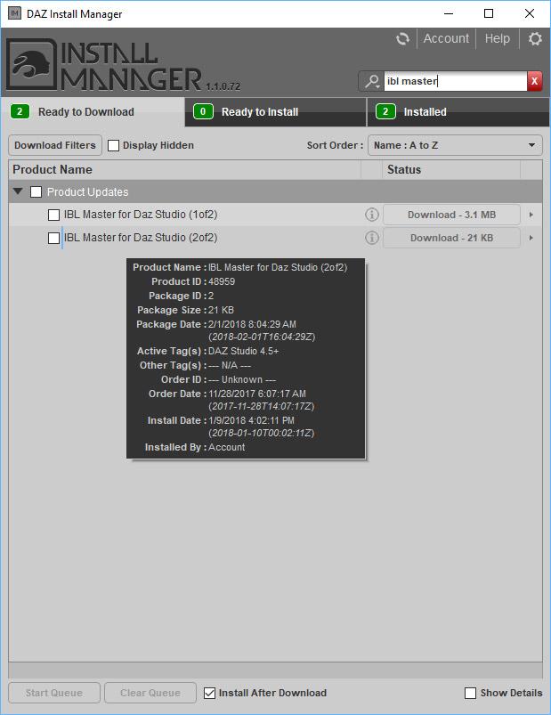

    Sorry for the stupid question but where is the update? Can't see it in DIM.
  • ParrisParris Posts: 392
    Not a stupid question. You definately should see it in DIM. Below is what I see.
    Hey everyone, I'm really glad this update was released so quickly. I hope it serves you well. But the timing is a little tricky because I will be out of town for a couple of days and away from internet starting this morning. So if you have any questions over the weekend, hang tight. I'll be checking back in here when I get back. Thank you.

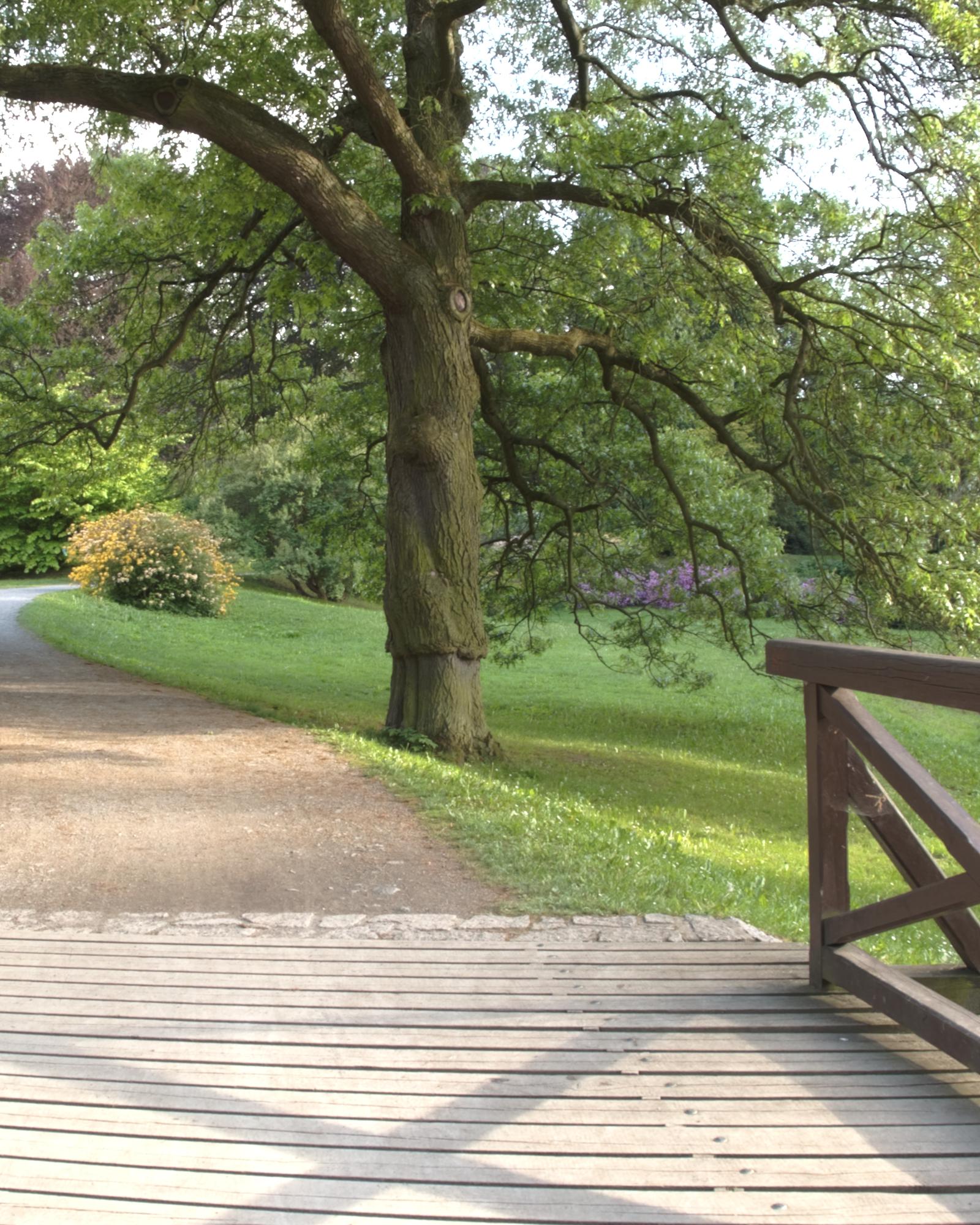

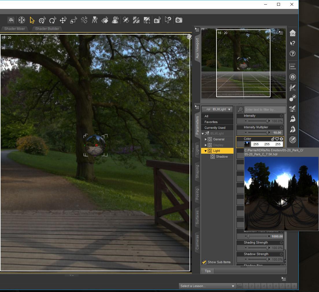

    I'm struggling to rotate my HDRIs with the IBL Master, because the preview in the viewport is so dark. Is there a way to lighten it, even temporarily, that so I can better see what part is going to be rendered? I am viewing it in Texture Shaded.
    This is what I see in the viewport:
    I have no idea where the tree trunk is or where the ground is.
    This is what renders:
    This HDRI is 05-20_Park_C from No Emotion. It is released under the Creative Commons Attribution-NoDerivatives 4.0
    This HDRI is 05-20_Park_C from No Emotion...
    First off, thanks for mentioning exactly what HDRI you are using and where to get it! Providing information that makes it easier for someone to reproduce the same results on their machine can really help speed up the diagnosis / remedy. Having the HDRI on my machine may not have been critical in this instance, but I still found it interesting and it's useful in general.
    Anyway, the best way to brighten up the HDRI in the viewport is to use an image editor like Photoshop to convert it from a 32 bit image to 8 bit (JPEG, PNG, or TIF) and use that temporarily as a surrogate while you are getting the rotation where you want it for the background. To do this in PS, you would navigate to Main Menu > Image > Mode and choose 8 Bits/Channel... . Then in the HDR Conversion dialog, try Highlight Compression as the Method and hit the OK button. With the HDRI you have here, I find it does a nice job of bringing back detail in the clouds while leaving the rest of the detail untouched (ie: bright enough and with enough contrast to easily see the trunk, etc). Then save it out as a JPEG (or PNG if you're worried about quality loss).
    Also, I should point out that if you are rendering on the 3Delight side, this change doesn't have to be temporary, because you can turn off Image Sync and use this JPEG as the background while using the HDRI to light the scene. Details on how to turn off Image Sync are in the FAQ about HDRIs here: https://www.chrisparrishdesign.com/ibl-master/?id=12#ui-id-13  - see last paragraph starting with "Turning Image Sync Off (3DElight only):". NOTE: Once Image Sync is off, changing the image on IBL Master Control will still change the background and the light, but if you choose a different image for the background or the light, it won't change anything else.
    Below I show using the jpeg for the background and control spheres, while using the HDR for the light (Image Sync OFF on IBL Master Control).
    IBL Master with Image Sync off
    1104 x 1013 - 252K
