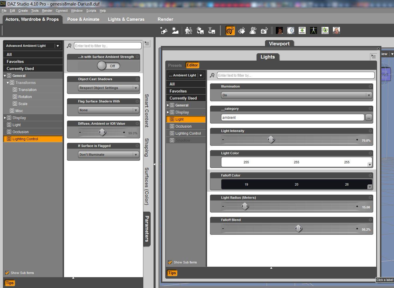

    Definitely try reinstalling it. I'm running 4.10 and  looked at Advanced Ambient, and it looks the same as it always did. It shows a lot more controls than the two you're showing under the Light option, both on the Lights tab and on the Parameters tab.
    advanced ambient
    1347 x 984 - 150K
