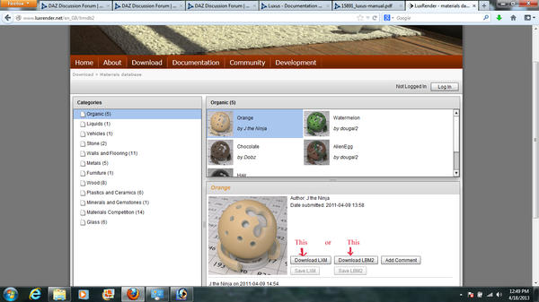

    I have a question. For LuxRender, which do I download?
    1366 x 768 - 418K
  • SloshSlosh Posts: 2,391
    I am assuming you want to use the material pictured? Or are you still in the stage where you are trying to get Luxus and LuxRender installed and running? I noticed that you just got into this game this morning, so I wasn't sure if you managed to get everything installed.
    If you are just talking about getting the orange juice material to work in DS, none of those options you circled will work directly as downloaded. They are files created for the Blender version of Lux.
    So, to answer your question, download the first one (LXM). Once you have it on your machine, open the material in a text editor like Notepad (on Windows). Copy all of the text and go to Daz Studio. Go to the material in Surfaces Tab that you want to apply the material to and paste the text into the "Extra Settings" box, which should be at the type of the material settings on right-hand side. Now it should render in LuxRender.

    OK. Once you said: "open the material in a text editor like Notepad (on Windows)", You just lost me! Sorry, I am such a problem. First I got the LuxRender and Luxus. Have to put them on computer. I know I can make a folder for LuxRender and put it where I want it. Does Luxus go in Daz 4 content? The Lux I downloaded was for Daz. These were materials for LuxRender. This page. http://www.luxrender.net/en_GB/lrmdb2 Does this help understand what I am talking about?
    I understand what you are asking. I did the same thing you did, I went to the LuxRender site looking for materials to download before I even got Luxus and LuxRender installed. What you will find, once you get the products installed, is that there are a few included materials in DAZ Studio that work with the LuxRenderer. Plus, you can create your own by modifying what is there. As for the ones listed in the link you provided, they won't work in DAZ Studio exactly as you download them from that page. You will have to paste the code for those materials into the Surfaces Panel of DAZ Studio.
    Once you get Luxus and LuxRender installed on your system, let me know. It will be easier to explain this once you can see what I am talking about in the Surfaces Tab. LuxRender (the one you downloaded from the website) will install to its own location. Don't install it to your Studio folder.
  • WitchStormWitchStorm Posts: 186
    OK. Slosh, I will get back to you as soon as I put these on computer. Thanks for the help. Should I pm you or com back to this forum?

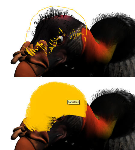

    Ok I took the render off Hybrid and no issues with the render stopping. I will ask over on the Lux forums about the GPU issue tomorrow if I get a chance
    Now the dreaded Transmap issue has cropped up.
    I am using one of Ken Gilliland's birds, one of his new ones that haven't been released yet and it is full of transmaps but only one is causing the issue. I have turned the transmap in to a Greyscale image to see if that fixed it,,,nope, I made sure the black was 100% black and same with the white and still no joy. It renders perfectly in 3DL. I have tried using different render settings and Path seems to work better but still a far cry from what it should be. I even removed all the maps from this one surface and set the opacity to 0% in both Daz Studio and Lux surface settings and it still renders black. How can something render even with Opacity at 0% and with no maps. I just can't get my head around this one.
    I think I know why it is happening from the way the surface is made. It looks like a series of planes grouped together as the Daz Studio surface selector shows the surface as a dome that covers the top of the head.

  • SphericLabsSphericLabs Posts: 598
    Szark,
    Is there a volume associated with the material?

    It may be that the number of insersections is higher than the default settings can cope with - this, or something similar, came up earlier in the thread with some hair at the edges. Bidirectional renderer defaults to 8 for eye and light intersections, path to 16 which may be why path is giving closer to what you'd expect. I cant remember the exact names of the render settings but they're fairly obvious when you go looking. Try increasing the numbers (eye and light for bidirectional, just eye I think for path) and see if the artifacts decrease.

    Pete, try doubling the opacity. You will have to disable the limits in the parameter setting, but this has worked for me on a number of things, including eyelashes and hair. It's worth a shot, right?

  • SzarkSzark Posts: 10,634
    Szark,
    No there are only featheres. :)
    czexana and Slosh thank you I will go and try those suggestions now.
    And the winner is czexana. Increasing the Surface Integrator Path - Maxdepth to 32 works perfectly. Yipeeeeeeeeeeeeeeeeeeeeeeeeeeeeee Thank you everyone you chipped in, very much appreciated.
