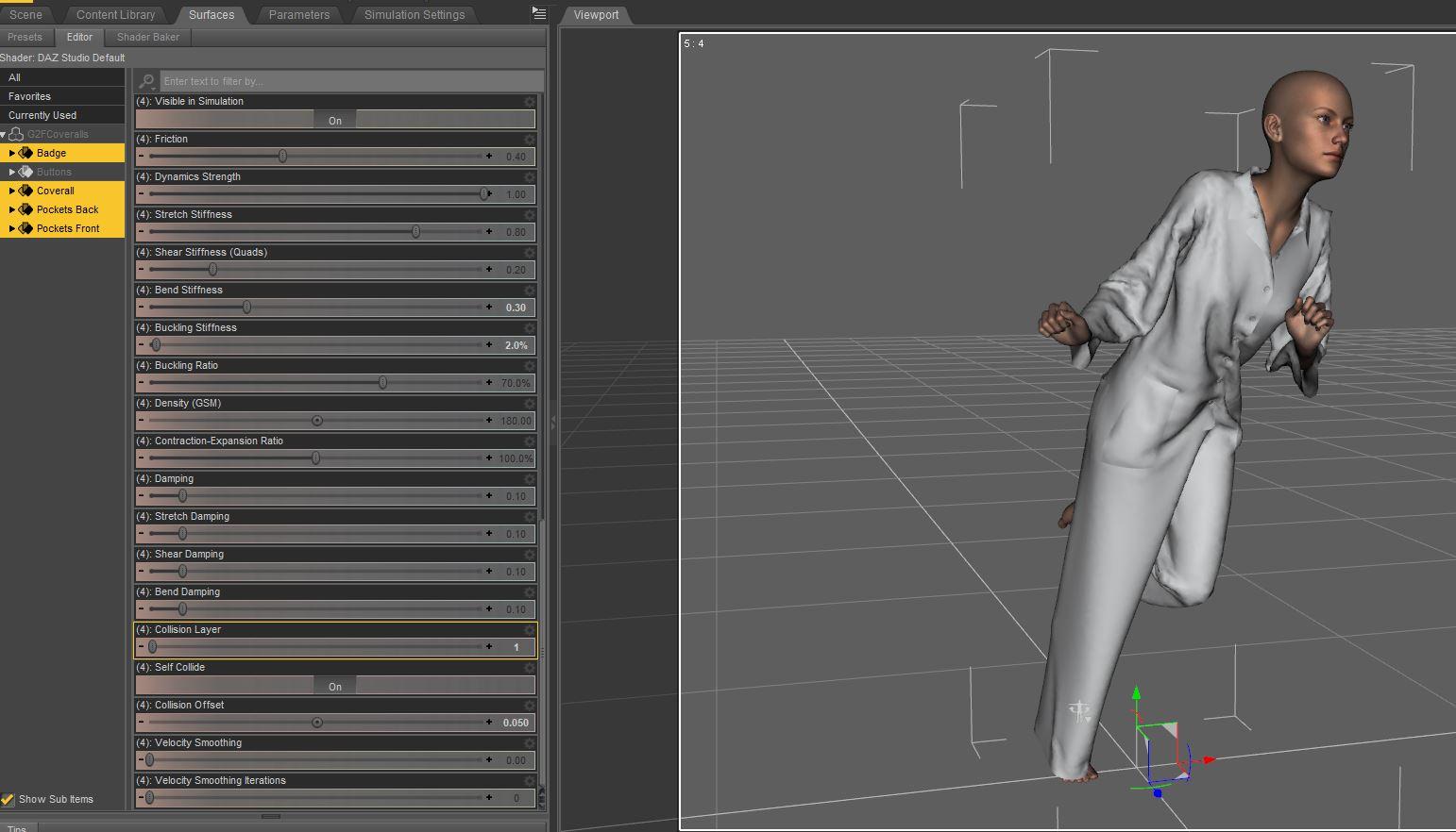

    I attempted to do a systematic study of what settings contributed most to "explosion" of simulated fabrics. Because there were too many complexities in off-the-shelf models, I created my own which included just one potential trouble spot -- a plane with an added toroid which introduced a non-planar topology. (See attachment 1.) As more or less expected, it exploded when I tried to drape it over a genesis figure. To my surprise, however, the problems didn't end up being primarily due to self-collision or the odd topology. I was able to eliminate the problem with various combinations of setting changes:
    1. Simply setting the "bend stiffness" to .25 instead of .5 was, in itself, sufficient to fix the problem. (See attachment 2. The simulation is plausible, but the "donut" section completely collapses, as the fabric lacks stiffness.)
    2. Setting "buckling stiffness" to its minimum was enough to almost fix the problem. (It didn't blow up until the last moment.) Adding in decreases to either stretch stiffness or shear stiffness was enough to make it behave properly.
    3. Setting "dynamics strength" to 90 was enough to keep it from exploding, but also limited the amout of draping. Combinining this reduction with a figure that already has morphs might provide a good hybrid approach for some situations.
    4. Finally I went back to zbrush and actually changed the geometry of the model.Retopologizing so that it had only quads instead of a mix of quads and triangles seemed to be all that was needed. The model simulated smoothly and easily. (See attachment 3. The draping is more interesting and the shape of the donut doesn't get completely lost.)
    5. "Decimated" versions (triangle-based) of the original model exploded in the same way as the original. Decimated versions of the retopologized version didn't explode, though the simulation wasn't as pretty, due to reduced polygon count.
    Summary:
    1. Clean topology matters. It's probably necessary to have non-intersecting "watertight" meshes, but it's not sufficient.
    2. If you have no control over the topology, try simply tweaking the bend stiffness. That may be all you need to change.

  • BeeMKayBeeMKay Posts: 7,019
    edited November 2017
    Hi mephoria,
    thank you so much for your experimentations, and even more so for sharing your results! heart
    I finally able to properly drape a body suit that had been exploding on me for a good  while.  smiley Now, I just need to figure out how to make the buttons play along...
